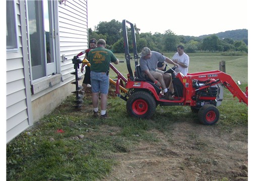

Finally used the PHD and what a tool. I dug 19 holes in apx. 90 mins. Granted I had some help from the neighbors. The testosterone was at very high levels in my yard today. I think they were as excited as I was. The 12" auger didn't phase the old bx-22 at all. I probably broke 4 shear bolts total, and three were more my fault than anything. (Too much too fast). All in all the tractor supply/speeco PHD gets an "A".

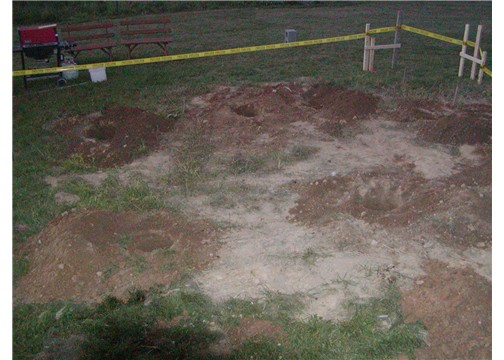

   / Post Hole Digger - BX-22
#12
The final results.
   / Post Hole Digger - BX-22 #13
hi Joe
Looks like the hard part of the deck is done. Since TSC had the Speeco PHD on sale last week I picked one up for my 2210, haven't used it much but fits the 2210 fine too. For 300 bucks it seems like a pretty well made PHD, I'm sure some of the more expensive ones are probable a lot heavier duty, but for the small tractors it seems like a pretty good deal. It will probably be a few more weeks before I start on the deck and get to give it a good try, but I did drill a couple holes just to try it and was surprised that at idle it just sunk em right in, thought it would talk a bit more power then that,
later
Phil
   / Post Hole Digger - BX-22 #14
Joe,
Used a post hole digger myself for the first time this summer. Like you [I assume... /forums/images/graemlins/smile.gif ] I was simply grinnin' ear to ear knowing how hard it would have been to do that work by hand... /forums/images/graemlins/cool.gif
When I looked at that picture of the guys by the auger...I could not help but hope they were not that close when it was in operation!
Lot of torque there at the pto shaft and more at the auger...as you know...
Glad to see you are getting good use out of the bx. Tractors are wonderful tools, arn't they? Don't know how I did without one for so long...
#17
Bill,
I certainly did have one large smile. As for the safety tip of the guys standing near the PHD they were eye-balling the plum of the bit for me and lining me up with my marks. When the bx got humming they were well out of the way. This machine is a life saver for sure.
Joe
