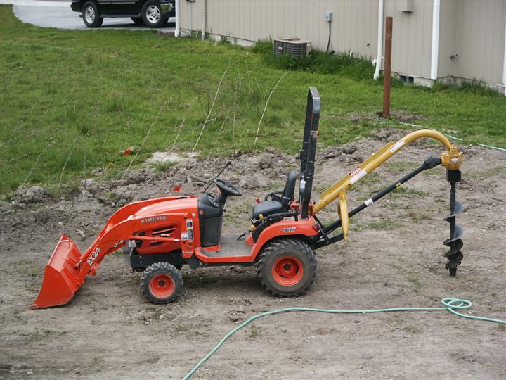

I have a land pride PD10 for ny BX it is made specifically for sub cuts. It works fine in soft ground but to get it to dig in the hard stuff i had to buy carbide tips. I still have to but weight on it to get it to dig in hard clay and it will not dig clitche at all.

I've dug about 30 holes in medium hard material with the digger in the picture without any problems. It is a Rankin 600 which is a Shaver 601.

The key is making sure you get a PHD that will work with your BX.
MY Rhino HPHD won't. It would hardly fit my B2910.
Without question the BX will power a PHD IF...IF...you get one that fits the limited size cat 1 3PH.
Fact of life...the BX 3PH is a bit smaller than standard. OR...all the other Cat 1 3PHs are larger than standard... /forums/images/graemlins/shocked.gif

Ultrarunner has said that the Land Pride unit (with downpressure) on his BX23 digs through caliche and serpantine with no difficulty.
