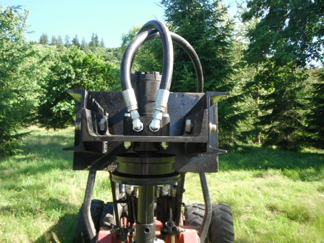

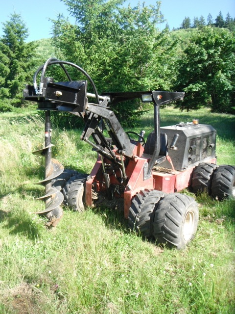

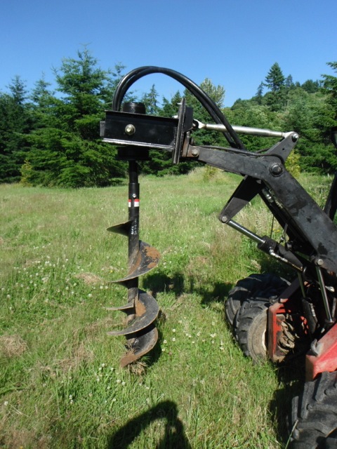

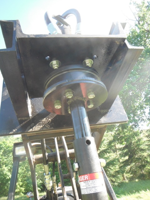

Eyup. Around $1000 all in which was double my budget. I should have thought through it when budgeting. Thought I would get used stuff but in the end had to buy all new and hoses are not cheap.
I have 18GPM at 3000PSI so the wheel motor I have is a bruiser. Surplus Center wheel motor with hub. Had all the steel cut for me at the yard but the price for cutting was negligable.

Is there a standard attachment size to post hole augers like a 2" round shaft with shear bolts, hex shaft and pin or does each manufacturers have their own configuration and connection?
Thanks
Steve
   / Post hole digger for FEL #27
I used round as I could not find a hex tube but the high end hydraulic used hex. I was told because of the high torque. I do not have any rocks or other obstructions so I have not had a sheering issue yet.
