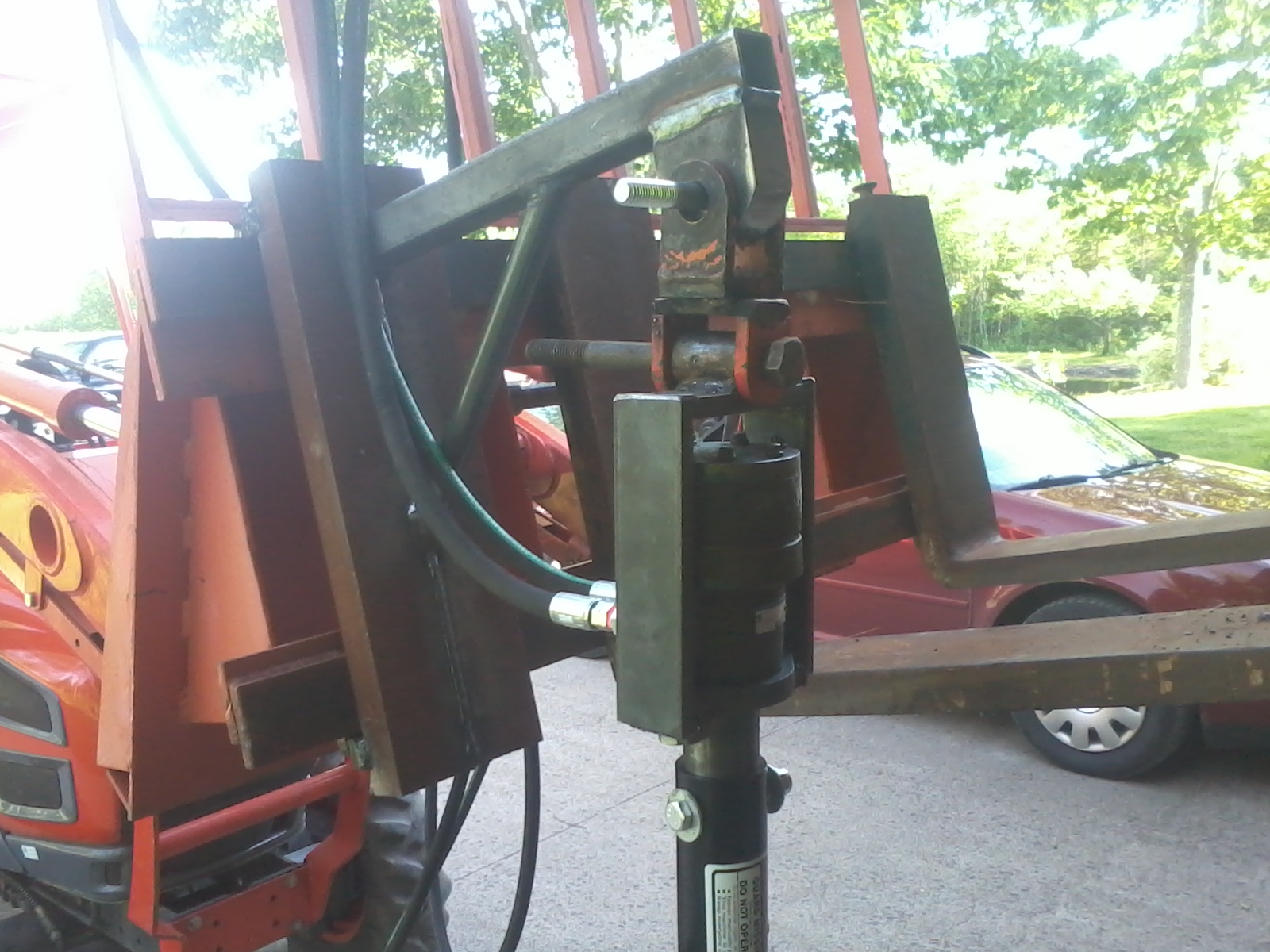

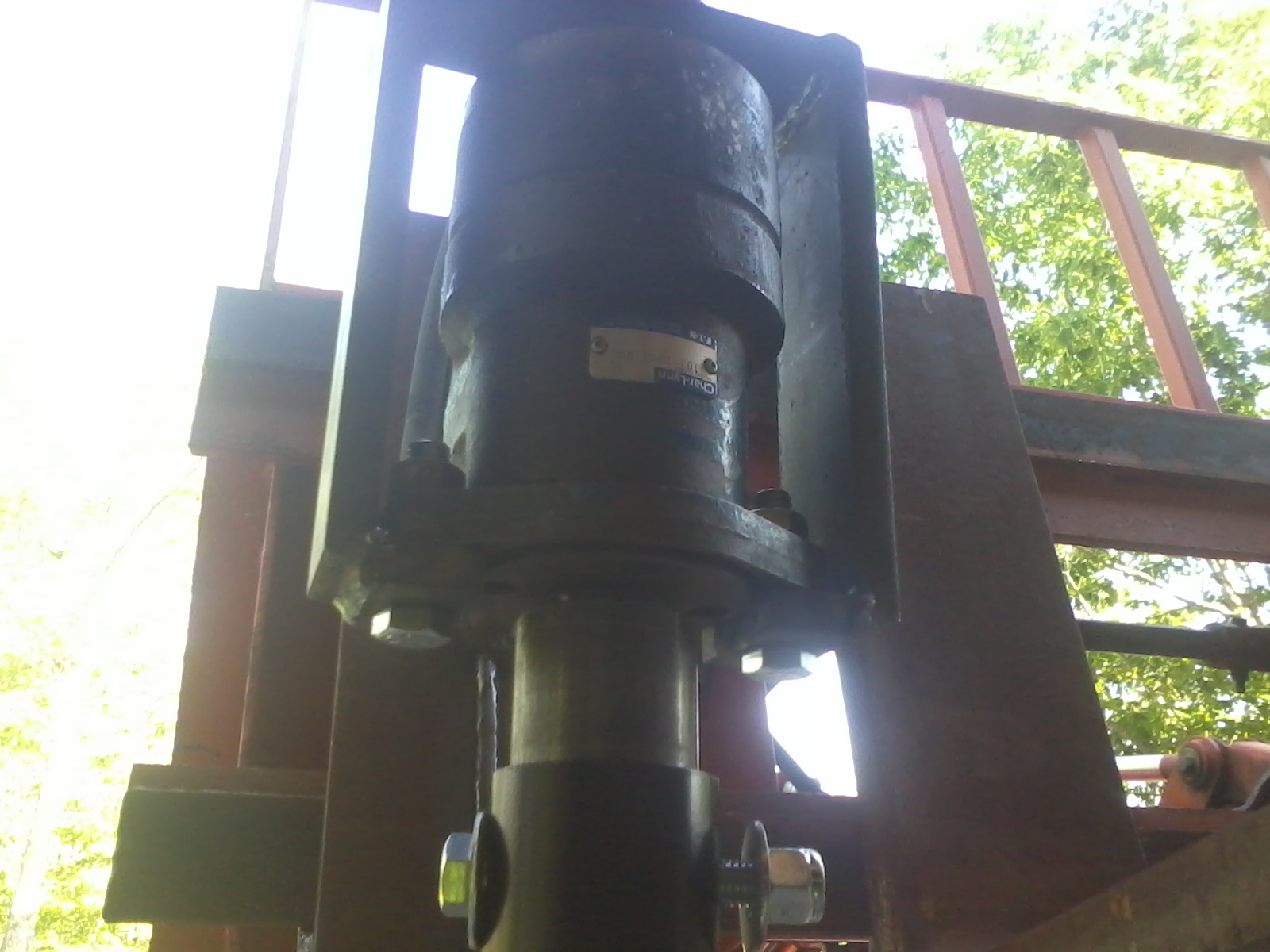

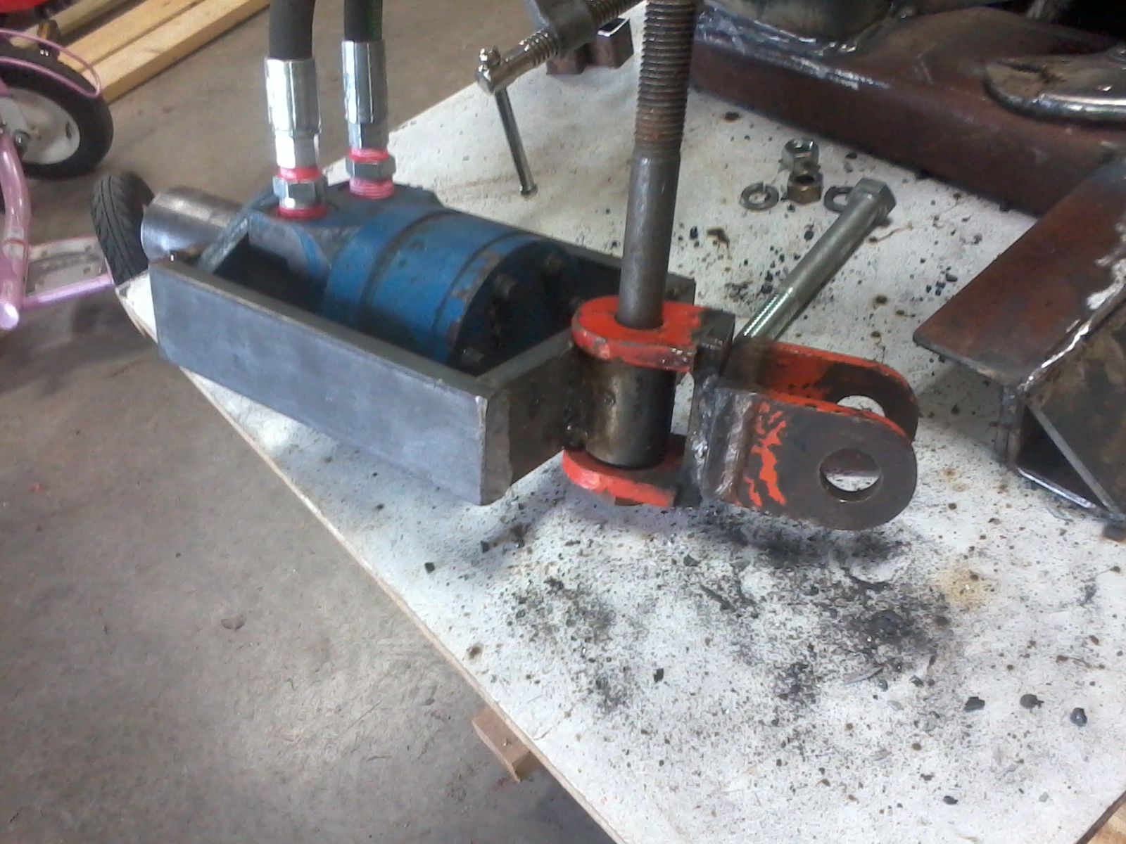

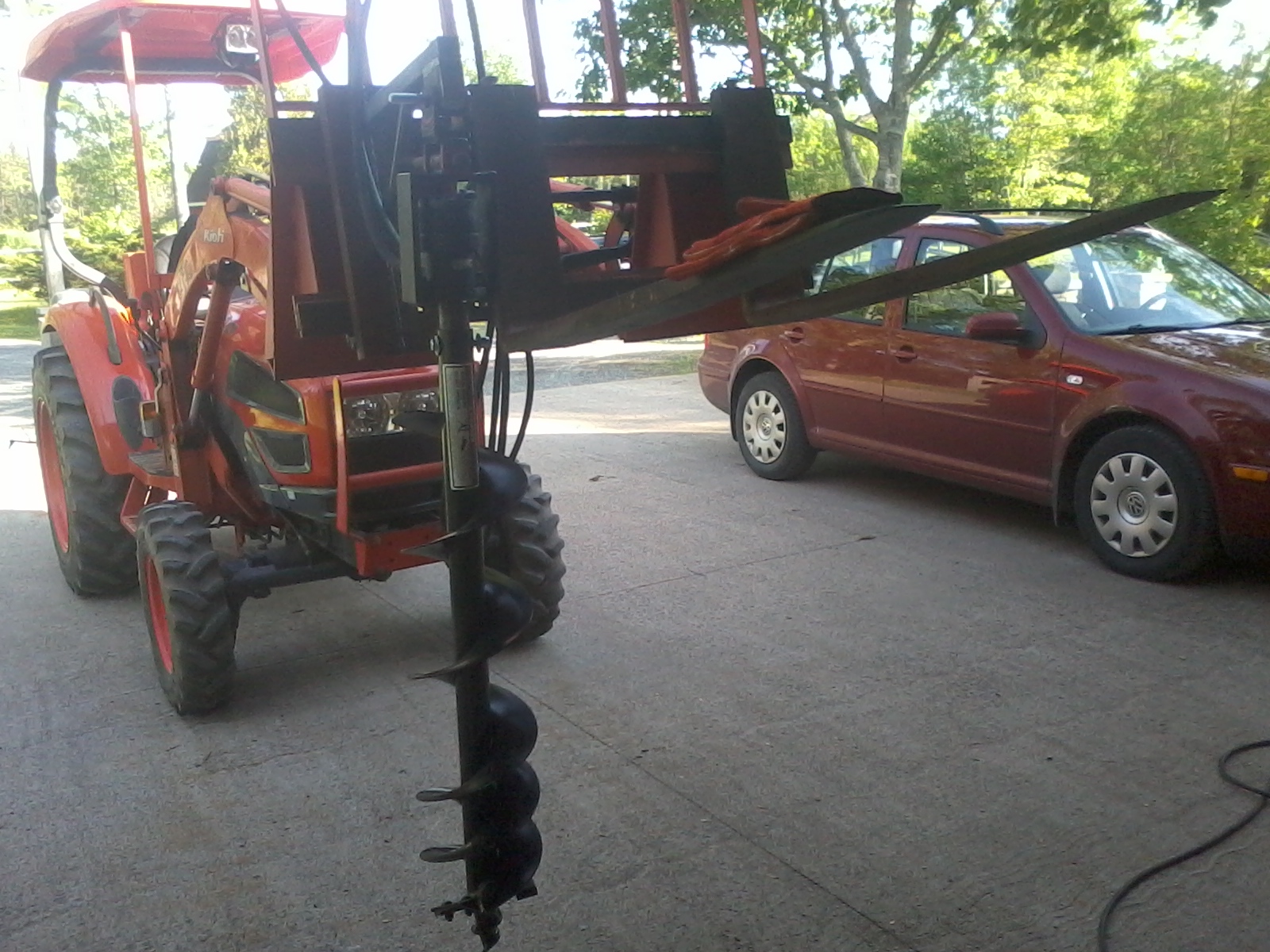

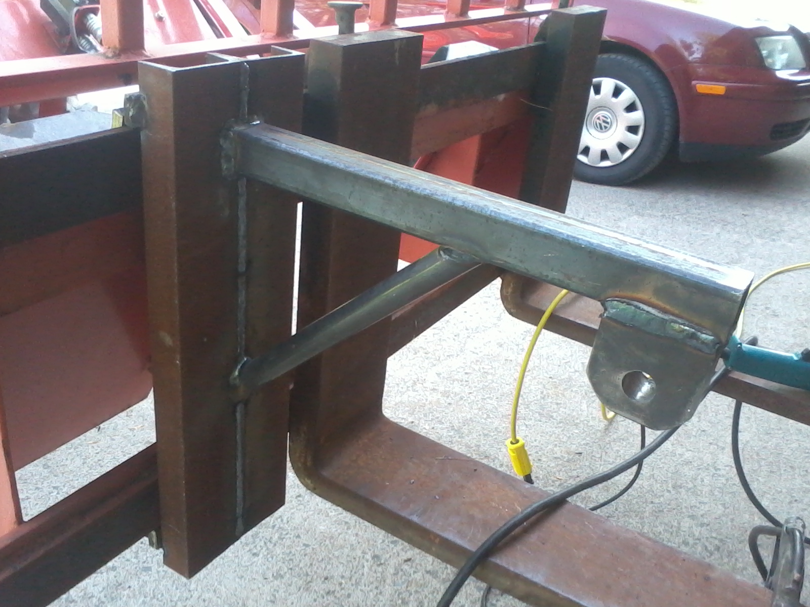

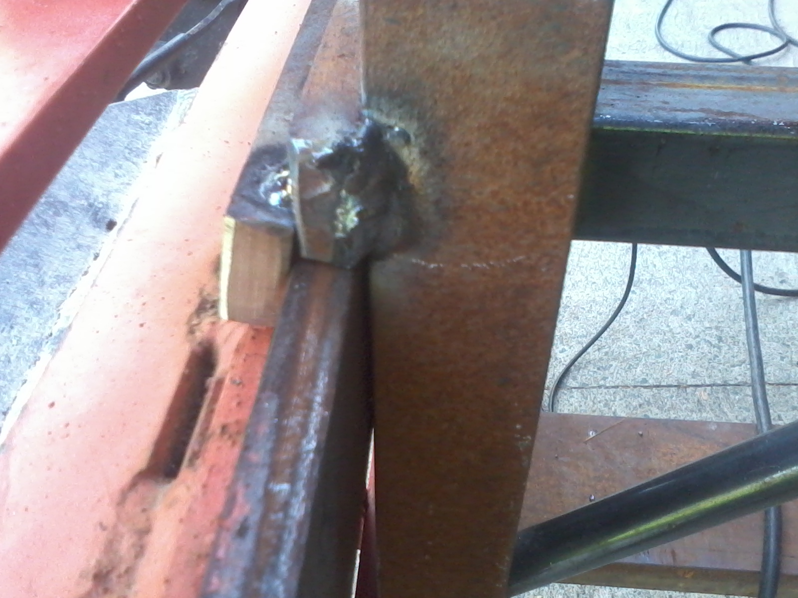

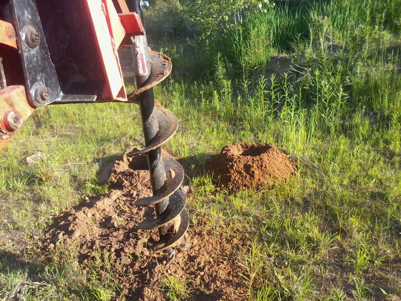

Went for it, finally made some time for this project. Just welded the rest of it up tonight and slapped her on the tractor for a test run.
1: Mount slides on beside the forks
2:Close up of the slider
3:pivots and sub frame
4:Hanging in place for the first time
5:With auger attached
6:Close up of the motor
7:A couple of holes later
Steve

   / Post hole digger for FEL #35
Looks really nice! Good job!
Looks real simular to my build.
Only I used a truck yoke and u-joint off a drive shaft for my pivot point.

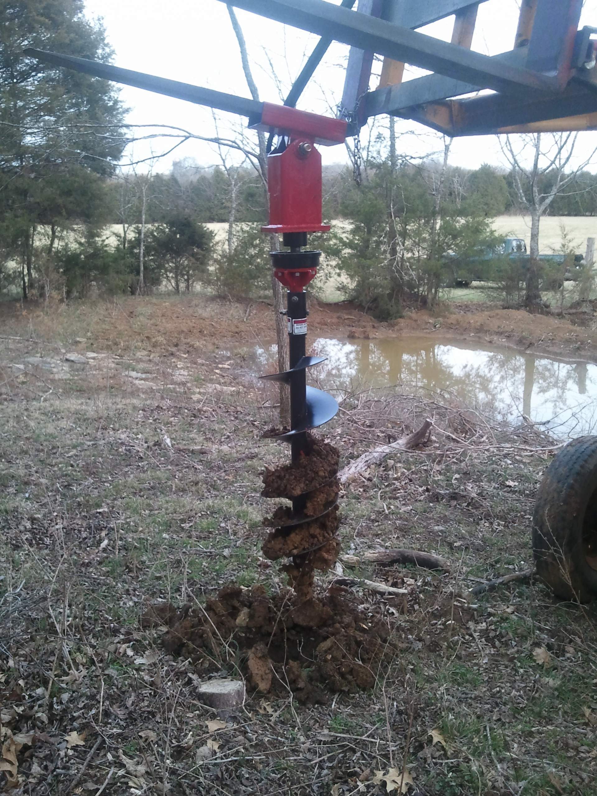

Here you go guys, I built my hydraulic auger last year. Here is what I came up with, quite proud of it actually:D.
This is using a 12 inch auger direct drive wheel motor powered from the loader power beyond through single spool valve. I mounted it on one pallet fork with a chain holding it in place. The chain in this picture was too small and broke right away. I replaced the light chain with a log chain and quick link attach and no problems since then.
I have stood the tractor up on the bit (front wheels off the ground) on top of rocks/hard dirt, pulled the back wheels off the ground when trying to pull up roots and rocks, and so far,,,, no damage. Sure glad it has a reverse!! Notice the stump right beside this hole. This thing has cut through some pretty heavy roots. :thumbsup:

Thumbs. Ans we have more or less the same design, could you get a close up of the attachment plate Thant goes to the wheel hub. Mine was just a pipe welded on. Clearly you did something better.
   / Post hole digger for FEL #39
If you click on the picture you can also zoom it up to get a closer look at the hub. I used a short 2" solid steel rod with gussets welded to a 1/2 plate for the hub attachment. You just have to be sure there is no run-out when it is put together so there is no wobble to the bit when it is turning. Your attachment to the hub looks like it should work fine. Mine may be a little overkill:D
The attachment to the fork is what I consider the best feature of this design. Being able to put the auger on and off easily by myself and,, being able to store it when not in use was a big consideration in my design. I can slide the rectangular tube off the tractor fork and onto a channel iron bracket mounted to a post/tree without lifting anything by hand to change it out.:thumbsup:
