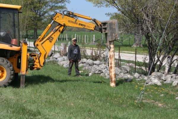

You may want to hire out the post driving. I recently had over 300 cedar posts with 7"-10" tops pounded into my very very rocky pasture. This covered a distance of 200 rod. Unless the post was resting directly on a large rock the posts went in 3 to 4 feet in less then 20 hits. I don't think it was worth me installing the posts myself. Here's what they used.

Those are serious rocks... and a serious post being driven... no question... a PHD wouldn't be able to handle those kinds of rocks, even if hitting one at an angle, regardless of the type of bit it has.
I think you made a wise choice to hire them pounded in!
