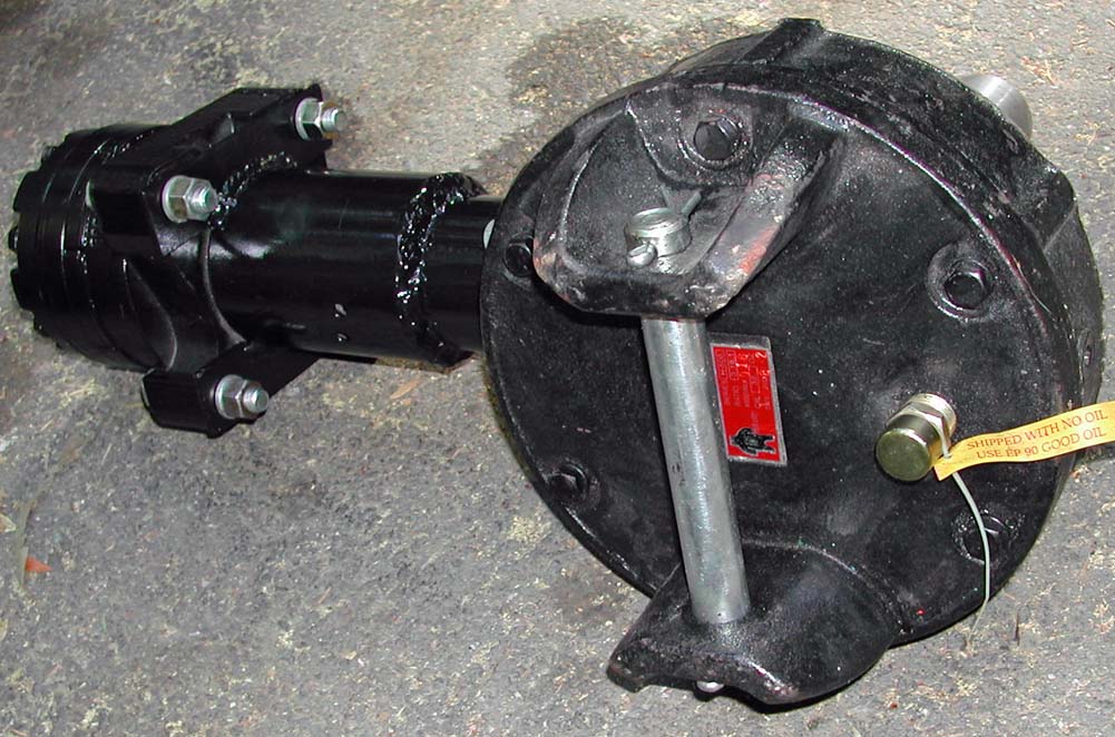

I borrowed the smallest bobcat hydraulic post hole digger from my brother. Having used only a hydraulic one, and reading about 3 pt hitch diggers, I will save up and buy my own hydraulic.
I only have 8gpm on my 30hp CUT, but I don't think I ever used it at full speed output of my rear remote (I ran long flex hoses from the rear remote to the front loader mount).
I imagine torque is going to come from PSI, and speed from GPM.
I'm not drilling holes for a living and paid by the hour, and if I was I would actually buy a Skid Steer with 20 GPM to power it. Since I'm not, my 8 GPM CUT is just fine.
I ran it slower because the tractor took a bit of moving around as I drilled to keep the hole plumb. If using it with a tractors front loader, consider going up a size in auger to make it a lot easier to deal with the not straight up/down movement of the auger.

^^^^ In hind sight I think I would have gone with a hydraulic. Found models that will suit my needs for less than $2,000 while I paid top dollar, $1500, for the 90hp PTO driven unit. Being able to reverse rotation and working facing forward seems to justify a few hundred more dollars. Live and learn I say.
   / Post hole digger: PTO vs. hyd. SSQA #14
hydraulic PHD more than likely = some sort of FEL mount or backhoe mount. that alone = better down pressure. and digging in hard ground.

In addition to reverse and downforce, the hydraulic will give you more flexibility in depth (say you want a really deep pole barn base), since you can buy auger extensions. The 3PH auger is a lot more limited in how high it can lift the auger, so there isn't much room for extension of the bit.
Hydraulic auger visibility is an issue for me in my Kioti DK45; I can't quite see where the auger bit hits the ground. The offset option would likely fix this, but I'm planning on putting a magnetic camera on the lift arms to keep a better eye on targeting (and on keeping the bit aimed straight down, too).

Soil type can be a defining factor. Most people that have tried to auger a hole in hard dry soil, clay , around roots , stones etc. they will choose a loader mounted hydraulic unit over a pto unit.
   / Post hole digger: PTO vs. hyd. SSQA #17
Our ground is about 6 to 10 inches of loose soil over rock and clay. I have the Danuser EP6 and my only complaint is I'd like more torque. I would probably go with the EP10 if starting over, but wouldn't even consider a PTO unit based on our ground conditions. The offset mount provides adequate sight to the auger. Tractor is about 9 gpm at 2400 psi. Turns out that I don't really care about RPM.
If thinking about a hydraulic unit and have questions, don't hesitate to talk to Danuser. They have great customer service.
   / Post hole digger: PTO vs. hyd. SSQA #18
Agree with this, big-time. I've run fence in very difficult, dry conditions with both a 3pt-mounted PHD and a rented Bobcat walk-behind machine with hydraulic downforce. If you are sinking posts in hard pan, there is no substitute for being able to add steady down force to punch in. That, or a hydraulic impact post driver that many pros use, which can be even more effective but is a whole 'nuther animal. Pouring a bucket of water in the hole and having a brave 200-lb buddy stand on the lower link arms with a 3pt auger helps, but doesn't add much in really tough soil. If you'll be doing much of this, and an additional $1000 is really all it would take to go with a loader-mounted hydraulic, that sounds good to me.
   / Post hole digger: PTO vs. hyd. SSQA #19
We have heavy clay with rock and I have used the rear mount PTO driven type for years with a 12" auger with so-so results. It works, but shear bolt replacement is required very frequently. I carry at least 4 in my tool box. I made the switch to the Danuser EP 10 with a 9" auger this year as they recommended it for the torque over speed with my MX5100. I went with the offset mount and use the 3rd function remote. It works, but you have to be patient if you have rocky soil. I am using the rock and dirt auger. A caveat here is to be careful if you have embedded, large rocks in heavy clay soil. You can bend the auger mount as well as the QA unit if you try to pull the auger up without reversing it first which will require replacement of both pieces unless you have access to a press that will straighten the auger mount.
