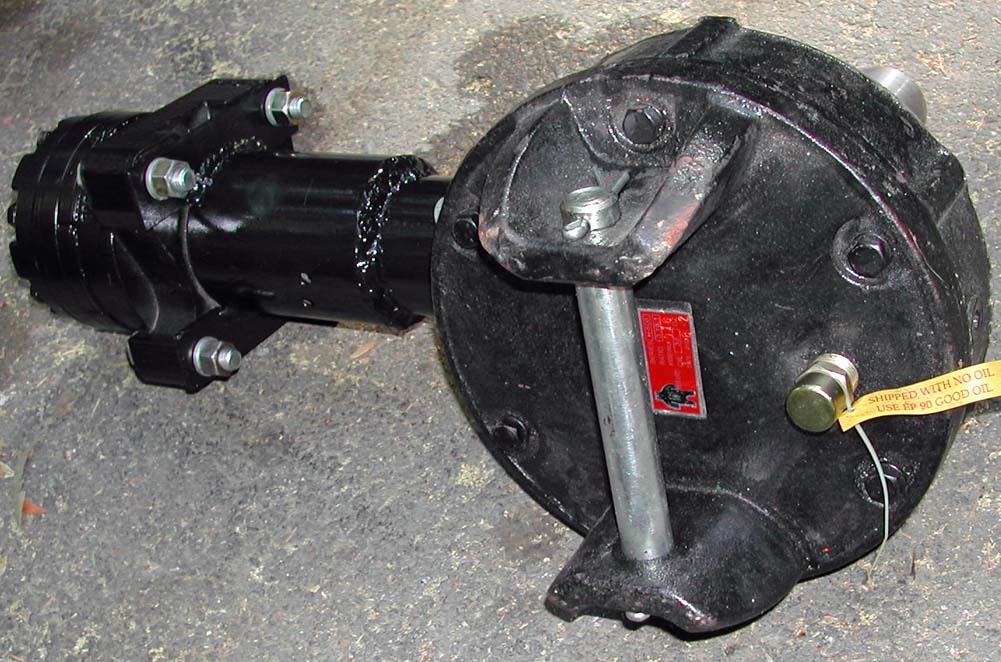

Could you give us a list of the parts and a pic of yours?
This is mine.
First, get a used PTO PHD, then replace the driveshaft with an hyd motor. What you need is
a large-displacement motor to get the low-speed high-torque you want. I used a White
motor with 7 cubic inch displacement that can handle the 2500psi that most modern CUTs
put out. That way, you do not need a crossover relief valve.
You need to fabricate the motor-to-gearbox coupler. I hung mine from my backhoe and
used the curl circuit for hyd power.
Do a search on TBN to find several hyd PHD builds.
