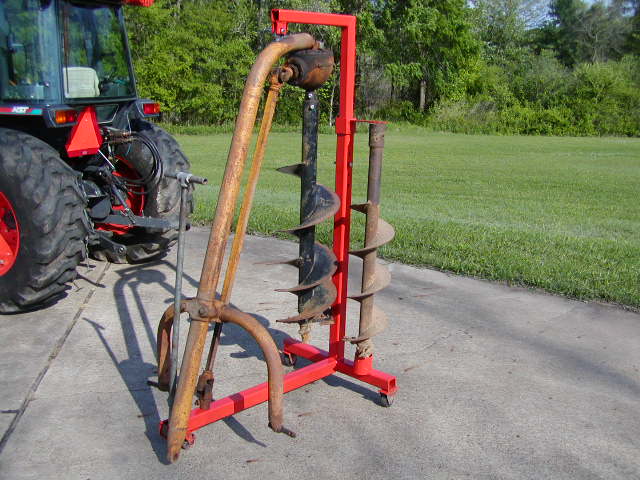

AlanB said:
Has anyone made, or seen, or have a photograph, of a stand for a standard type post hole digger that holds it in position to hook up too the tractor?
my stand
/ Post hole digger stand #27
ns,I have the exact digger you have but can't identify it.Do you know who makes it?I bent the curved pipe bottom piece into a pretzel and need to buy a new one. Thanks.
/ Post hole digger stand #29
I just looked & did not find the paperwork on it. Will look for indentifying info on it when I am out where it is stored.
We purchased it in 1972, along with a new Little Rhino blade & used David Brown 770 tractor. I found paper work on them, but not the post hole digger.

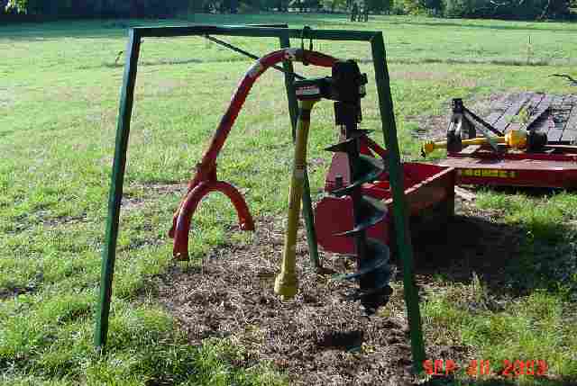

Being an organic kind of guy...I let my PHD stand grow by itself...less effort than building one...:)
/ Post hole digger stand #32
Hi Bones1,
My digger is a Servis Brand, Model GSD, I bought it new, I think in 1972.
/ Post hole digger stand #33
Hey Bill, you stole my patent.;) That stand looks just like mine.:D
...and the holder for your beer ain't bad either.:rolleyes:
