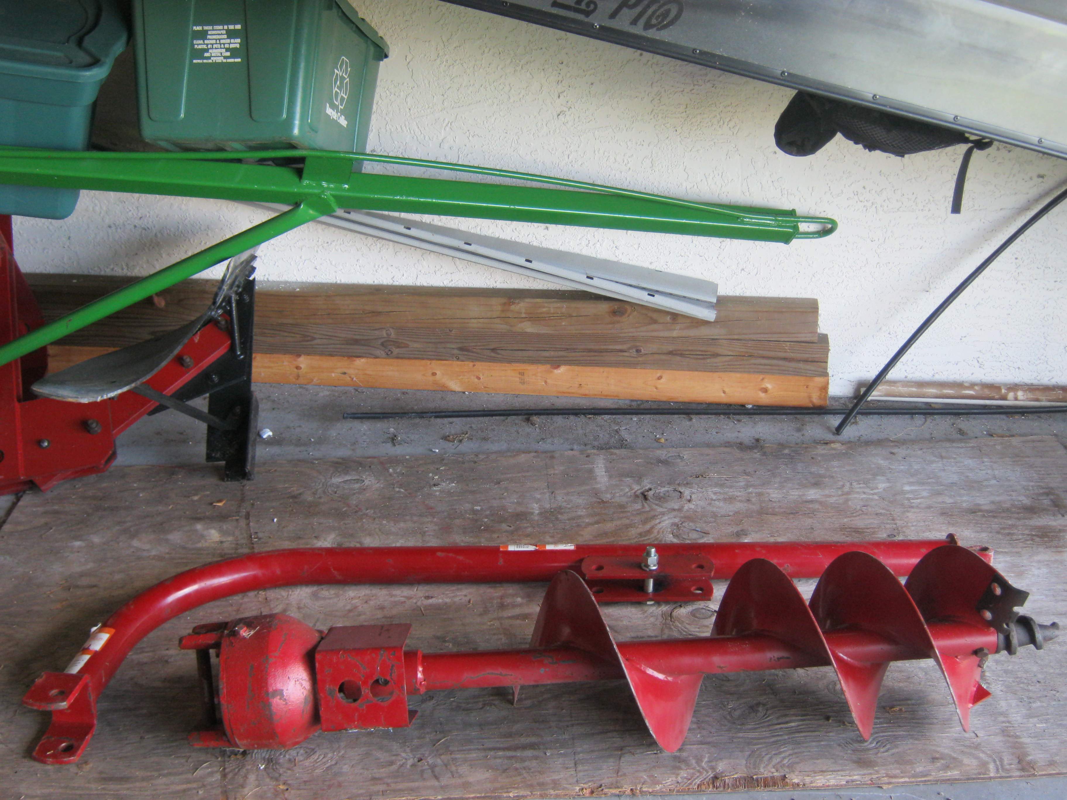

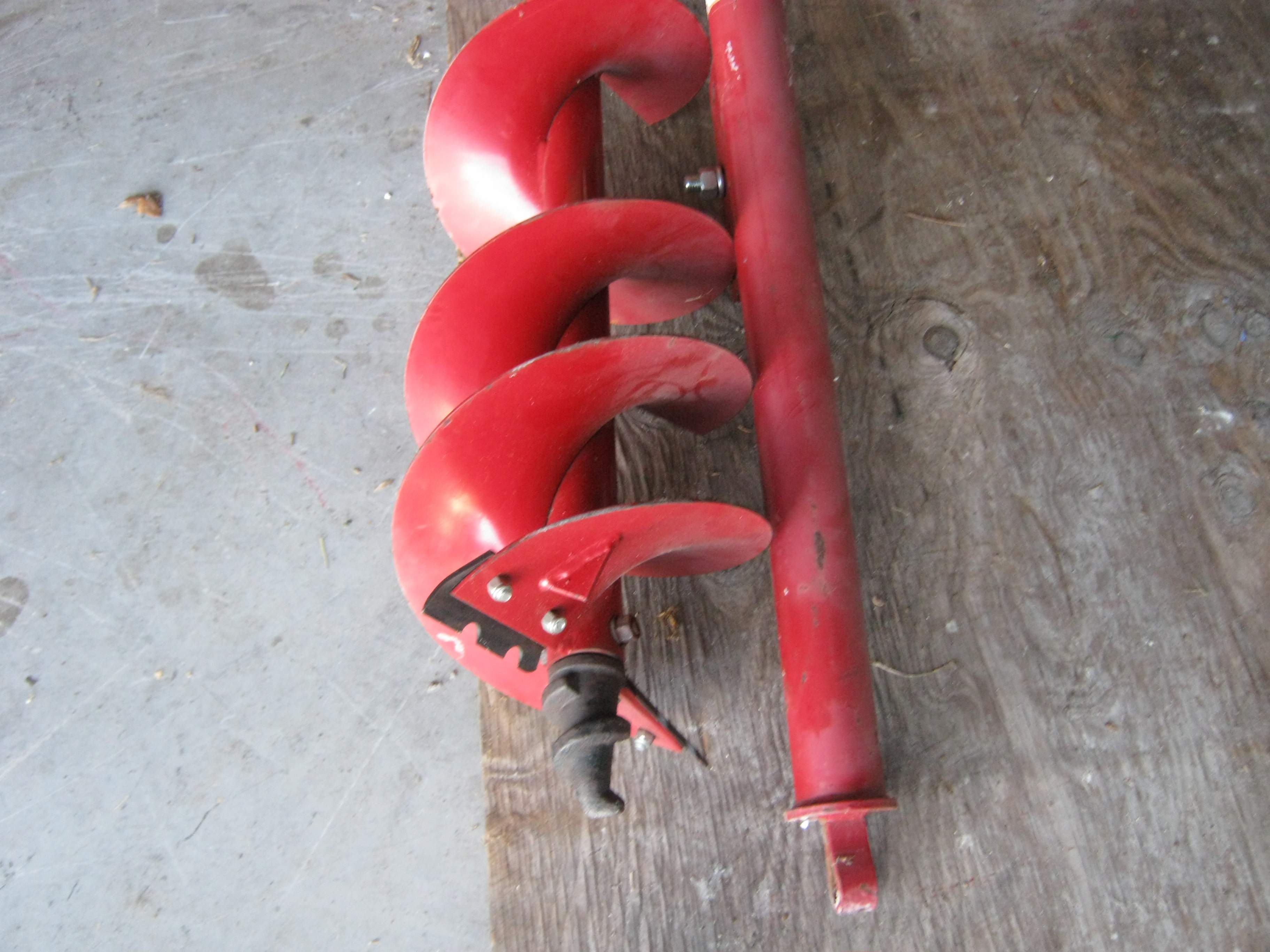

for now, i just pull 2 pins and then 2 bolts that hold the gear box onto the frame. which drops the PTO shaft, gear box, and auger bit. (gear box is the heavist) splitting them up i can man handle them and just lay them down on a couple pallets. but i really need to get a chain hoist and toss attach it to a beam in the shed. so i can just backup, hook up chain, undo hitch, and let it hang.
pending on how i am feeling / worn out, i may go as far as undo bolt were pto shaft hooks up to gear box, and then undo the shear bolt / pin that holds the auger bit to the gear box. to make things more lighter to move around. ya it takes a few more minutes to undo a couple bolts / pins. but not about to kill myself either. or need to take pain meds after moving it.

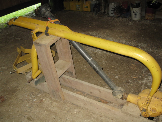

I built a stand for mine out of 2x6s. I built it with the PHD in place. Now all I have to do is back the tractor into the boom, connect the top link and lift arm pins and I'm set. I have an F8 Danuser that weighs a ton. With the stand I can attach it myself. Oh, I always remove the auger or this deal wouldn't work.

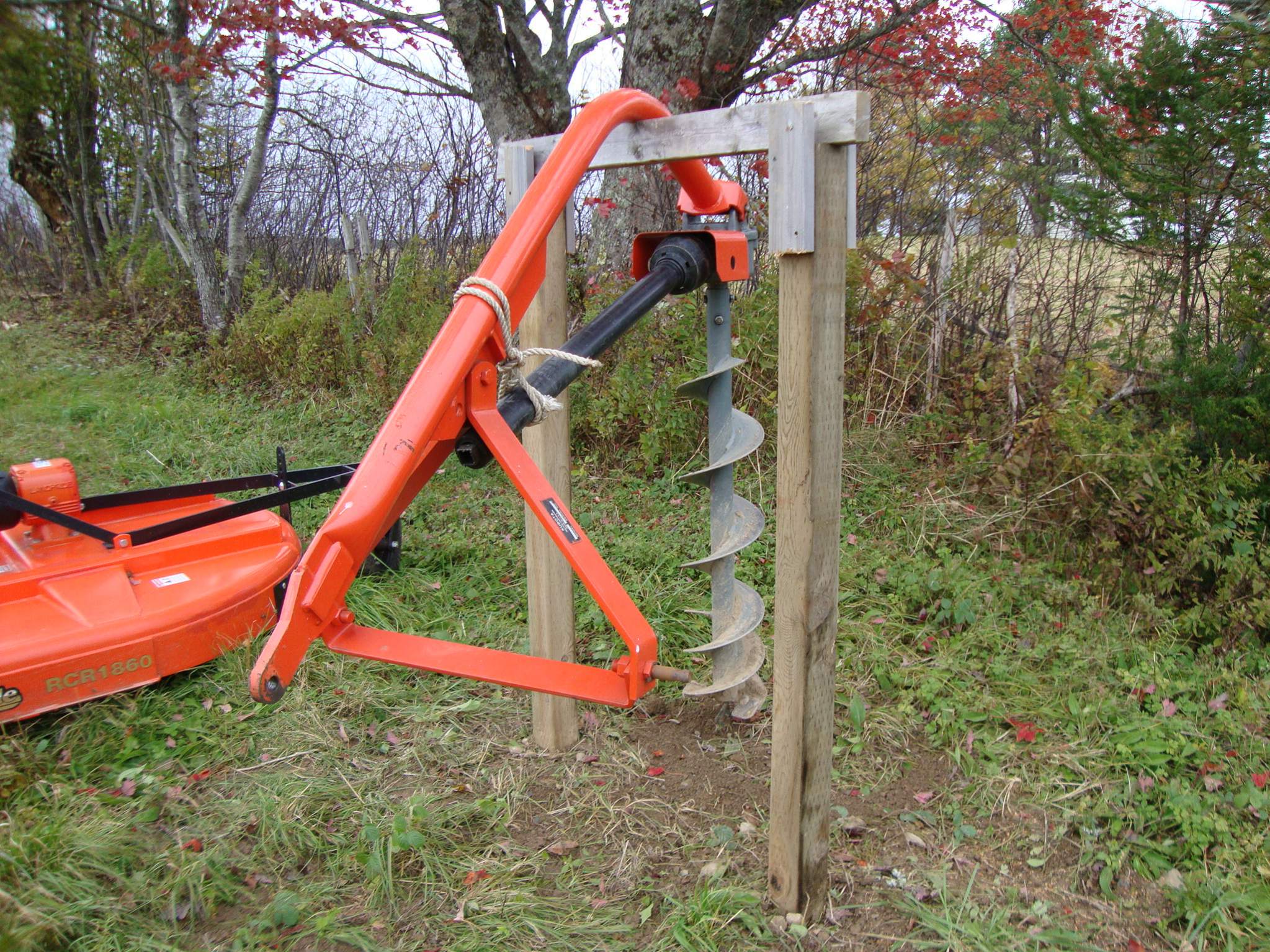

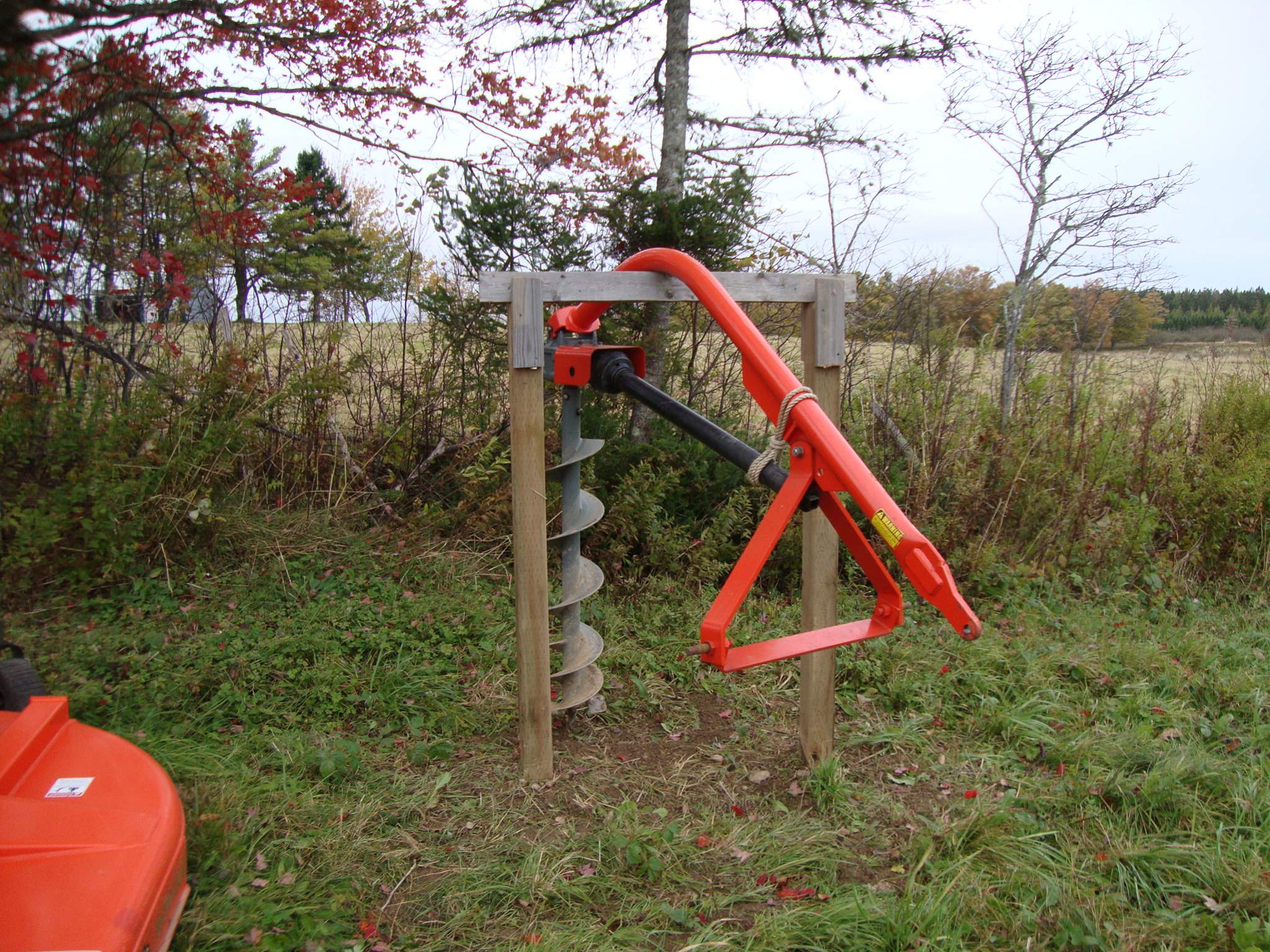

Easily the most ignorant implement to store and remount.. here's what I did, copied from MtnViewRanch..
You remove the crossbar, back up, replace the crossbar, lower digger and pull the pins then drive away. No wrestling! The best part is using the digger to build the stand!

It was built in place so I can back the tractor right up to it.
You remove the crossbar, back up, replace the crossbar, lower digger and pull the pins then drive away. No wrestling! The best part is using the digger to build the stand!View attachment 273157View attachment 273158
Sean
My two stand holes were the first 2 holes that I dug with my PHD. ;)
