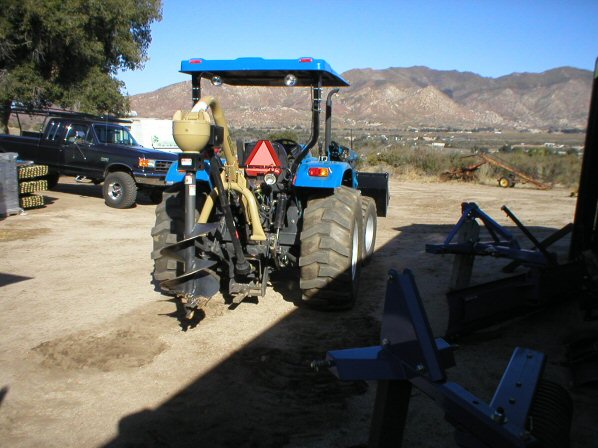

Any common 3pt PHD that will point straight down if the tractor is crossways on a grade? Most of my holes on a fence through a forest could only be approached by backing through trees, crossways to the fence running up the hill, not along the fence line.
I haven't seen any that would swing to the side, only forward and back, but I haven't looked too hard, yet.
Most are like this:
Bruce
   / Post Hole Digger #33

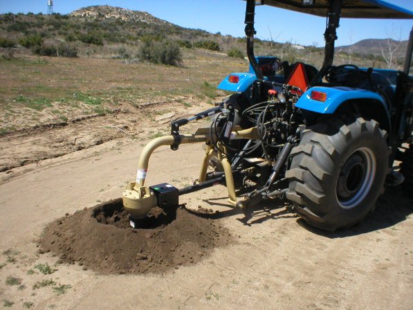

Bruce, that is what the adjustment on the 3pt side link is for. Get a hydraulic side link and your adjustments are only a finger movement away.;)

The BX doesn't have much side link adjustment range(short link, short arms), so I thought there might be a digger style with side swing.
Bruce
   / Post Hole Digger #35
Bruce
Have you tried to see how much it actually moves when it is adjusted. It should adjust enough to compensate for any side slope that you might be on. Probably shouldn't be on any ground steeper than that anyway.
Good luck

A PTO auger can not use the double hinge/pivot like a hydraulic auger has. The rotation torque of the PTO would force it to swing to the side and you would still have a crooked hole.
If you are on side hill consistently when drill, move the pin location of the side link on one of the 3 pt arms so you get more lift on one side or drop on the other and fine tune it with the adjustable link.
