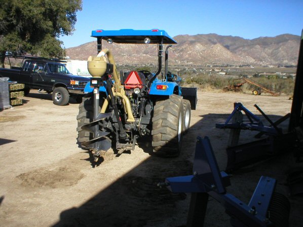

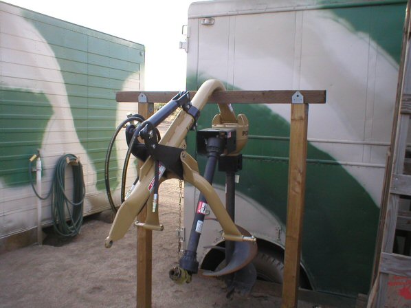

I just got a Heavy Duty SpeeCo post hole digger from Tractor Supply. Was on sale and I needed one (putting in fencing and vineyard posts).
I put it all together according to the manual/assembly instructions. Before digging the first hole, I noticed the boom had a lot of play in it. I mean about a 2 foot swing side to side. I re-read the manual looking for connections or tighter tolerances I may have missed, but everything was in place and connected up right.
I took it out in the middle of a field to do some practice holes and the play, plus the torque, continuously throws the boom to the left (left as viewed wrenching your back/neck around to the back) and makes for a tilted angled hole.
I tried this several times, slowly lowering for it to grab (clay soil), then lowering slowly and it always tilts over. I have yet to get a straight up and down hole.
I was tempted to jump out and push the boom straight while it was running, but I know a bad idea when it seems like a good one.
Anyway, so I shut everything down and took a closer look and the play is actually coming from the two 3pt lift arms. I've got both pegged in, but they're slopping around by inches, which translates to feet out at the boom.
Yes, I'm a newbie so I'm sure I've got something set wrong. Just wondering if anyone else has experienced this.
It's like it just needs some kind of top of the boom stabilizer or something, just to keep it from tilting.
/ Post Hole Digger #39
Most hitches have a way to adjust side swing with a turnbuckle or other arrangement. To remove the swing, you can adjust it so it is too tight to unhitch the implement.
If not, you can do something like the chain in this photo from:
JD 3 Point Hitch
/ Post Hole Digger #40
BCP, thanks for the link. The sun went down on me while I was messing around with this in the field, so in the morning I'll see what a night's rest and a cup of coffee can do for the situation. I'll look harder at the hitch pegs. See if I can get them adjusted as you mentioned. Then see what a chain can do.
