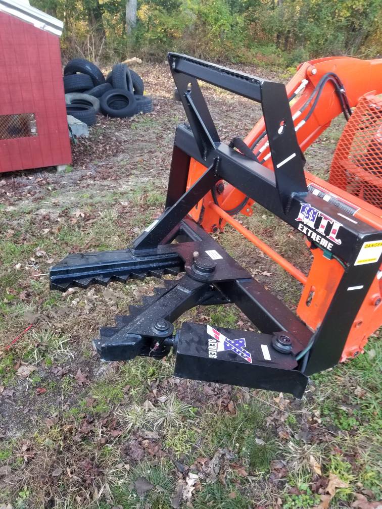

Finally got time to swap the flat face couplers that came with it to pioneer couplers. Impressively powerful grip force from the teeth, the first tree I grabbed was a maybe 3 inch sweet gum and it simply sheared off below the jaws. The movement is very controllable, I would almost say slow but need more time running it to see. Very impressed and glad to have spent the money. 20201105_154109.jpg

My first thought on seeing that was how much more useful it would be if it could be rotated so the jaws were vertical.

If I dump the curl cylinder the jaws do go vertical. I imagine that will be used to pull things behind the tractor as it travels in reverse.

Could possibly bend the curl cylinder rods with that position and dragging momentum if not careful. Bigger stuff grab underneath with the puller curled back.

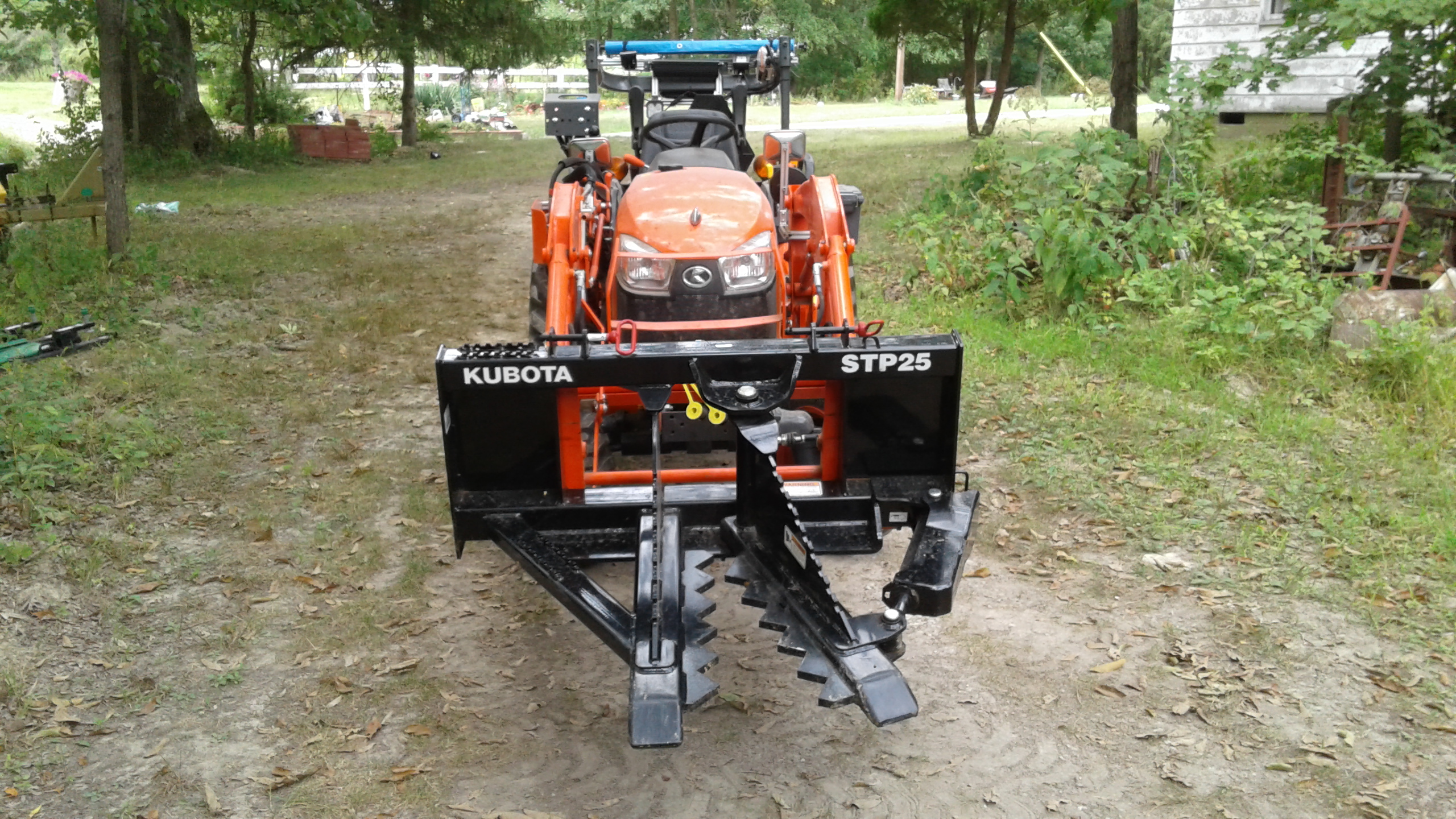

Looking forward to see how it works for you. I also had a top push bar on my STP25, and I put white electical tape on the side of the fixed jaw so I can line it up and know exactly where to aim it. I found that going into it about a foot or so above ground with the puller tipped down slightly gave me the best chance at more curl force and it also puts the bar against the tree to push more from the top to get more leverage to rip the roots.
I use the hood release/ornament on my B2650 as my position guide. If the lift cylinders can't pull it, driving forward or rocking tractor while pulling works - to a limit, it's just a "B".
