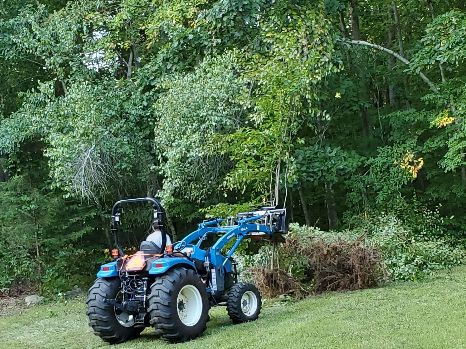

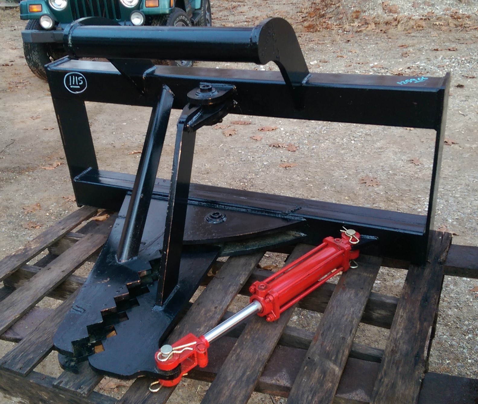

We have a post / tree puller & it is a very useful tool but as JJP8182 said "within the limits of what my tractor can do". Ours is definitely a light duty one (I purchased it that way purposely for our use) as our tractor is not designed to handle the abuse the heavy duty units could easily cause. I also wanted the lightest weight unit I could find as not to limit the FEL's capacity & for our purpose I didn't need or want a big heavy or expensive unit; for one we would never get our moneys worth our of let say a danuser intimidator which is an great unit but way to much for our machine.
So now that we have one, I wouldn't want to be without one even with our limitations due to the tractor / FEL. You need to work within your tractors limits or you will break something (I don't see posts being an issue... trees = yes). Again ours is light duty & will still crush / cut through stuff & stress the tractor if you are not using common sense; ours weighs only a little over 300lb (which helps with the FEL limits. Oh, & I got a great deal on it new for under $350 at an auction...
I did purchase a Titan 3 Point to Universal Quick Tach Adapter to be able to use the post / tree puller & a couple other attachments on the 3PT, but haven't tried it yet with the puller yet...

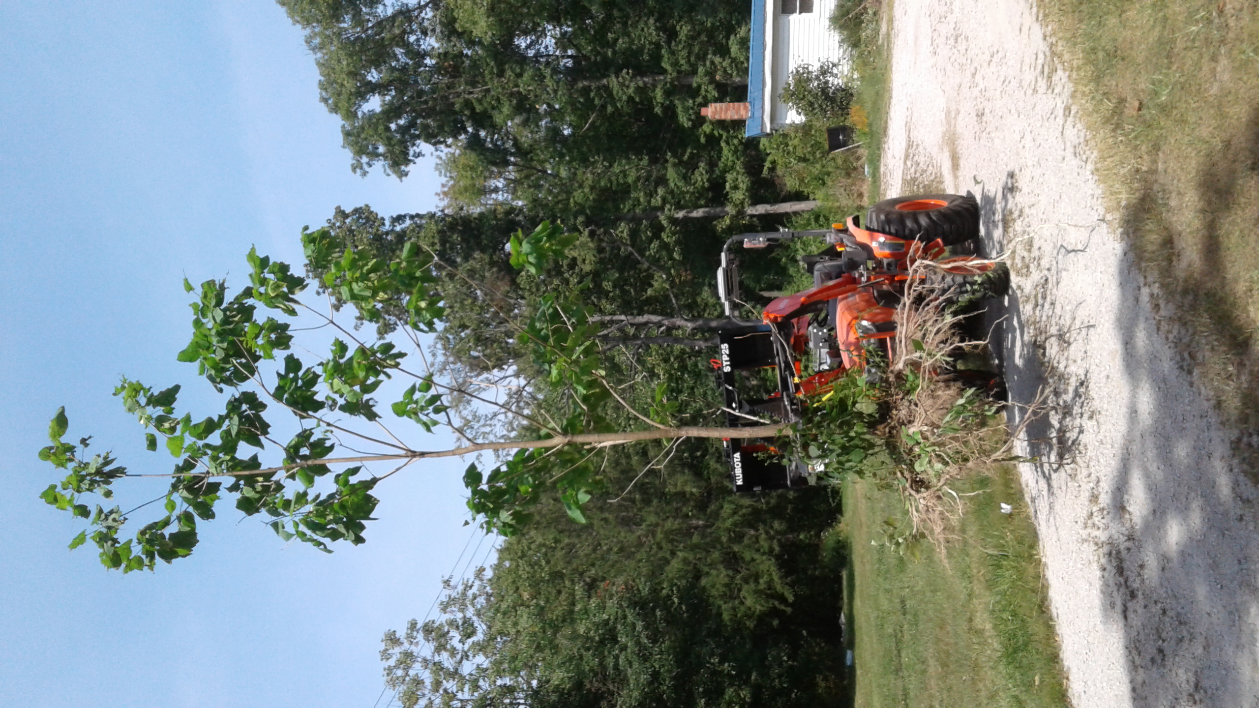

I bought a MTL post/tree puller this spring and it works as good as I hoped it would. I've used it on a Kubota L3600 or a M7050 and pulled a hundred or so assorted wood and tee posts without any trouble.

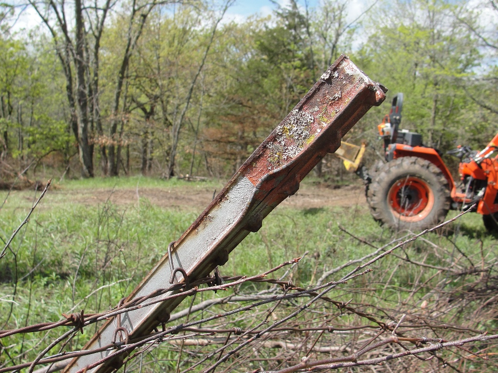

I'm in the process of removing old rusty woven/barbed wire fences. I just go down the fence pulling up each post with the wire still attached, cutting the wire every hundred feet or so. Then I roll the whole mess up into a roll, then haul each roll to the scrap pile.
Some bigger posts have to be rocked back and forth a little to get them to break loose. The puller also has enough force to crush the posts if you don't watch it. I've also pulled up smaller trees and bushes with it but prefer to just saw them off at the ground so I don't have to fill up the hole where the roots came out. I still have hundreds more posts to pull as I get the time and the weather permits.
Another thing I use it for is to remove smaller trees, as long as they're not too big, growing in the fence or on the opposite side of the fence. I can grab the tree above the fence, saw the tree off below the puller, then move the whole tree away from the fence to the brush pile. I've only used the bigger/ heavier M7060 to remove trees that way. Some were up to 4"-6" in diameter and up to 20' tall. Trees any bigger may be too much to handle safely so I haven't pushed it to find out.
The FEL mounted MTL hydraulic post puller works like a champ. I'm a one man show and it has saved me a lot of time and a ton of labor.
