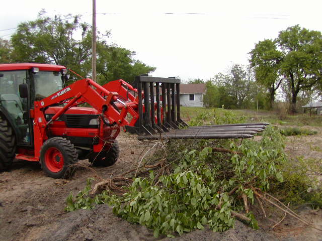

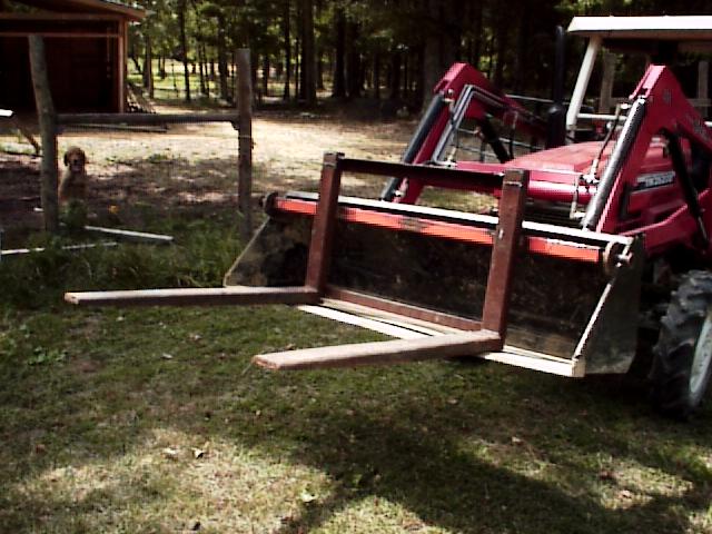

   / POST YOUR PICTURES OF FORKS? #64
Hi,
Nice design! I need a brush rake and was thinking of modifying what you have done by using 1/2 x 3" up on edge instead of the 2x2's that you have. Also space the "tines" about 8 or 10 inches apart and have at least 6 with a cutting edge welded on top, back from the leading edge 10 inches or so to cut roots as I go. Do your 2x2's project out about 18 inches from the bucket? Or? Would you make them longer/shorter if you had to do it over? Are you happy with the bolt on or would you switch to a clamp on rig? I wonder if I should add replaceable teeth at the cutting angle on the 1/2 x 3?
Thanks in advance, Prentice
   / POST YOUR PICTURES OF FORKS? #65
Hi,
Great job! What did you use for the 1/2 round at the top connection - pipe? That looks like it could be a real weak spot if I didn't make it beefy enough.
   / POST YOUR PICTURES OF FORKS? #66
The "half-round" top connection is 3/16" plate that I heated and bent. I also used 3/16" bracket to reinforce it on top. That is pretty much the same design that is used on the JD buckets.
top connection picture
Steve
   / POST YOUR PICTURES OF FORKS? #67
Prentice-Yes, the 2"x2" extend about 18". If I did it again, I might make them 24", but they work pretty well for what I use them for, mostly carrying brush, logs, and downed trees. I like the bolt on method. It is just as quick as a clamp on. I usually just hand tighten the nuts since the force is upward. The advantage is that there are no obstructions in the bucket. I can fill the bucket with short logs, stumps, brush, etc. and dump it with no problem.
