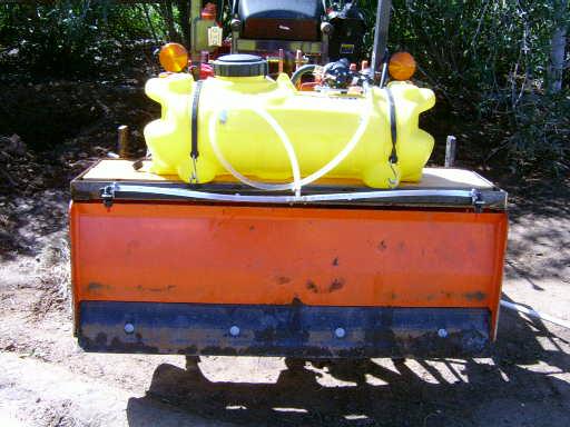

Thanks Bob, Your right the hose reels are a good idea too. I dont think I maxed my visa out yet so maybe its time to better my rig.
My spray bar is 42" and I just welded the bolts to the rack. I will put some wing nuts on them to make the rig easier to remove. Still trying to work out a height which is why there is excess tubeing. Heck I just got it today /forums/images/graemlins/grin.gif Gotta finish this today sometime.

You still haven't maxxed out the credit card . . . well let me give you some ideas.
$19 for a hose reel, you can mount that to the side of the tank on your platform.
$50 for the spray gun.
$2 for a "Y" garden hose valve to divert from the spray gun to the boom sprayer. And another roughly $10 worth of small adapter parts to connect everything up.
$xx.xx for the hose? I can't remember what it costs, but something tells me it was fairly expensive per foot of hose, buy until you credit card stops you and send me any you can't find a use for /forums/images/graemlins/grin.gif

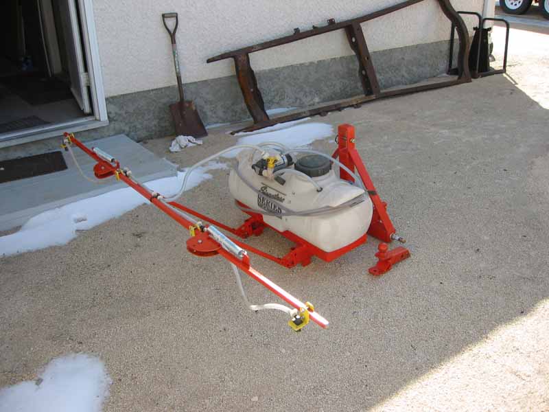

Originally built for use on a 1970 JD 11 Lawn and Garden tractor, now modified to fit on back of my orange B7500. Thats why a small 15 gal tank. Spring loaded folding arms on a removeable boom. Powered by a 12V pump. One tank is good for about a acre of spraying. Hose and spray wand to get at the areas the tractor can't get in to. This unit has been working excellent for about 4 years now.

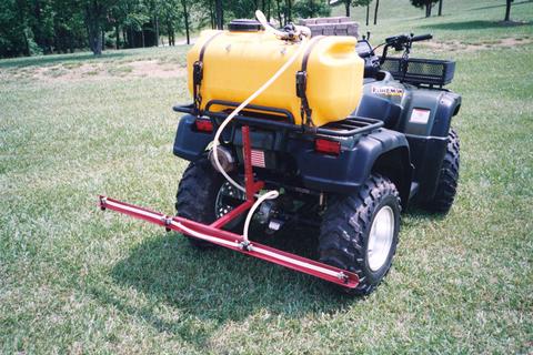

This is my current set-up. 25 gallon tank and approx. 72" spray width. I plan to weld up a frame to use it on the 3 pt and make a wider hinged boom in the future. Many nice set-ups here everyone.
