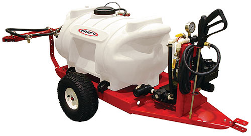

I just bought a sprayer at TSC and am in the process of adding a TEEJet Valve to isolate the boom in any combination I want.
It has a 3.5 hp Tecumseh engine with a 100 inch folding boom,four roller Hypro Pump + a 40 gallon tank. /forums/images/graemlins/grin.gif
