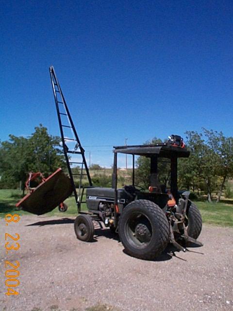

Here's mine. Homemade, lifting a 600lb bush hog.

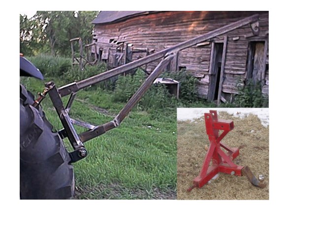

Here's mine, The pole goes into two 2" receiver sockets on my reciever hitch. Usually I have the hitch on with a ball on it. I pasted one picture of just the hitch into one of the hitch plus boom.

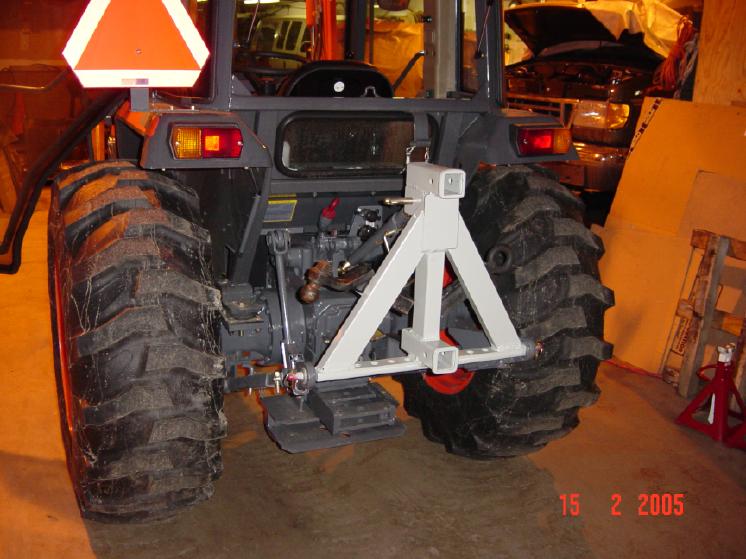

thats what mine is going to look like when i get around to building it.

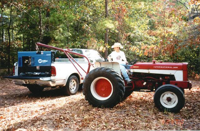

Sorry...............mine is store bought.

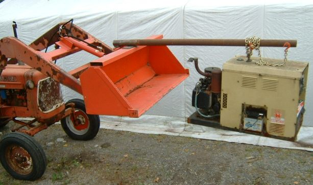

Here's a picture of the one I threw together to get this welder out of the back of the van. It pins to the heavy angles on the back of the bucket that the cylinder go to (put them there when I built it). There's a plate to spread the load to the top tube of the bucket.
Have since added a tension brace on top because it was flexing a bit more than I liked. Also need to plate the ends of the square tube on the bucket. It bent a bit transferring the loads.
BTW, the welder weighs something like 650# if I recall. Mounted to an AC D14.
FWIW. A.

I love your son's hat. It looks so cool on the IH red and white. You guys been doing trees lately?
Mines store bought too, but it sure works well. John

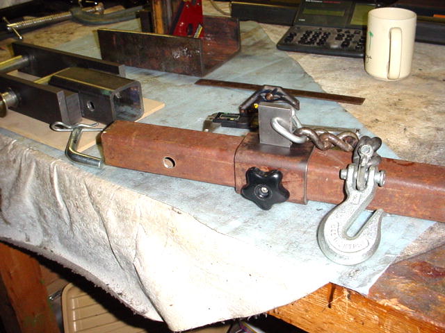

It's Home made
Pre assembly & Pre paint Pics attached to prove it!
