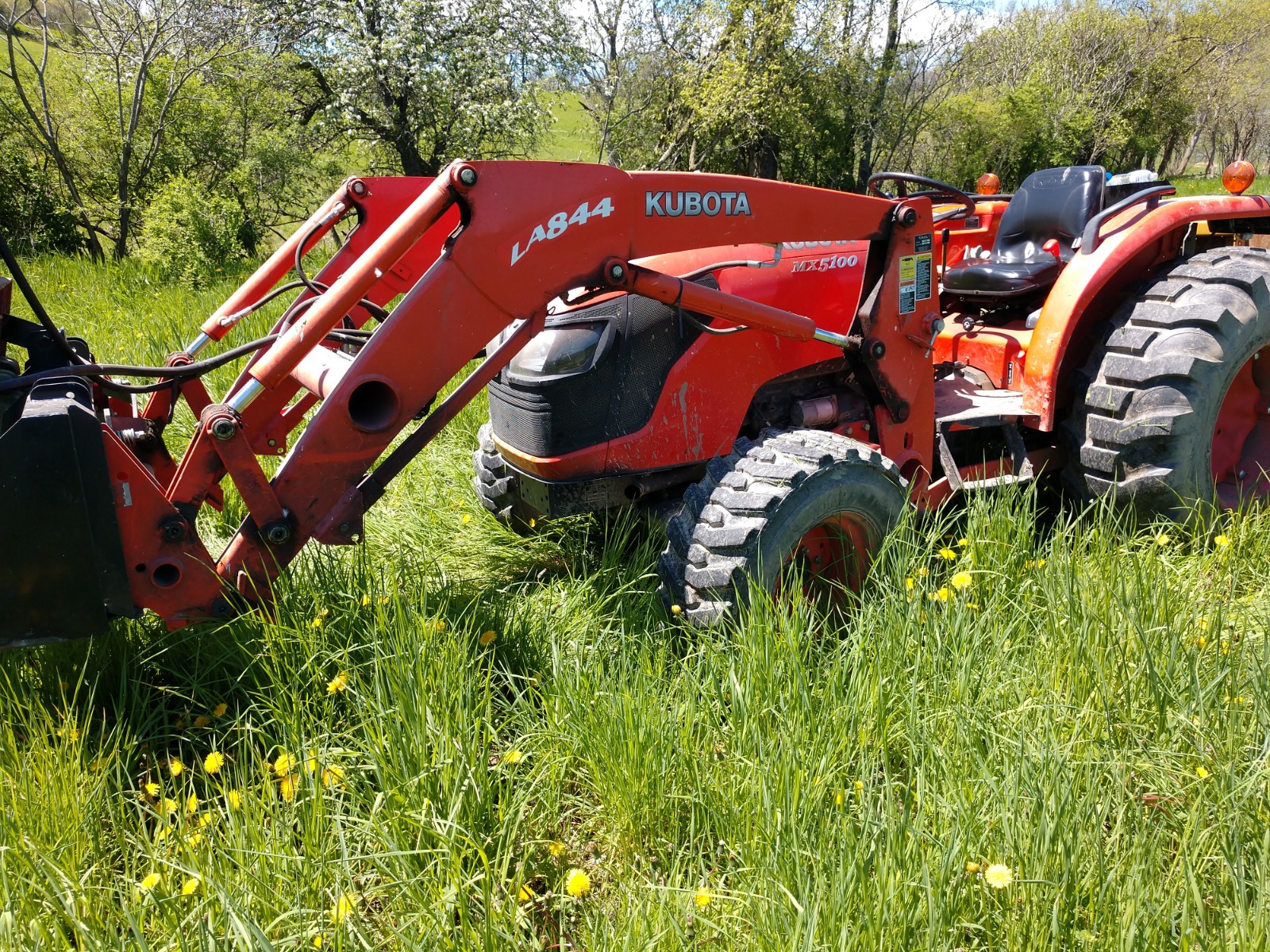

Here are a couple of pictures of our setup;
fencing 1.jpg fencing 2.jpg fencing 3.jpg fencing 4.jpg fencing 5.jpg fencing 6.jpg
We have it mounted on a SSQA plate and are using a rear remote for the hydraulic supply.
My nephew and I put in about 30 posts the other day in a couple of hours,
the ground is soft from all the rain we have had.
The posts are sharpened Locusts being driven into stoney ground.
As far as the hydraulic capacity we are only running the tractor at 12-1400 rpm while driving posts.
