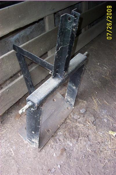

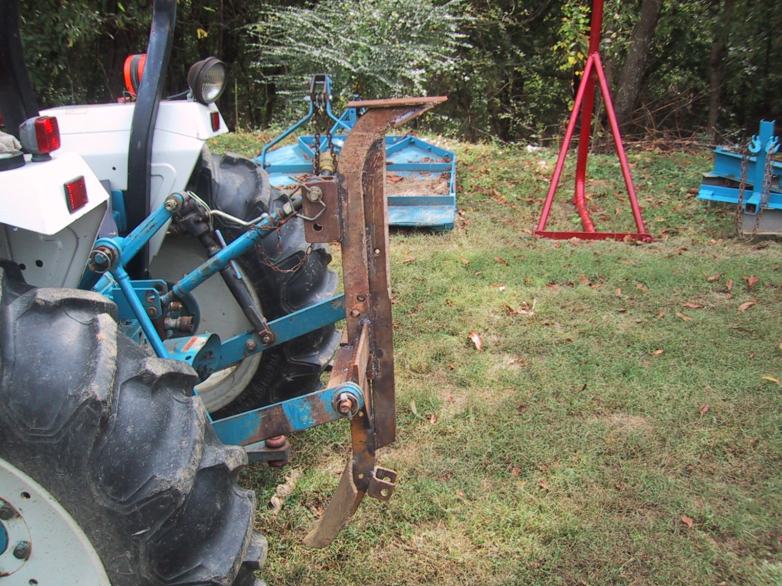

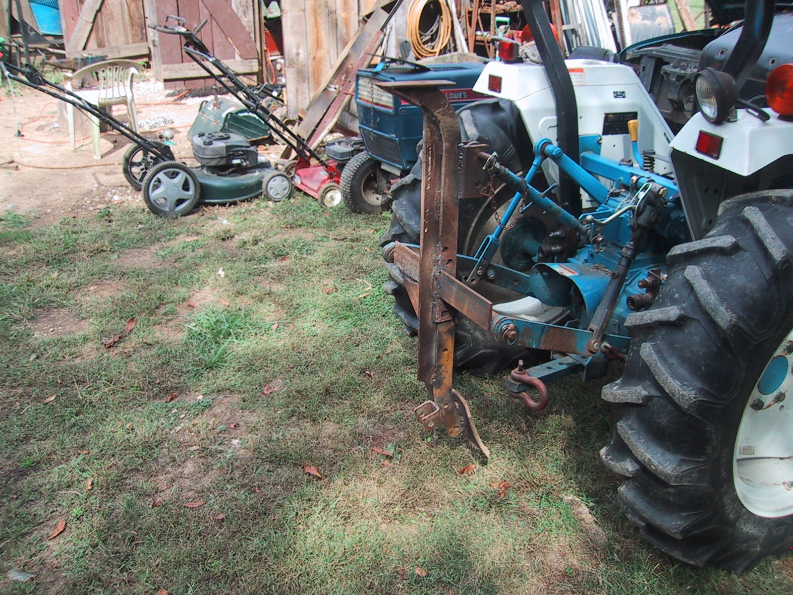

Since the 3ph doesn't have down pressure, you will need a tooth or 2 to bite into the ground and start the digging action. Maybe a tooth welded flat on each side (left and right sides) of the cutting blade, extending a few inches forward of the blade edge. That might catch the soil enough to pull the main blade into the ground.
That would probably get it to dig. Do you think the teeth would puncture the potatoes?
/ Potato Plow #23
2manyrocks:
If the top link is shortened it should bite and dig in to lift the spuds.
I was picturing a 'tooth' on each side, flat on top of the cutting bar, in the corners along the upright cutters. 1/2" thick, 2" wide by 6" long, with only 3" overhanging the front edge and the other 3" tacked on top of the lower flat edge/cutter. That would put them to the outside edges of the potato row. It would also be in line with the existing bottom edge, and slightly deeper, so they would not run into any more potatoes than your current bottom edge. I'm just brainstorming by looking at your plow. I know that plow would not dig into my hard soil either without something to start the cut and pull it down.
