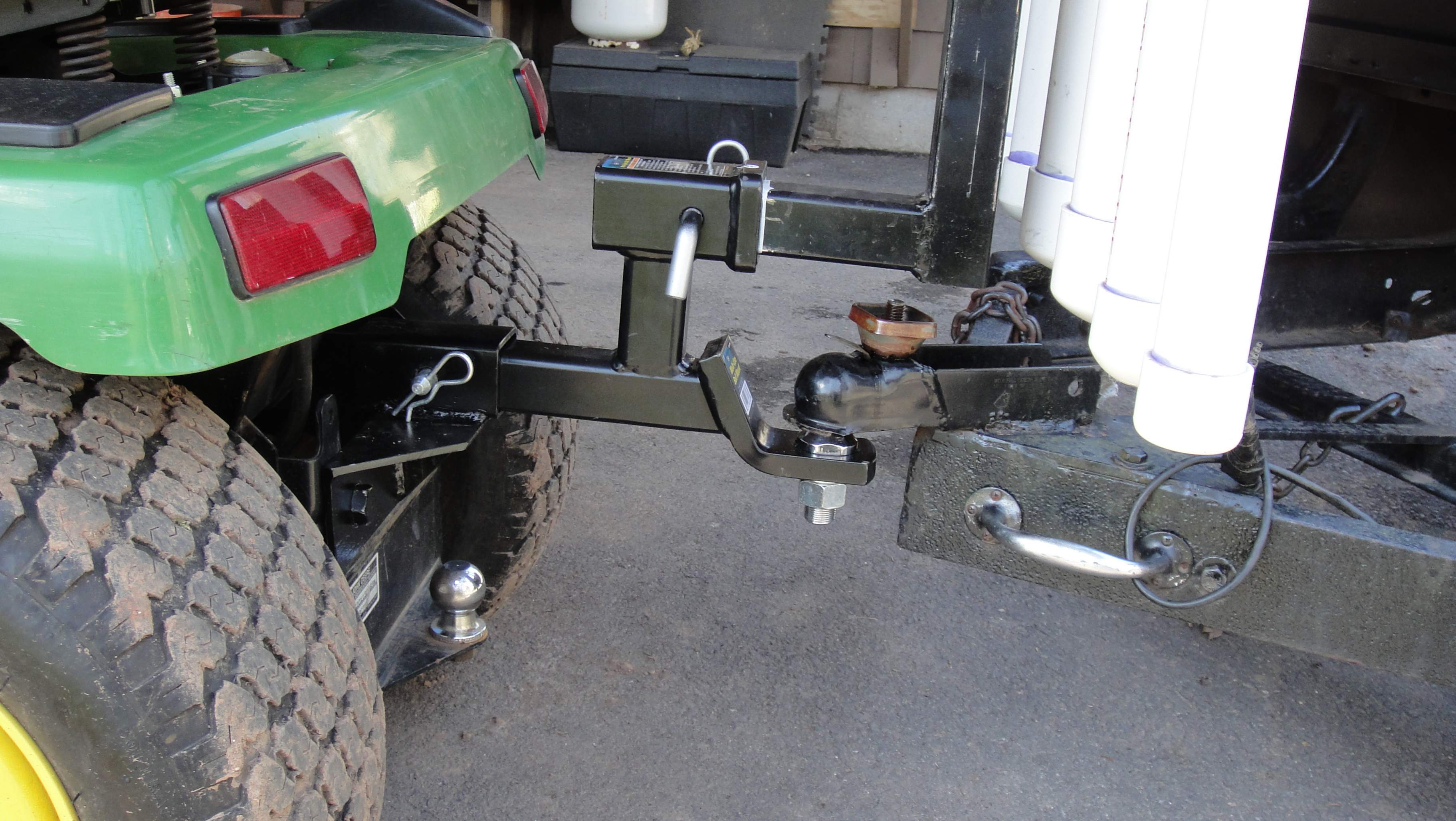

I didn't put a receiver tube on my JD steel box when I filled it with concrete, cause I figured I wouldn't want the heavy box when moving trailers. But now I think I'll weld one on, still probably only use it for occasional trailer moving, but they are so handy for other things like you mentioned.
I am a nut for those receiver hitch tubes, I have them on everything, my loader bucket, my two 3pt QH's just mounted one on my lawn tractor for a tool carrier I rigged up.

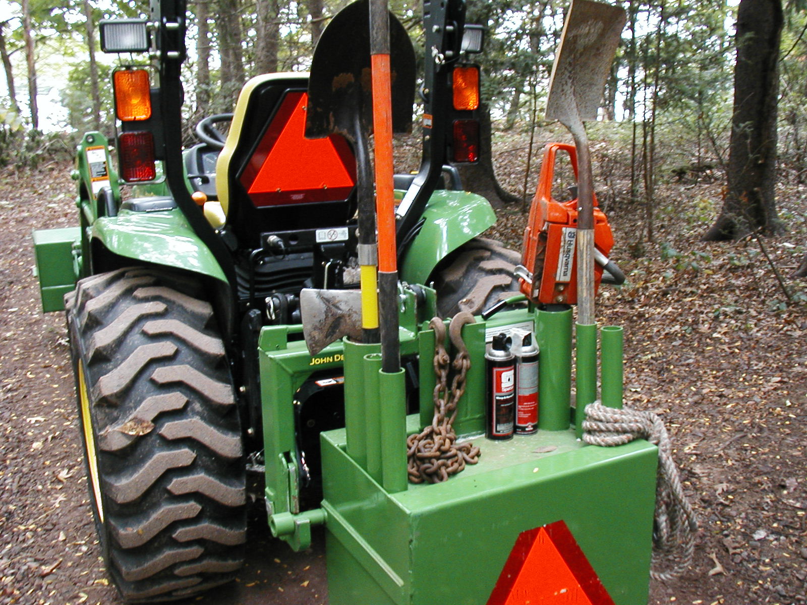

As far as what type of pipe to use for shovels rakes etc, just had another thought. We're worried about plastic breaking and metal rusting, how about a pipe just used as a form, before the concrete sets, twist the pipe around to loosen so it could be removed, then the hole in the concrete could be re-sleeved if the pipe needed to be replaced.
I used 1.5 inch pipe, most tools fit, but some of the new plastic handled tools don't, so I would say stay with 2 inch, even a skinny handled tool wont slop around much, about 30 inches seems to be a good height.

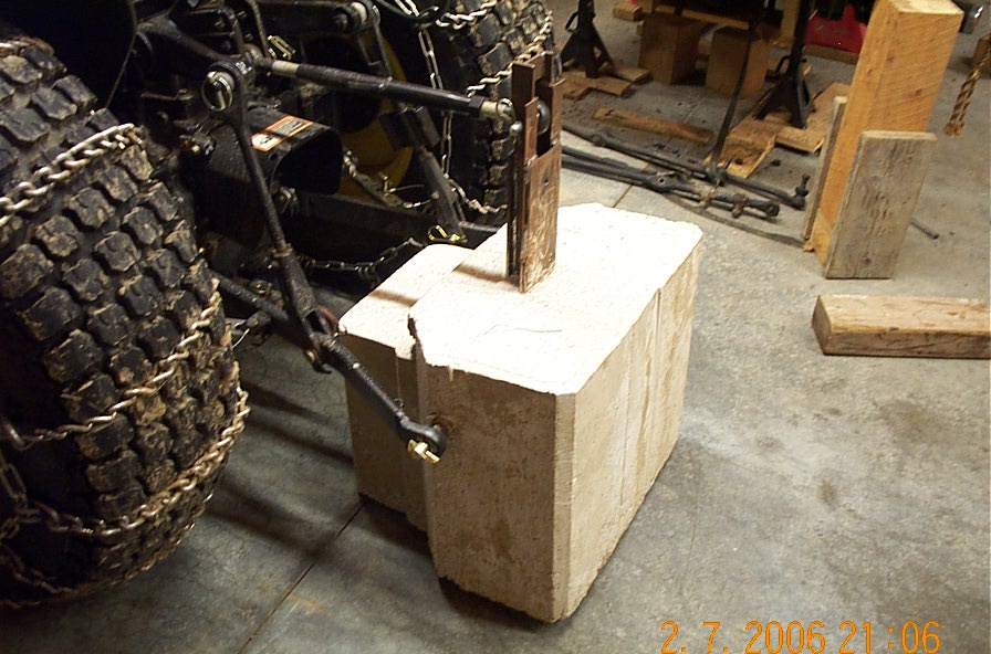

That is a great idea. attached are pix of mine- I later welded the top half of a Mack front spring "u" bolt to the verticle but hooks would be better. Also if I ever build another one, besides the ideas others have had about shovel holders, I think I would cast some heavy pipe in place to create leverage points to stick a pinch bar in to help muscle it on and off the three point hitch.
