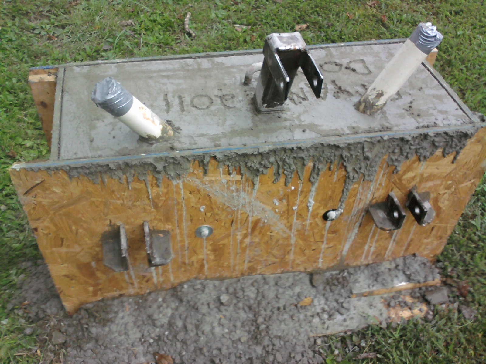

Well took a while to get this project finished but finally was able to get around and pour the box full of cement yesterday, it has been setting in the back of my shop sense about April. :) Just had so many things going on all year never got around to it, until a friend of mine put in a pool a few eeks ago and asked if I could help him pour the concrete around it, didn't even give the box a thought till almost the last minute.
Here are pics after pouring, guess I will let it set for a couple days then remove the forms.

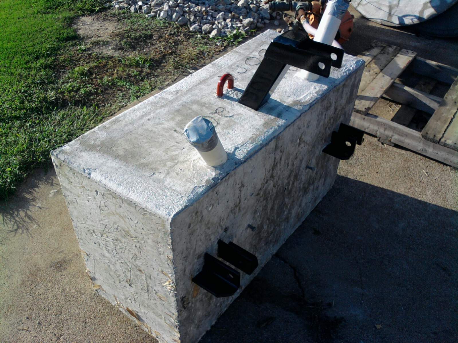

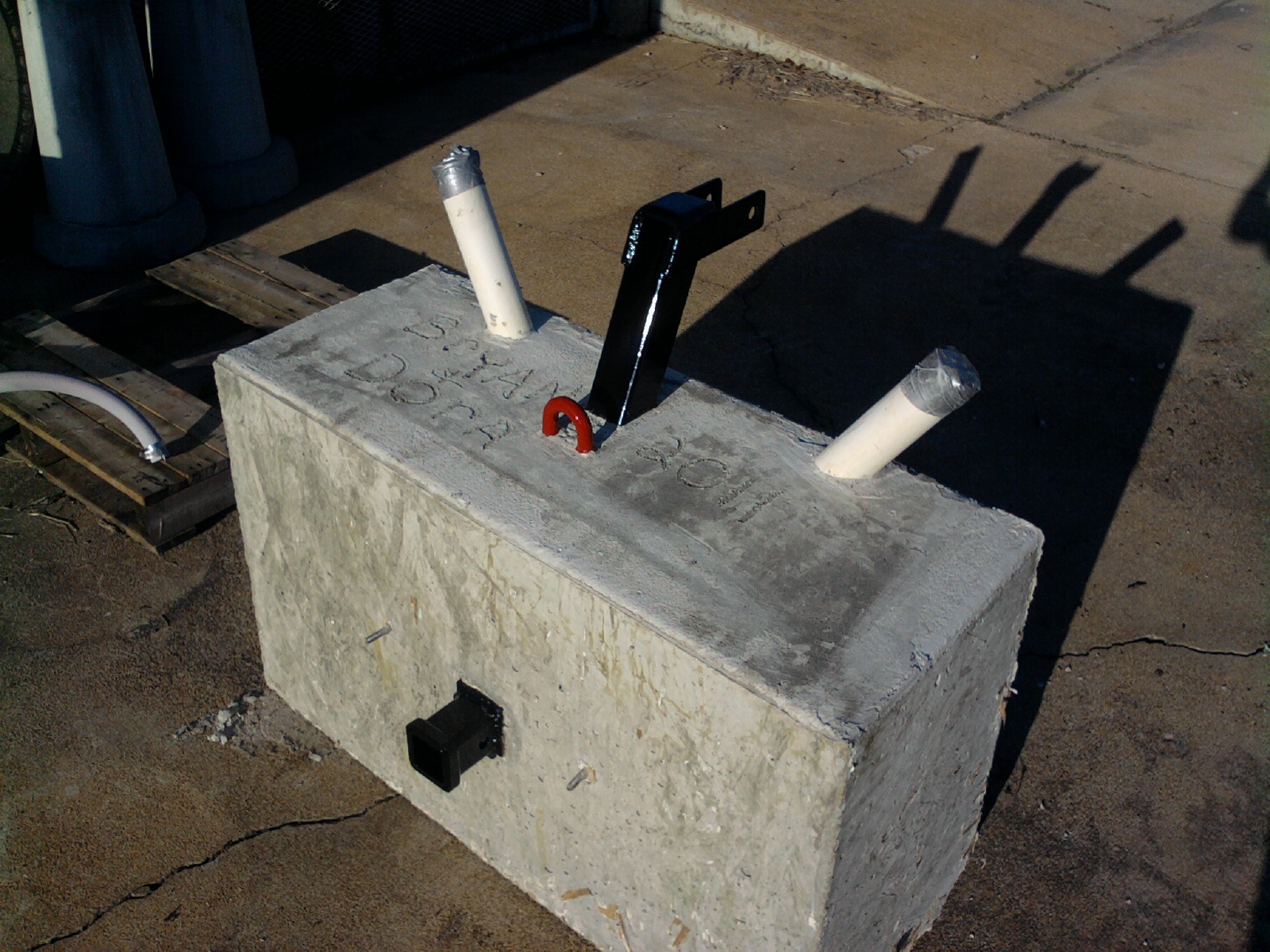

Well She is finally finished, and looks like it will work just as I was hoping for. A couple of pics with it all painted and ready for use.
