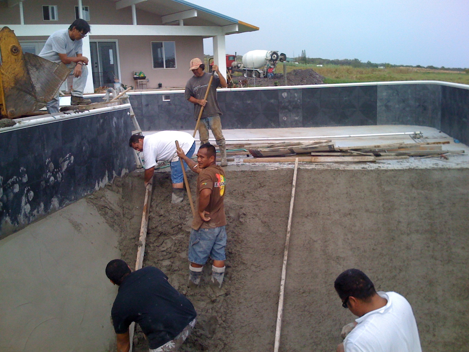

Someone should be able to tell you what slump to order.
I think this was a bit steeper
Thanks for the picture. I may have used poor wording. The wall itself is vertical, only the top of the wall is sloped/tapered down to a reduced height.
No, I understood. Just thought this might show that your slope shouldn’t be a problem with proper slump especially with a form.
