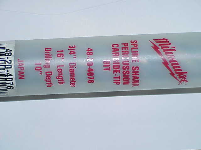

First, allow me to tell you that it is easier to drill through concrete than it is to drill through rock. It is also easier to drill with a solid drill bit than it is to use a core bit. I own and have used both and I have extensive experience with both. Whenever I have a choice, I always use the drill bit rather than the core bit. The core bit is always slower, harder on the tool, and harder on the operator. It doesn't take a genius to understand the mechanics of operation to understand why. One is cutting a circle and the other is cutting a hole. The pictured tool will work for your application and will drill 10" deep. If you need more than 10", then you will have to find a place that has longer drills. If the rental yards don't have them, then start calling construction companies and see if one of them will rent you the tool that you need. I once rented a hammer drill that darn near needed two people to operate to take down a concrete block wall. The electric hammer drill was more than 4 feet long!! You need to start thinking positively, not negatively. You need to start thinking how you can get this done. Time is becoming your enemy, not your friend. We can only help you so far, the rest is up to you. Don't stumble now.
Once again, forget the anchors that they are trying to sell you. Go to an industrial supply house and buy some commercial grade threaded rod stock. It comes in 3 or 4 foot lengths. Also buy the nuts and washers. Do NOT buy stainless steel. I won't get into the reasoning, but trust me, you don't want stainless steel!! Grade 5 or grade 8 threaded rod is what you want. Grade 8 is preferable. NOT hardware store threaded rod... Industrial Supply Store..... Do I make myself clear?????
