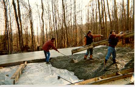

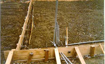

I would not enclose the entire building if you can help it, it will make the cement delivery a nightmare. I will attach 2 photos to help in the impression. This is a 25 by 40' pour, 6 in thick, 4000 PSI fiber reinforced cement. The outer forms were all leveled with a transit and the center board visisble is a temporary screed support consisting of a 2x6 nailed to a 1/2inch pywood, you pull it out as you fill the second side. You can see the truck boom in one of these pics, if you enclose the building you loose this option. I would look at nailing some tarps on with some furring strips to prevent them tearing off if you need to keep the wind out. This si more effective than you think. This was 21 yards on 3 trucks, took a me and a 4 man volunteer crew almost 4 hours to complete ( 4 of 5 were cement experienced, all were hard workers!). Also note the plastic, acts as a vapor barrier, slows down the cement setting up and provides a slower stronger cure. The final thought is about wiring. The other post I will floow with has some provision for bringing wiring in and for consuit runs throughout the building. Better now than later.
If you get lots of hands and someone in charge for $100-200, and he has the finishing tools you'll be all set, otherwise I would defer to the professionals.

   / pouring concrete in pole building #76
</font><font color="blue" class="small">( I would not enclose the entire building if you can help it, it will make the cement delivery a nightmare.)</font>
I don't totally agree.

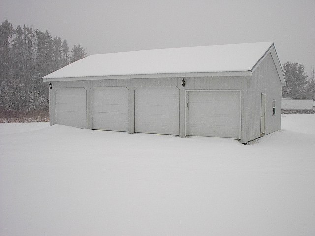

I also have a pole barn. 28 x 40 (3 bay + workshop) with a 6" reinforced fiber slab with NO expansion joints.It was built in 6-2002 and the floor poured in 6-2003.This is the 1st. winter for the floor and so far found NO cracks.I had ALL work done by the pros,both were 3 men crew.(built and poured).I waited a year for settling before pouring and believe that makes a huge difference in the overall outcome of the project as a whole.I'll try to get some photos posted. )</font>
Moeh1,
Depending where you pour from. I had mine poured from the front of a 3 bay + workshop. The truck had an extension for the chute that reached in far enough to get close to the wall 28' back. He would just back up to keep the men going. The last thing to get done were the garage doors a few weeks later (not that they would have got in the way).

Gerard,
I can see from your pic, you could reach the back wall pretty well given the whole open side. My door ended up on one end, so I would have needed a 40' reach. Most of the trucks here refuse to carry extra lengths of chute with them for whatever reason they dreamed up, so we are stuck with about 16' -20' working reach from the truck. Also I have learned that being flexible (although not always being necessary) is never a bad idea. Mopower doesn't have a firm handle on what he is doing, so I hoped the suggestion would help - thats just the engineer in me /forums/images/graemlins/ooo.gif. The other issue I have seen before is that depending on the grade of the surrounding land - extra chute doesn't always help, but I didn't want to bombard him with too much at once. The last thing needed is a chance to show how much cement Mopower can wheelbarrow before his back gives out. /forums/images/graemlins/shocked.gif
Mopower, you really need some advice from someone on the local scene who can do a quick look at your spot, and also find out what kind of equipment capability your local supplier has. The other item I didn't mention because I didn't include it in mine is water - both supply and drain(s). you need to think about these now if you want to make some provision for them.
Finally, one more tip - use it or not, I like to screw some big metal handles ( the good ones) on the top of the screed board, it makes it a lot easier to work it. One about 18" in from each end is fine. It sounds like you are in warmer climates, too bad you are not closer, I am bored for the next couple weekends until the snow melts /forums/images/graemlins/mad.gif
