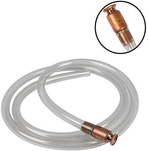

A siphon / shaker hose. Set the can on the fender, shake the hose a couple times, then go check the fluids, etc.. for a couple minutes while the can empties itself.
I put the can in the loader bucket, raise it up and use one of those to get the fuel running.
