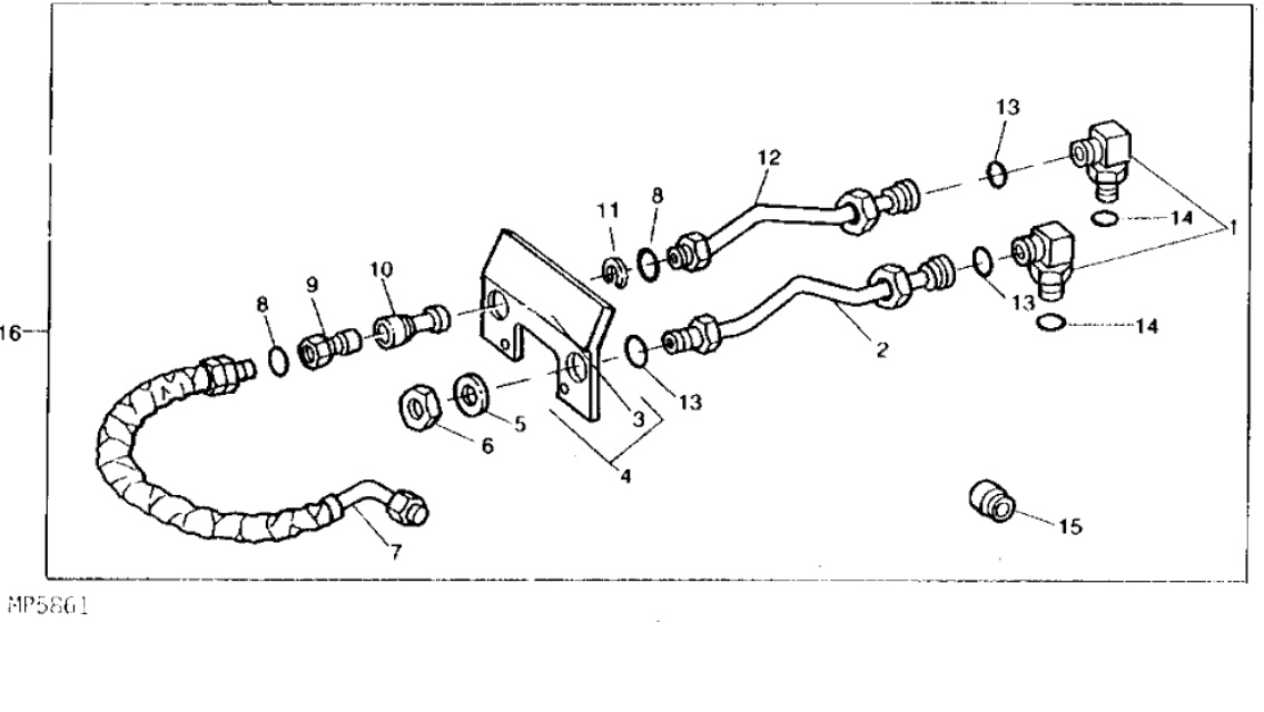

Does anyone know if this is the kit?
/ Power Beyond 955 - adding rear remotes
That image you show is only hoses.
The actual power beyond is in,,, or part of a valve.
Different valves produce "power beyond" oil flow in different ways.
All of the valve discussion is seperate from the image you show.
Ok, that makes sense. So, could I install these lines and is that the plug also, then hook up a valve....
/ Power Beyond 955 - adding rear remotes #9
I'm sorry I couldn't get into the account, YES That is the entire Power Beyond Kit !
/ Power Beyond 955 - adding rear remotes #10
The two 90's go into the transaxle , # 15 goes into the side of the Transaxle

Ok. I got the parts list and prices from JD. Now, let's say I want the capability to hook up a three separate cylinders (grapple, and top n tilt!?!?) . What type of control valve setup do I need?
I'm sorry, I have no idea how to hook this up to control an implement at this point. I just know now how to get the energy source back there.
/ Power Beyond 955 - adding rear remotes #20
You would need a Open Center 3 spool valve
