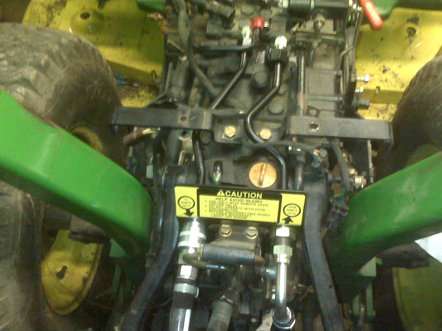

It's pretty simple
   / Power Beyond 955 - adding rear remotes #14
Pulling the fenders makes it an easy job

Ok. I got the parts list and prices from JD. Now, let's say I want the capability to hook up a three separate cylinders (grapple, and top n tilt!?!?) . What type of control valve setup do I need?
I'm sorry, I have no idea how to hook this up to control an implement at this point. I just know now how to get the energy source back there.
   / Power Beyond 955 - adding rear remotes #20
You would need a Open Center 3 spool valve
