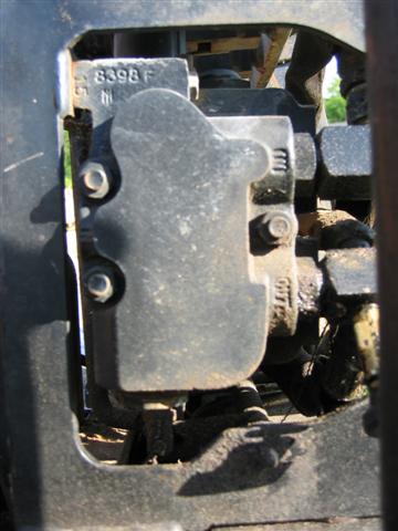

I took a picture of the backhoe valve. In the one picture the red circle is around a rusted six sided nut...maybe. It is on the SWING section for the valve bank. Is that a relief valve? It the only one that is rusted like that and I broke the loader valve exactly when I swung the boom to the right and now the pump broke when I swung the boom to the left. This could be coincidental but I have been thinking about that for a while now and today I took the covers off the backhoe and see this. The other picture is of the end section that I think the main relief of on.

On the second picture - take off the cover (2 bolts) and you may see the relief. It should be right around there.
On the rusted cap. I don't think so, but....(?)

I believe that is a load check as you will see all the sections have them the relief valve will have a different style of cap with a screw of some type to adjust the pressure look on the section where the flow comes into the valve most likely just oppeset the line
That looks like a shock relief valve. These are often seen on the boom,
dipper, and swing circuits. For the swing ckt, you should have one on
the other side of the valve, too. I see you have a swing speed control
valve, too. That's the cross handle on the front of the swing spool.
