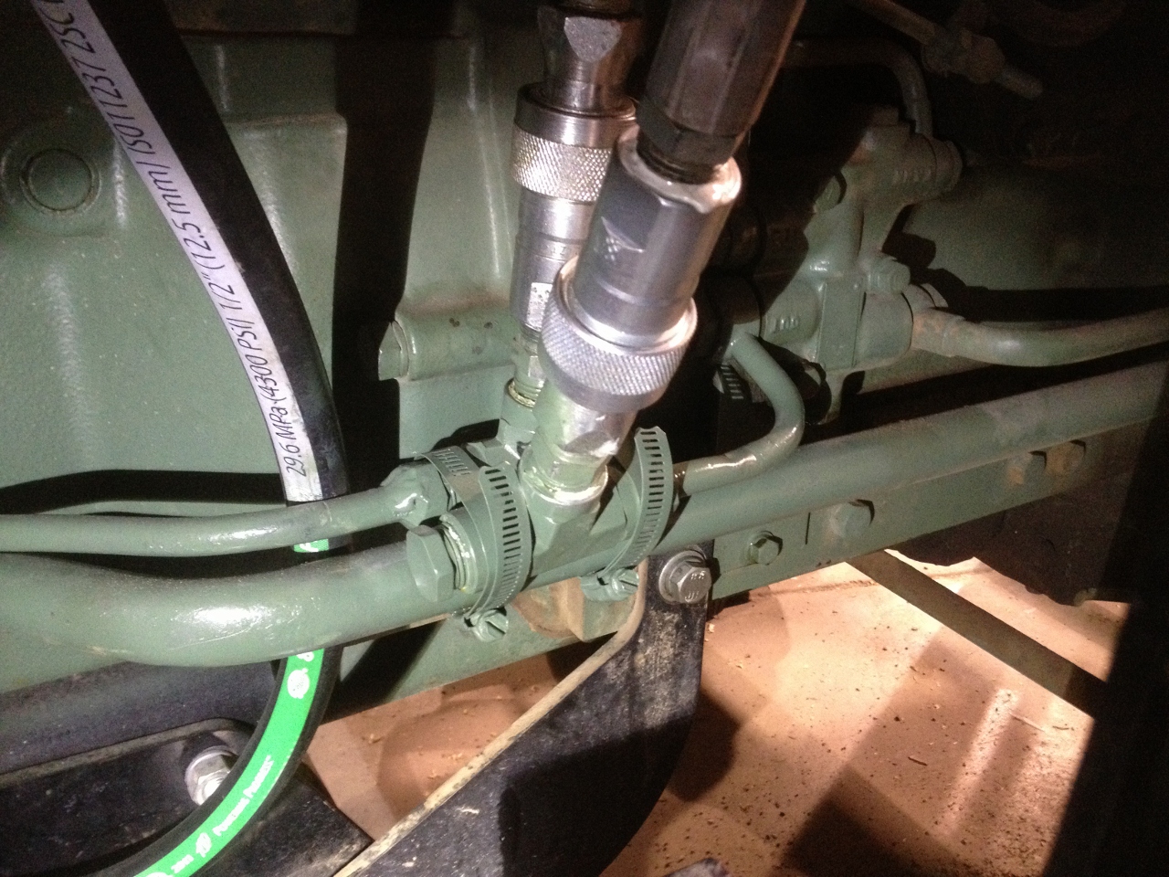

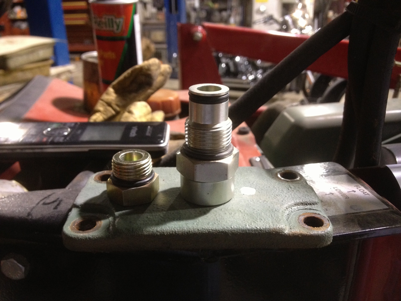

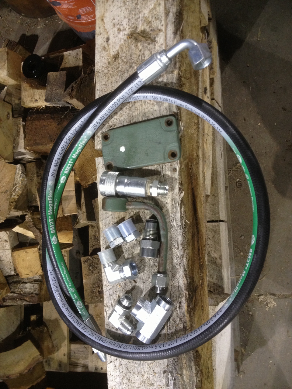

Yup id say the thickness is a good indicator of volume as a comparison measure between pumps it sure is with automotive oil pumps. I am going to hard line my return to 3/4 like Kenmac next and if that is a bust a used bigger pump off a JD or new pump at Hoye is next after that.
I am on a mission now I got started on this I will have a loader that works one way or another! I know the shop foreman at the local JD ag dealer so may have him scrounge around for a used 950 or 1050 pump cheap before I spend 400 on a new one.

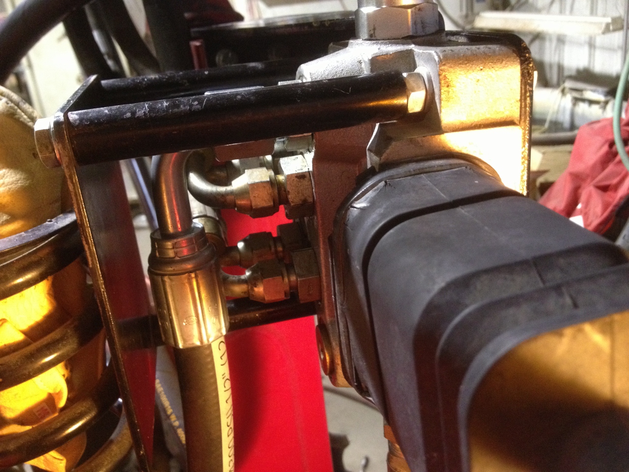

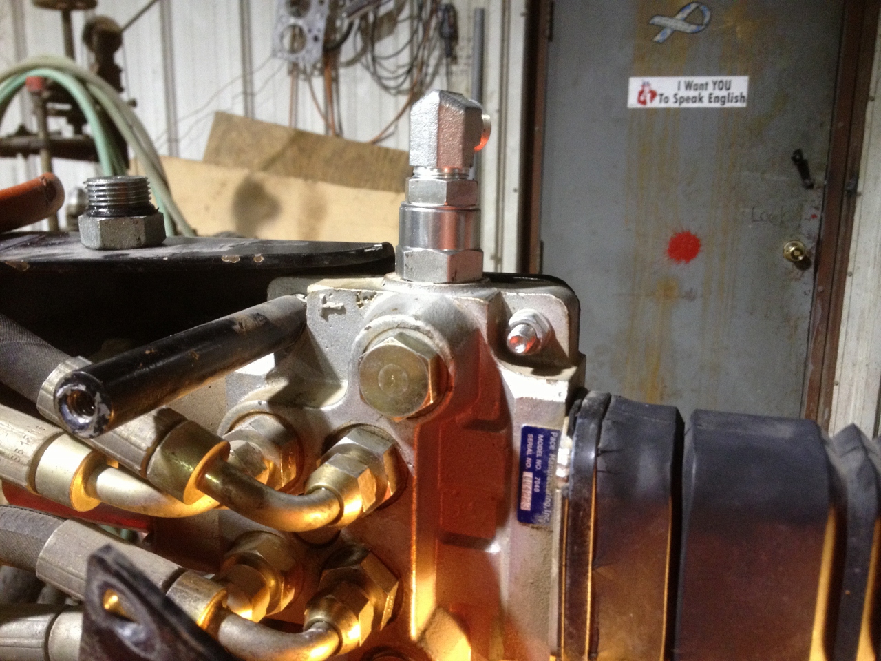

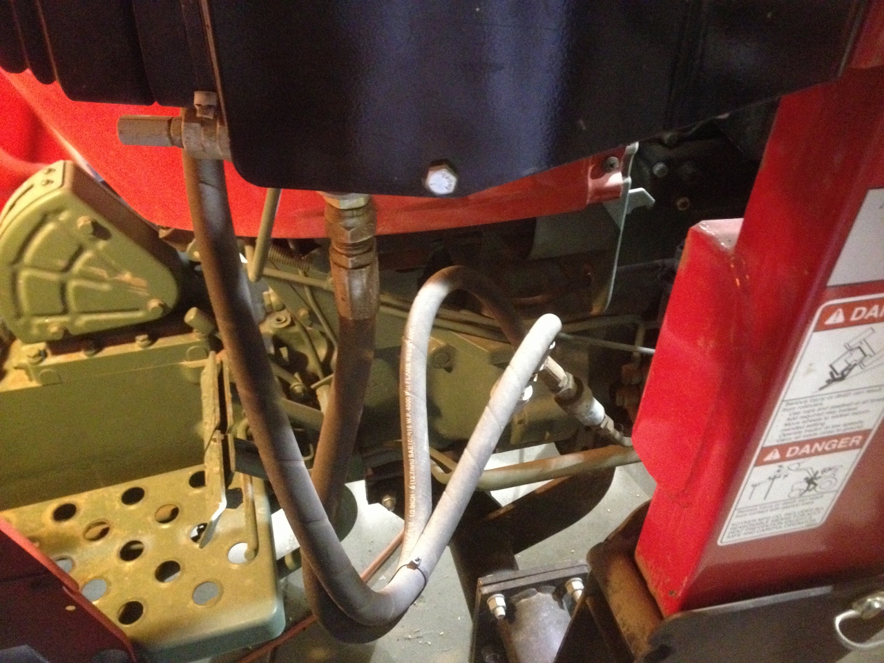

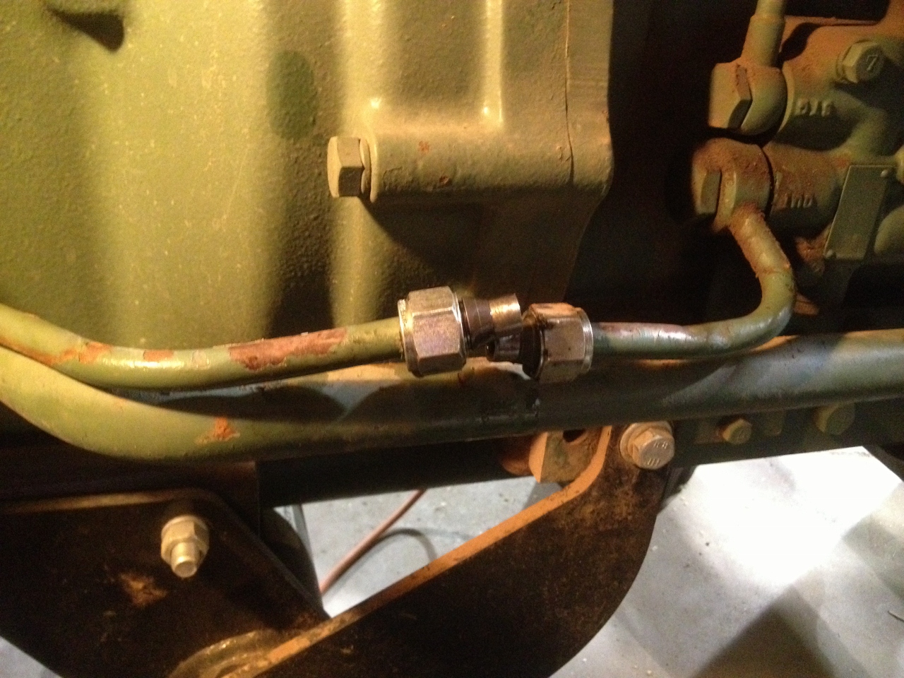

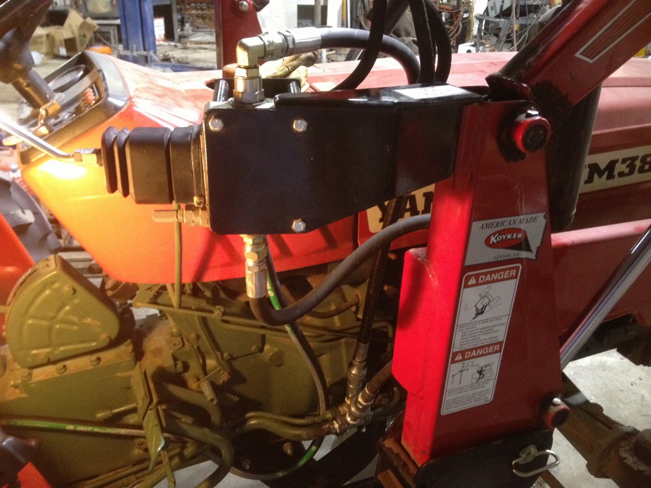

Update: On a positive note we had 19 inches or so of snow in the last week 12 all at once and 20-30 mph winds yesterday we need the moisture badly Id love to have 19 more just spread out a bit. I had drifts across my drive into the shop getting close to 2 feet that would build back up in an hour or so closing my drive to anything but a 4wd truck.
This morning I had to bucket the snow out 1 at a time out in order to get down to the road the drifts were too big to drag or push. Anyway I am a lot closer than I thought to having this loader figured out she worked pretty darn good way way better than before. :thumbsup:
I found at a steady 2200 rpm it works real nice in fact like I mentioned right after I added the PB the regen detent in my curl is actually a useful thing now haha. It used to be just a dead spot in the stick 90% of the time before I would be dumping and move the stick further to the right and she would just quit moving all together that was very frustrating to say the least.
So now I will be thinking hard about the 3/4 jic to pipe fittings and so on for the updated return. I have 1 problem with that change I think I may not have enough room to use a 3/4 90 with my cup holder right there behind the loader valve time will tell. I dont know enough about what fittings are available to say right now what I will end up with. I may wait till the snow is all gone to mess with that dont know.
