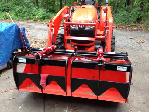

Please pardon my hydraulic ignorance :confused: . I have read everything I can find on adding a third function. I am attempting on using an open center spool for a grapple attachment. I know the IN comes from "power beyond" "OUT" can be T'd to the return or tank line. My Kubota L3200, has a Power Beyond line that goes from the FEL spool to a valve body. So; that valve body has 1. Pressure (yellow), 2. Return (tank) (white) 3. Power Beyond (green). This is according to a document I have.
My question is do I simply T the Power Beyond Line?
My local supply store has very few fittings, so it looks like I will have to buy all my fittings and Ts online... :(
Here is my progress, all I need is to complete the plumbing.
   / Power Beyond on Kubota L3200 #2
No, you never T a pressure line like power beyond. It goes in series. The power beyond hose from the loader goes to your valve, and its power beyond line goes back to the location where the green power beyond line came from, to power the 3pt. From what I understand you don't want to use ordinary NPT fittings like you would buy from the hardware store, they need to be high pressure rated. The tank lines can be T'ed. as there is not any real pressure on them.

Ah, now I see...
Although I have an open center Energy 20038 four-way valve. It does not seem to have a PB port. Perhaps I have the wrong unit for the job?
I will check back tomorrow to see if anyone knows if this is the wrong valve.

Well the spool valve (above) was the wrong one, J_J enlightened me on the type I needed. Kenmac gave me this link in another thread; " https://www.surpluscenter.com/item.a...name=hydraulic "

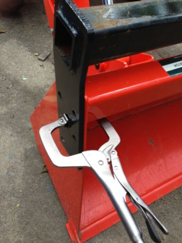

Have one hose with a bad crimp that leaks. Also a possible fitting leak, and the plan is to have it all working by Friday. Will post more pics at that time.
Talk about a learning experience on hydraulics. It's worth the savings.

Yeah Steve, that is exactly what I have done. My quick disconnects are on the grapple. So that if I have a rear attachment I can just reroute my hoses to the back with ease.
Thanks for the pictures.
