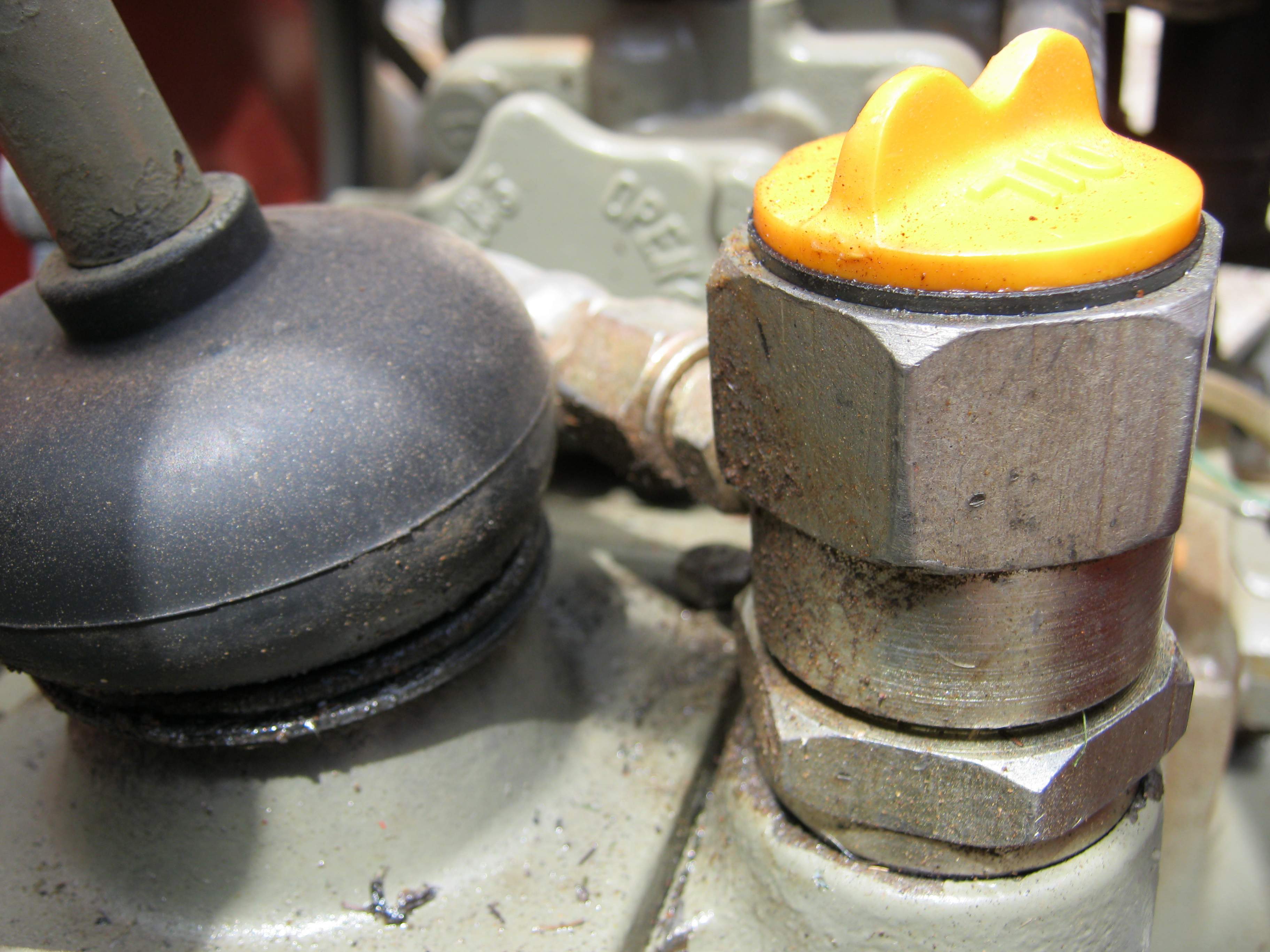

Possible these threads are Japanese JIS Tapered pipe? They would be 3/8-19 and approx 16.7 mm OD on the female thread. JIS tapered and BSTP (British Standard Tapered Pipe) are interchangable.
The metric 1.5 thread gauge seems to fit the threads right on. 19tpi would equate to about 1.3 metric. Sure not positive but another thing that makes me think it is a straight thread is because it is a short thread, I would guess about 3/8" long. I'm still holding my breath "Akon" will respond this next week. Maybe Neat 1500 will shed more light for me. :D

M16 x 1.5 is standard size of metric fitting so it could also be that. Normally these types of fittings would have a flat spotface and or a chamfer on them like an american SAE O-ring port.

Thanks again for your willingness to shed light. The surface does have a little chamfer or bevel on it. I am in operation but have been convinced I'm just not plumbed correctly. I have had absolutly no problems without the power beyond port but still want to do it correctly if possible without buying a new valve or something.

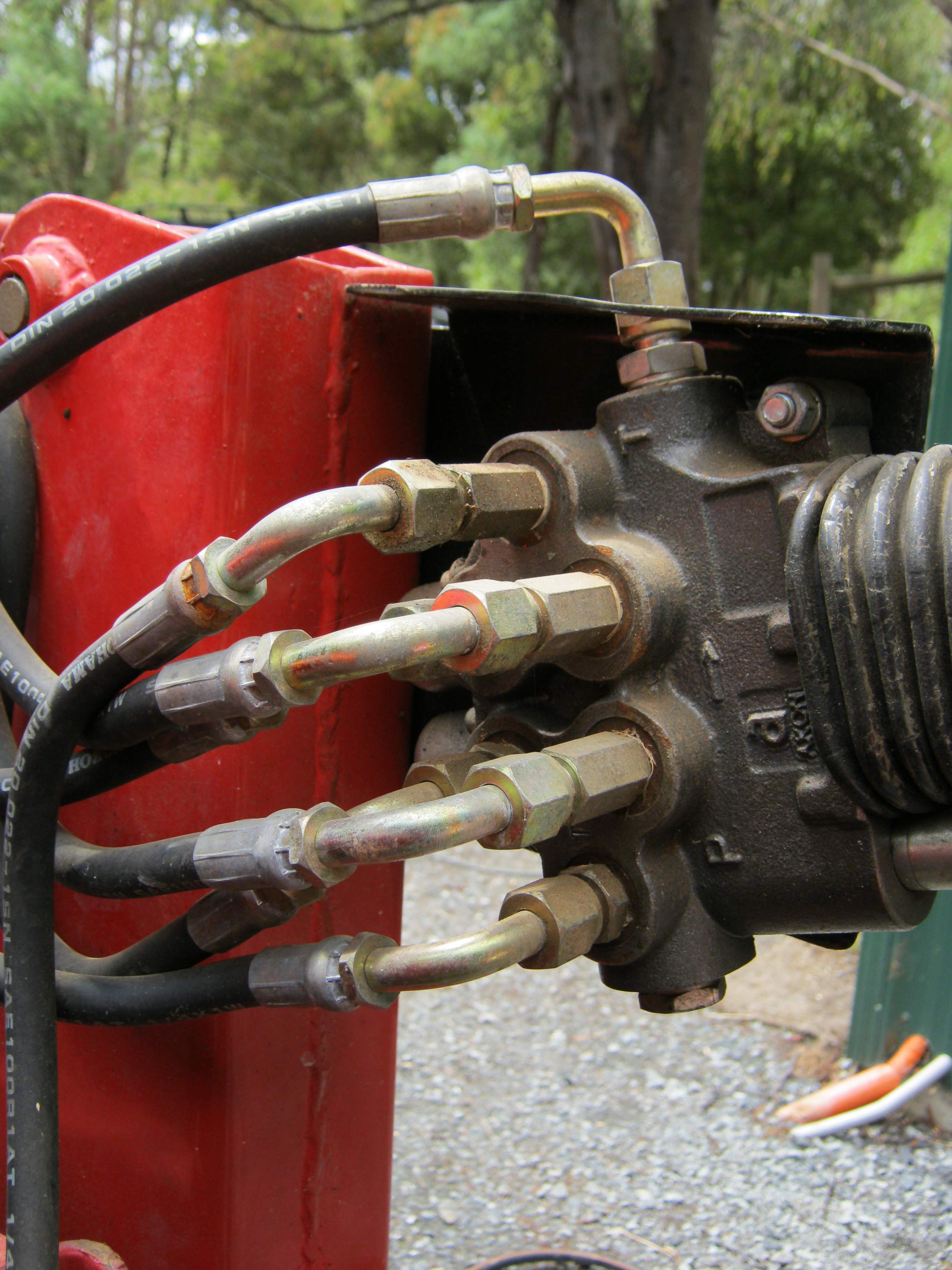

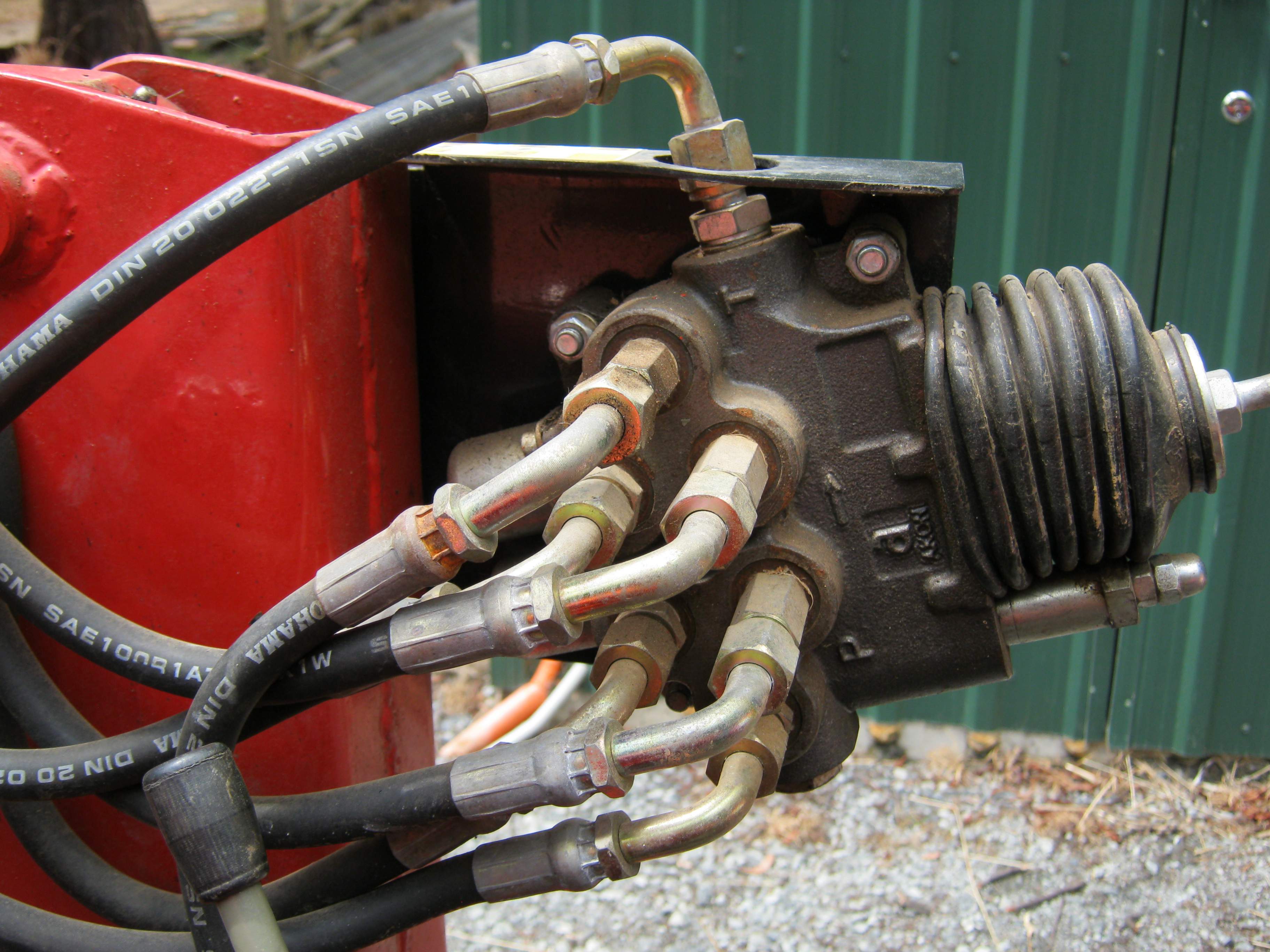

Ok its all back together.
I plumbed the new loader valve the same way it had been for 30 years, with the valve's Out port in series ahead of the 3 point control.

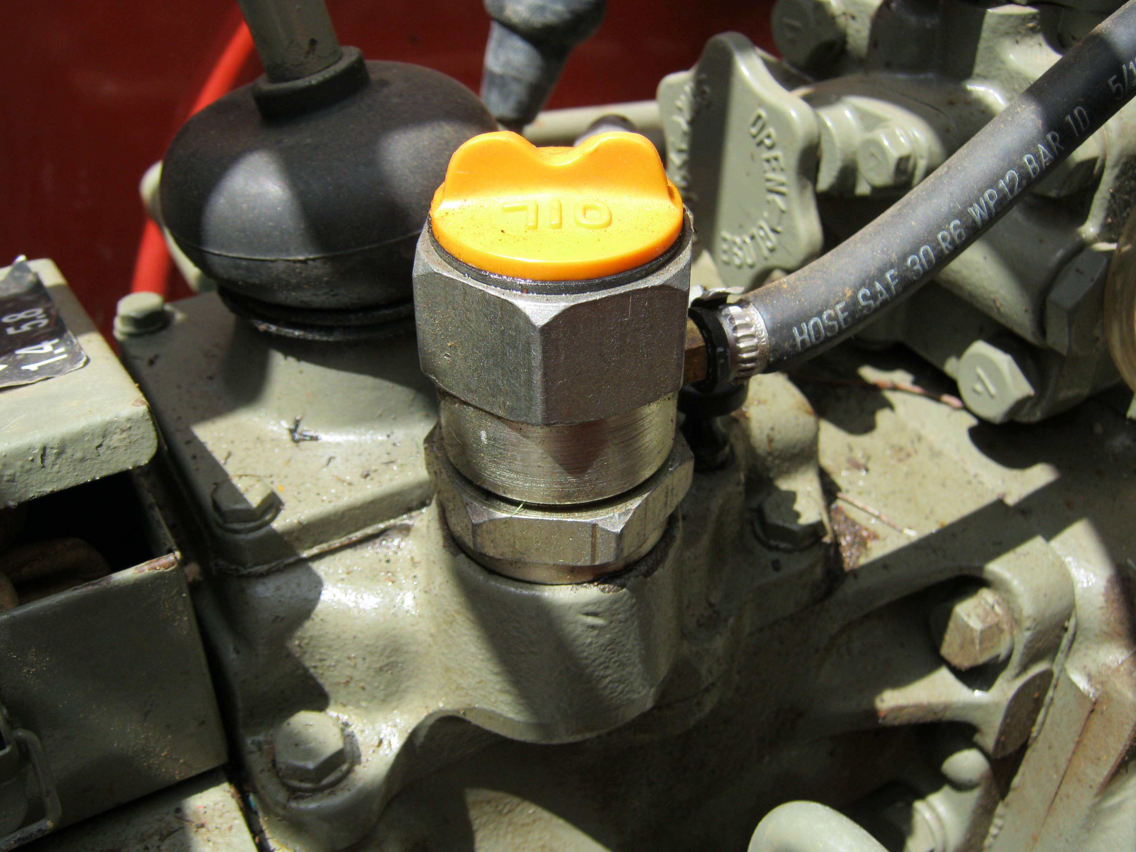

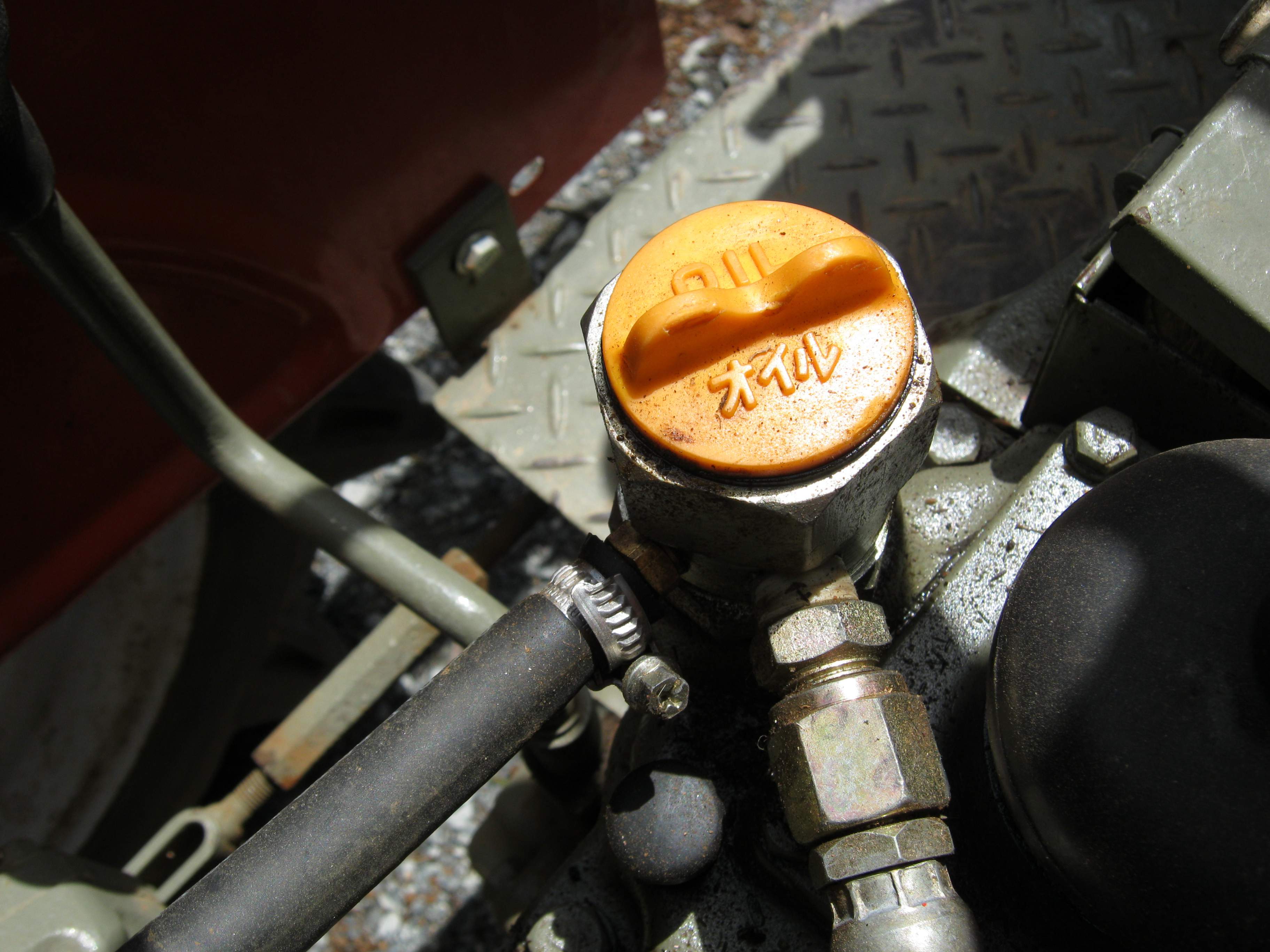

Here are the photos of my tank return and my loader valve.025.jpg026.jpg027.jpg028.jpg029.jpg

Thank you neat 1500 for the pictures. I know what I need to do now. Only thing holding me back is identifying and procuring whatever fitting is in that top plug hole. Hoping "Akon" will respond but dubious.

For me, I learned that replacing my loader control in series is 'good enough for the girls I go with' :) as an old Carpenter buddy used to say. In contrast to this, the 'Best Practices' solution is a separate Tank Return like that Kubota dealer started doing.
Also using series configuration, the 3-point lever must be at Down or Hold (not Lift!) so it isn't making back pressure, any time the loader controls are used. If that were in Lift position then the back pressure from the 3-point may be additive to the pressure allowed by the loader control's relief valve.
