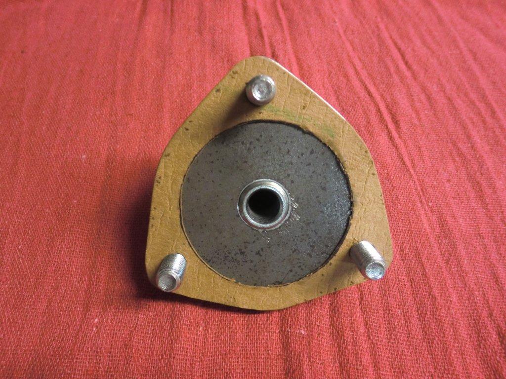

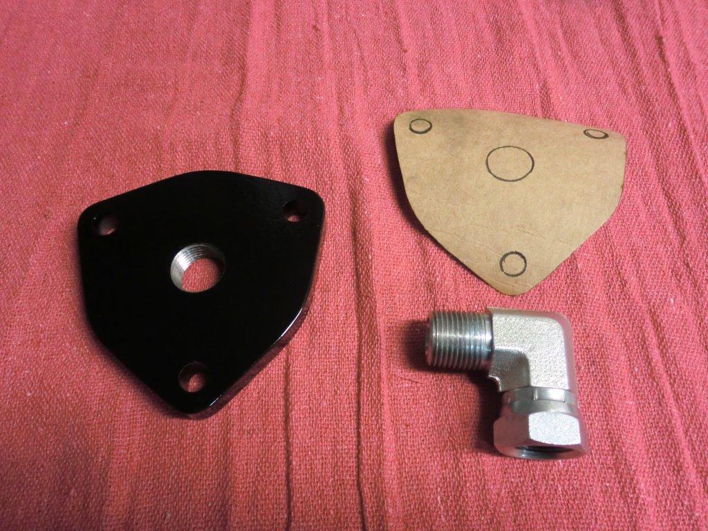

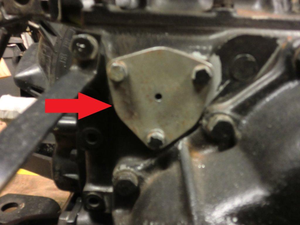

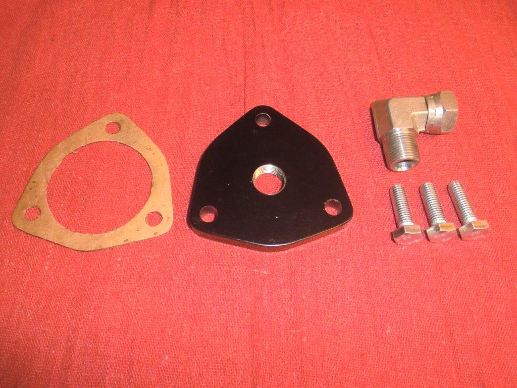

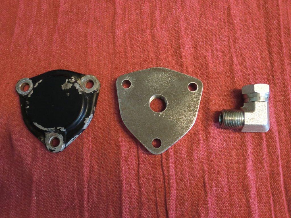

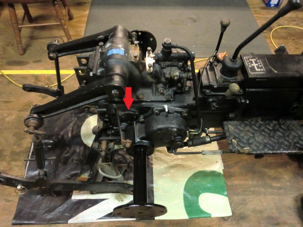

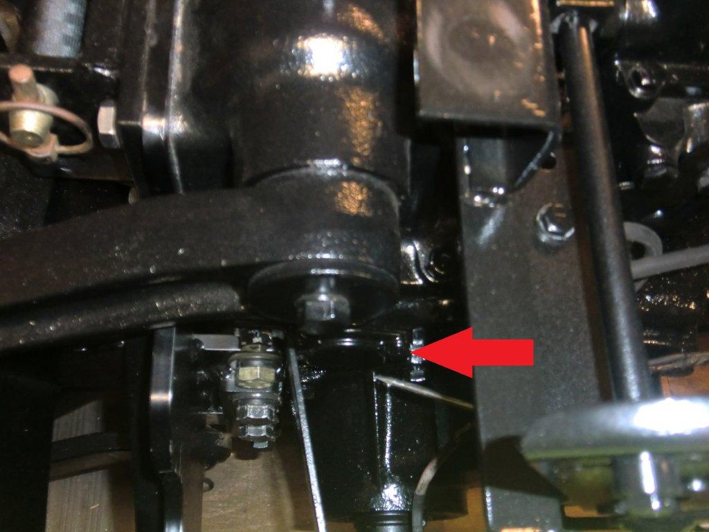

California, here are my plans for the dedicated tank return from the loader control valve (I believe that I may have the same loader valve as you (without running out to the shed to verify) with a very similar mount).
As described in the previous post, I fabricated a new triangular plate to replace an existing cover plate on the right side of the transmission (above the axle/brake housing). This was cut from a piece of scrap 3/8" steel plate using a cutting wheel on a 4 1/2" angle grinder. The center of the plate was drilled and tapped to 3/8" NPT as I plan to install the 3/8" NPT 90-degree elbow as shown in the pictures. My intentions are for the tank return hose to run from the control valve, under the right step and banded to the original hydraulic tubing, to the return fitting in the transmission.
Pictures 1 & 2 - location on the transmission/cover plate to be replaced (there is also another one of these on the left side of the transmision if needed for an alternate return)
Picture 3 - new plate fitted
Picture 4 - new plate next to original cover plate
Pictures 5 through 8 - completed adapter plate
I had thought about drilling and tapping the original cover plate (off of the tractor), but decided not to as it was thin aluminum.
I hope that this may spark some other ideas as it was my intention to have a clean install while also keeping the operating area as clear and neat as possible.

Nice job with nice pictures. Just curious, what is behind that plate? Bound to be there for a reason.

What is behind the plate? Is that simply an opening for some optional component that was not used on this model?
   / Power Beyond vs Series for loader valve? #86
There is nothing behind the cover. I assume that it was for optional equipment or an alternate arrangement. There is a 'shoulder' or round opening that has a diameter about the size of the extended round part of the original cover plate (shown in picture 4 above) and the thickness of the transmission housing. After that, it is open to the upper part of the transmission housing. These two plates on opposite sides of the transmission remind me of those near the bottom that hold the hydraulic screen.
