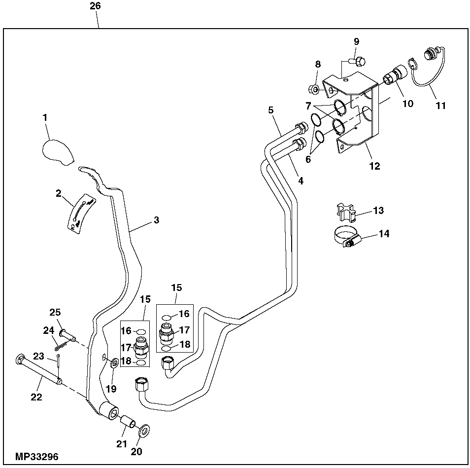

How difficult is it to install?
Will take about 4 hours or so, mostly it's just getting to everything due to the limited space is the problem. Removal of the right rear wheel is necessary, as well as cutting the slot in the right fender.
Below is a picture of what you get in the kit...LVB25569 is the part number for the newer unit's (need serial number to verify which kit you will need)
