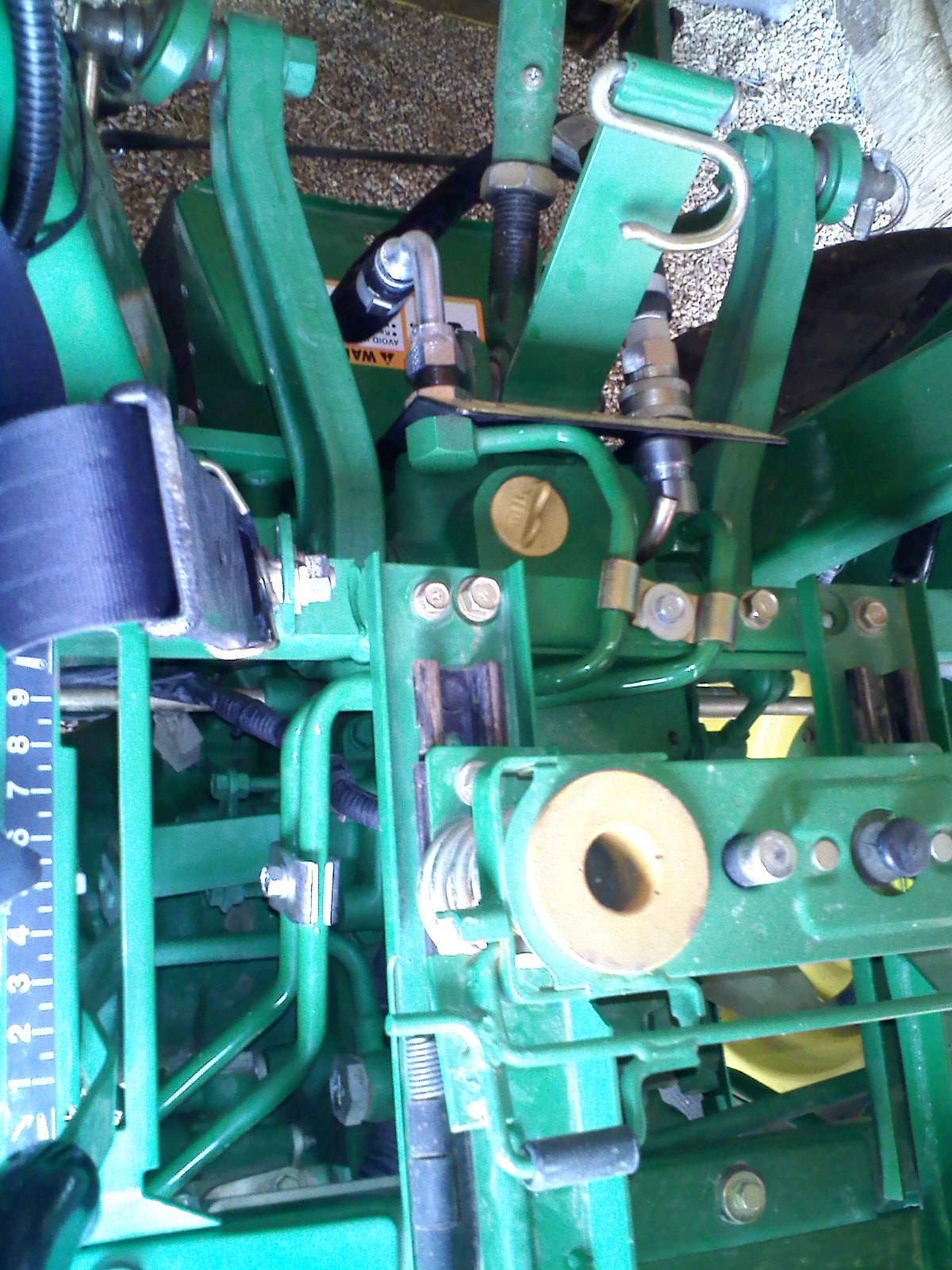

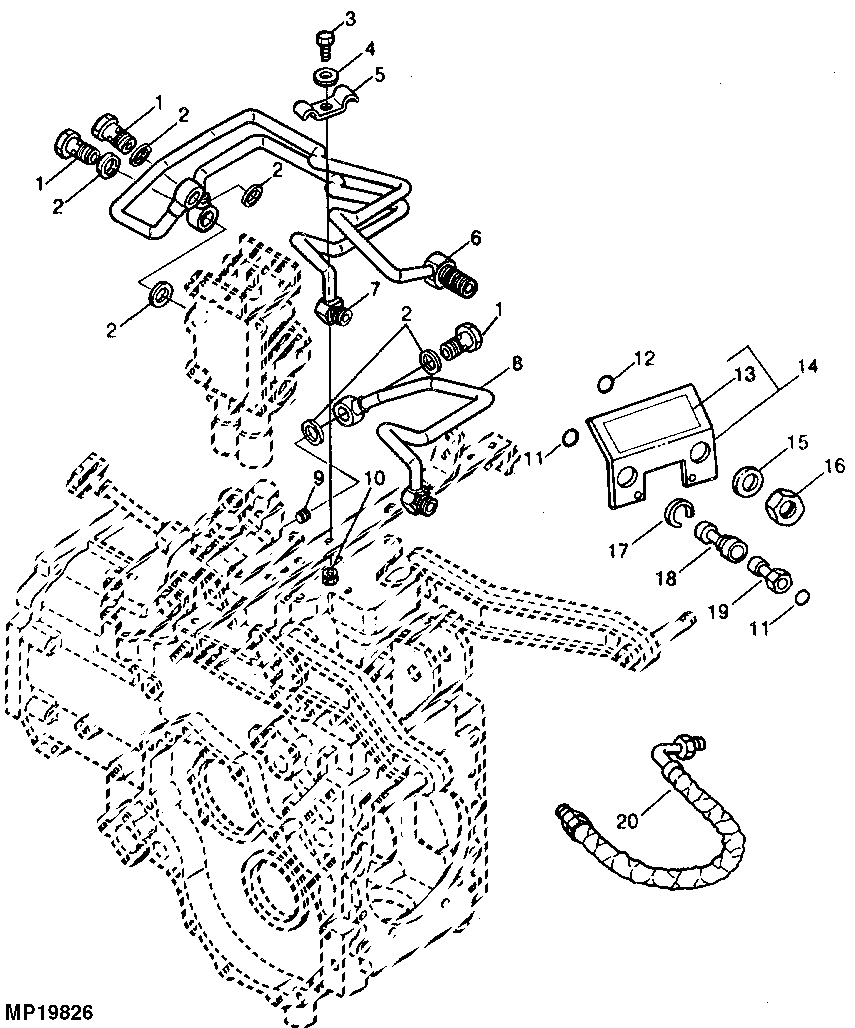

   / Power Beyond #16
I need to install power beyond on my JD770 and the part number provided by my dealer is BM18005 and is no longer available. I think I can build one from hydraulic supply store. I think it is just an extension from the scv to the rear looping back to the rockshaft housing. It has a removable hose which must be i9n place to return flow when not using the power beyond (on No7 backhoe) See the hard pipe fitting pictured.
Am I all wet or not?

Are they looking for BM18005?
They do turn up on eBay every now and then-so you may want to search frequently.
Unfortunately, making your own kit may not be that easy like it is on other models.
You can certainly plug the splitter into the FEL ports and just bungee the joystick over or back to provide constant flow.

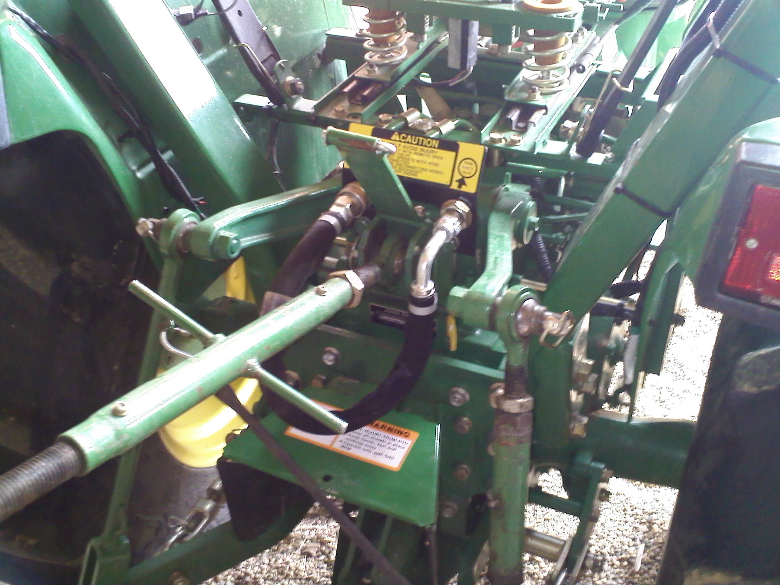

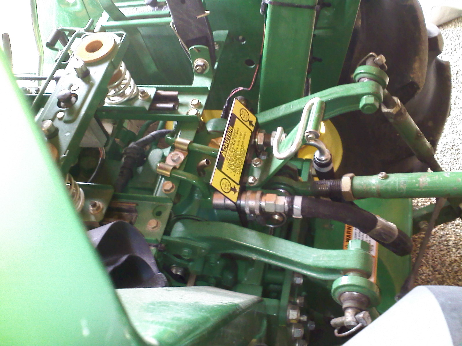

Reidkearl & Hermit43,
In Dec 2010, I ordered the BM18005 (rear auxiliary hydraulics) kit for my JD770 through the parts counter of my local John Deere dealer here in Colorado Springs, CO (Potestio Brothers). It was $298+tax. It took them about 2 weeks to build the kit and they were happy to do it! It came with directions and I installed it myself.
Reidkearl, the JD parts catalog online doesn't say that the BM18005 is NLA. Perhaps a different dealer would build you a kit.
Hermit43, perhaps a different JD dealer would build you the kit for around $300. The BM18005 kit will work with your JD790.
Bruce
