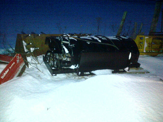

Kioti, I do lawn sweeping in the spring, I have a couple of machines. Steiner front mount and another Dexter front mount that fits, John Deere or Ransomes. I also buy spare units at auctions once in while to have around. I have a skid steer one that has worn out brushes but everything else is on it, I paid under $200 for it and robbed a few hoses off it already. I have one that came off a front end loader and it was complete, I robbed the hoses and connectors off it for my grapple. I have 2 other ones that i also part out. I would never build something like this from scratch, buy used real cheap and make it new again. I have one that some poor guy spent big bucks to build and I bought it for peanuts so I could rob the new brushes off it. Call all the auction and farm equipment dealers around you and see if they have any used units around.

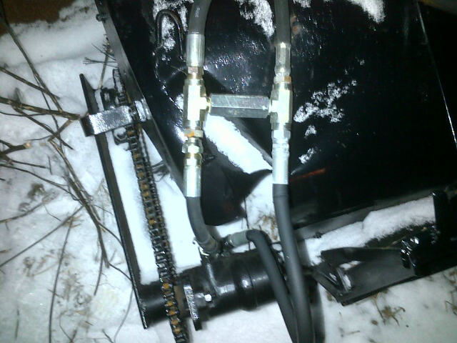

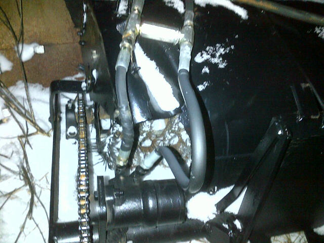

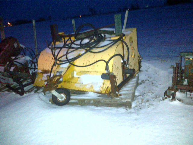

kioti, I took a few pics tonight of the end of mine just so you could see how one looks. The hoses are hooked together, this might have something to do with reverse but I have no idea. Some of the parts look pretty expensive though. Let me know if you need any more pics, these were taken in the dark and the last idiot that owned it painted everything black so can't read numbers or names off anything. This idiot never paints anything.
That is nuts for the used one in your link. I know my buddy Brindley had a few for sale in his yard and likely still has some. Brindley Auction Service

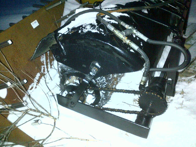

This one was on a pay loader or a backhoe.
I likely have a 100 pieces of equipment laying around, all very useful if I live to be 200 and healthy enough to make anything out of it all.
That is a relief valve. If there is too much pressure on the pressure line, it will dump the excess fluid into the return line to avoid hurting the motor.

Thanks Cantoo. Great pics, that gives me a picture of a chain drive system, close to what I had been thinking. Interesting that there is a relief valve there. Thanks for the link, that place is great, lots of stuff I've never seen before. I've got that one bookmarked!
