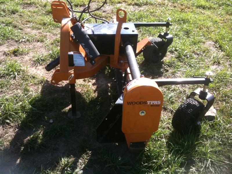

Good timing for this post. This showed up at my place today! Wanna share any of those tips?

Sure, I could try to explain them to you but there's a pretty good 4 part video on youtube detailing it. Here's the link to part
1:YouTube - Woods Equipment - PowerRake Part 1 of 4
It depends alot on your soil conditions, the final grade takes the most patients and practice. Make sure if it sits for awhile to follow the procedure for freeing it up. You can download the manual from the Woods site.

I had already watched those videos about 5 or 6 times and found them great. I was hoping for a more real world look at tips or tricks. Hard to explain but there is always something you find with any new piece of equipment that you should or shouldn't do.
The rake actually came with a manual mounted on a tube on the implement. I have never seen that before. Then again, most everything I have bought is fairly dated.
