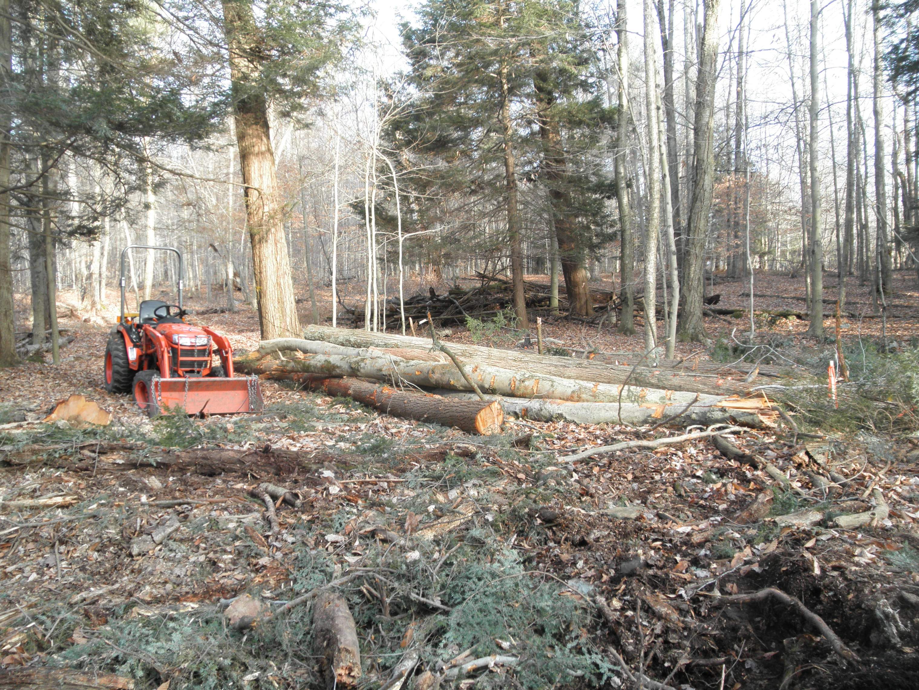

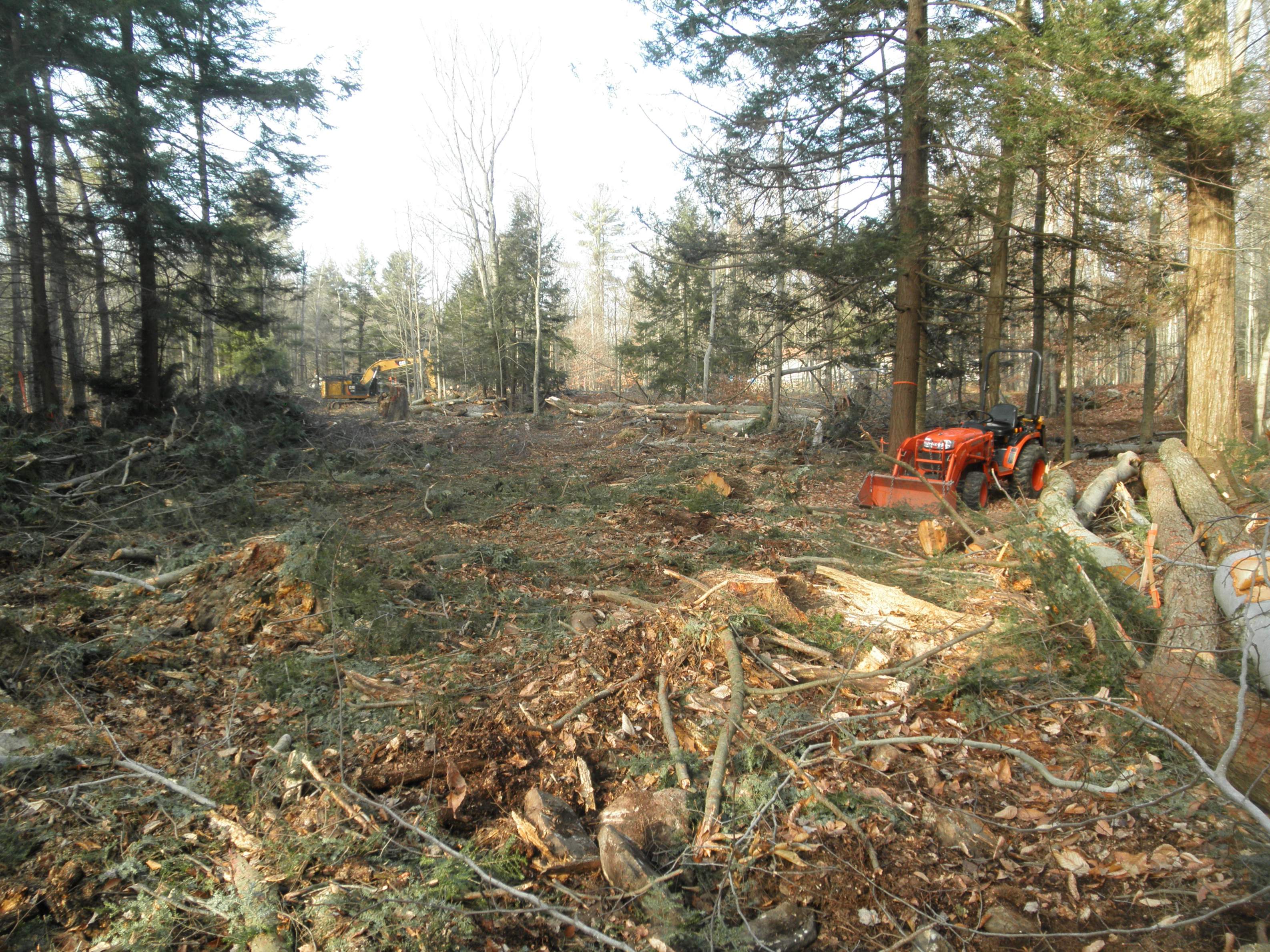

Well after some protracted delays the project has finally started. The feller buncher was busy on another site so the road access was hand cut by a swarm of loggers. The logs are on the ground and an excavator has been clearing the way for the road builders. Worked on loading the logs on the trailer I am still working out how to load them efficiently. My thoughts so far are to work on the most valuable trees first and see how it goes. Made a trial run to the mill with two maple logs and one long beach. Found out that the mill doesn't want the beach so brought that one back for firewood or?? Am I missing something here with the beach?

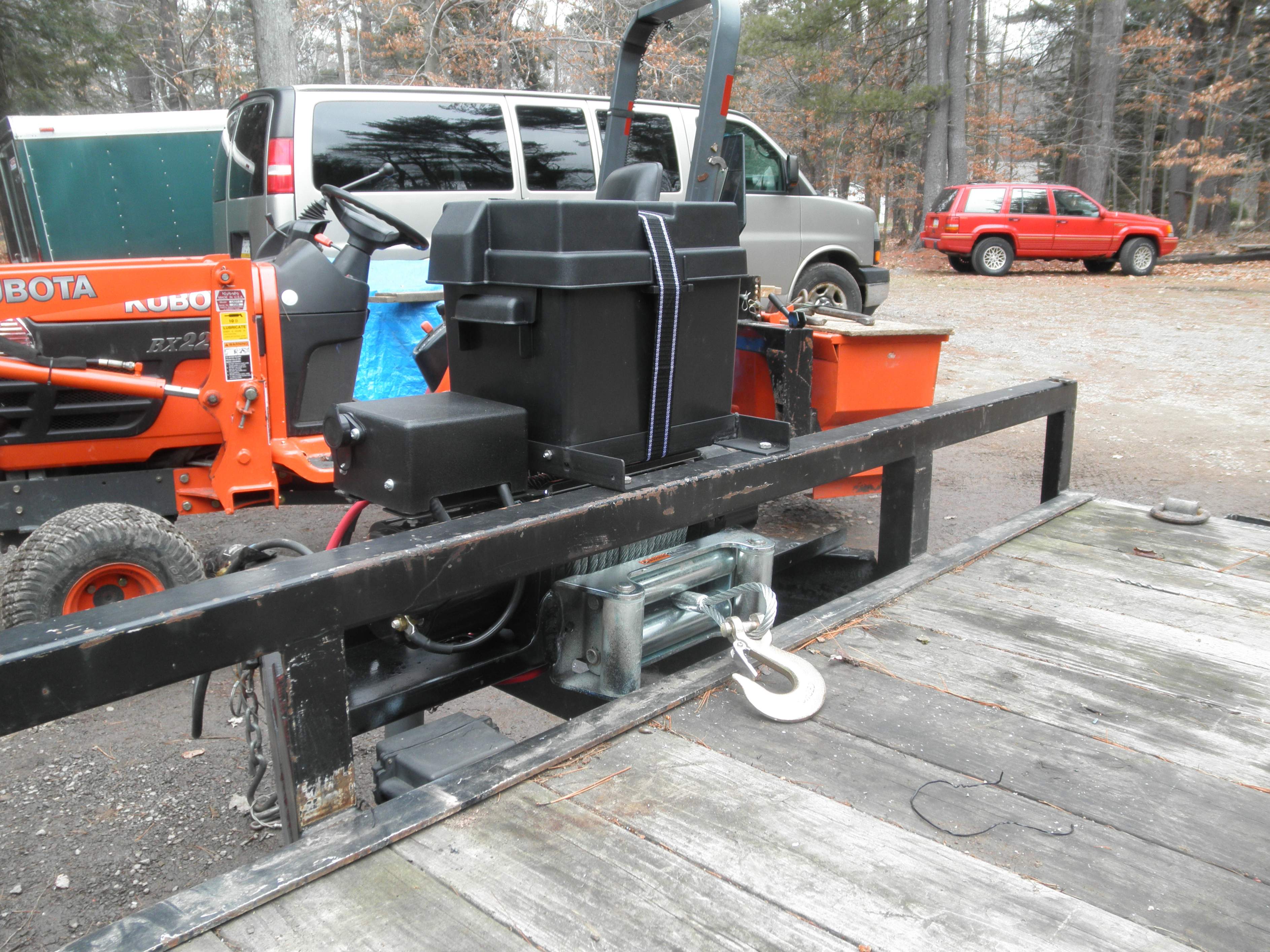

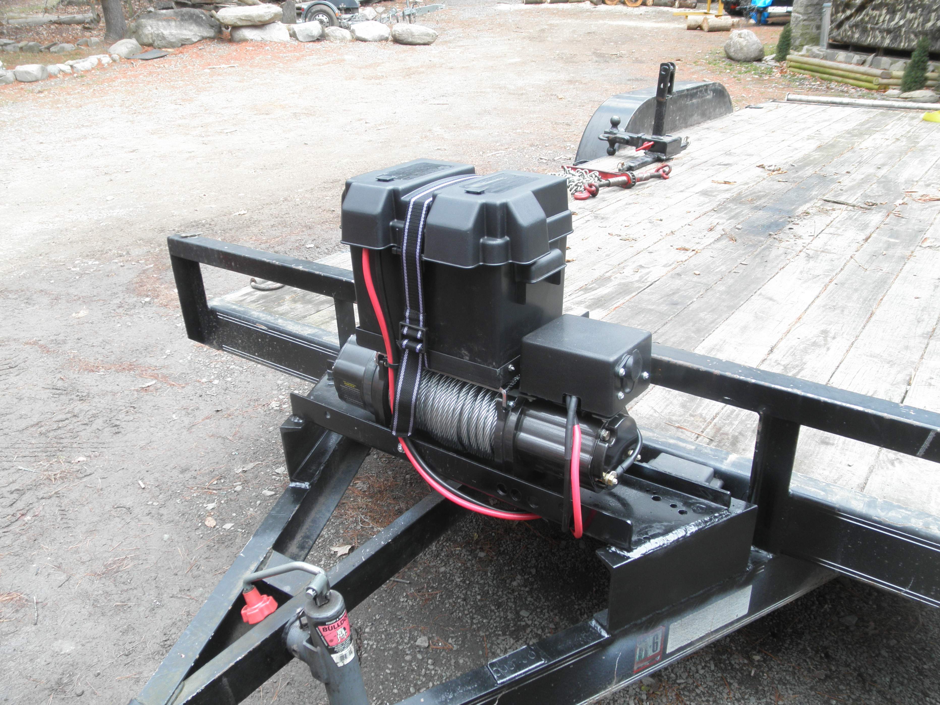

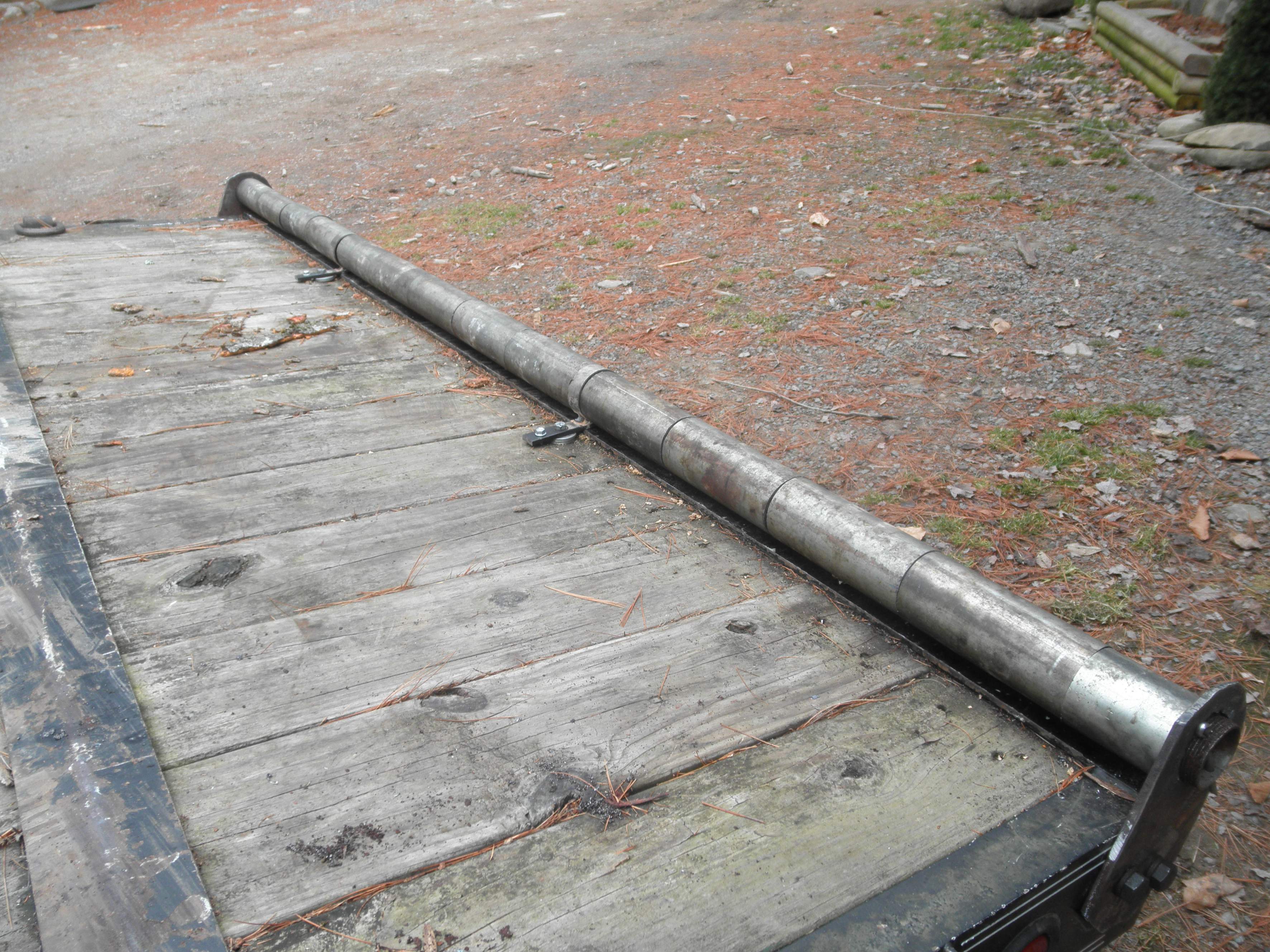

Spent two days modifying the trailer with a winch and roller on the tail to help loading the logs. Will have to wait till the road is a little further along before I can get to the cherry that is at the far end of the road.

Here is a picture of the winch and the rollers I attached to the tail of the trailer.
   / Power Line Logging Project #80
Thanks! Nice rollers. How are you getting the log onto the roller initially?
