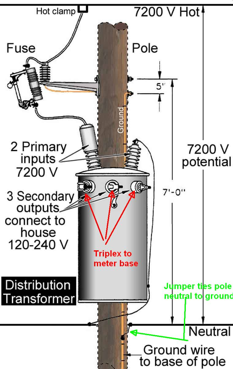

After looking at your photo Eddie you have 2 wires down both different size.One looks like #4 wire the other #1 wire.STAY CLEAR of both until your power company arrives.One could be a guy wire the other Primary overhead wire..

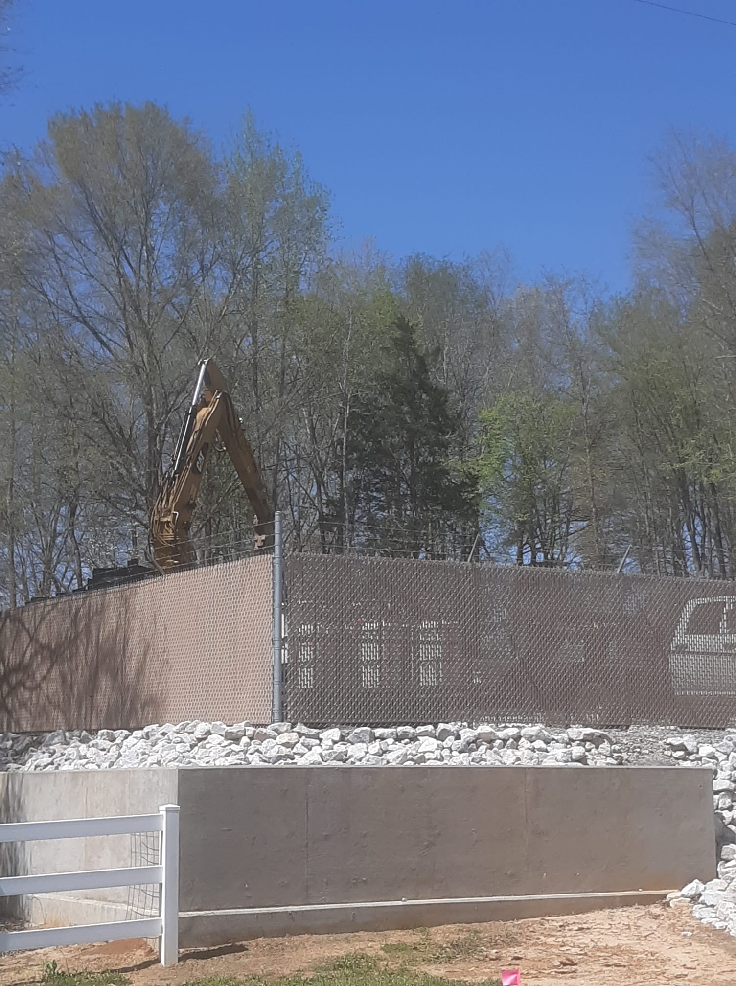

My transformer and meter is about a thousand feet into my land. The line is broken between two poles out along the road. One of them is where the line turns into my land, and the other is down the highway, on the other side of the area where they are working.
My soil is red clay and in the summer, it doesn't work very well for grounding. I had to put in 3 ground rods, ten to 12 feet apart, to get my electric fence to work. But we've had decent rain here all winter, with an inch to half an inch every week, so I think that I have an extremely good ground in the soil right now. Maybe that's helping?
I took this picture a few minutes ago. They are there right now, unloading another trailer with the excavator. I think this gives a good indication of what happened. They are denying it, but that's just being stupid in my opinion. Nothing else could have broken that cable right where their gate is.
I just got off the phone with Oncor. I had a horrible time getting through yesterday, which is why I called 911. The Chief of the Fire Department said he called it in to be fixed. I heard him on his radio doing this, but I don't know if the person on the other end of the radio did anything. When I talked to the lady at Oncor today, she said that they didn't have any record of them calling it in.
She asked for pictures, and all sorts of information about the location of the cable, and how they could get to it. She told me several times not to get close to it, that it could still be very dangerous.
So now I'm still waiting for it to be fixed and hoping for the best.

So that picture does show TRIPLEX going to the house service.

The power company guy showed up around 4:30 and looked at the broken cable. He agreed that it looked like they broke it with the excavator, but since nobody is admitting to it, it really doesn't matter how it broke.
He said that since it's the neutral line, and all the poles are grounded, that it wasn't a big deal. He also said that they have a lot of lines without a neutral line on them right now. "Just being honest" was his next comment. When I asked about houses burning down and electronic devises dying, he said that wasn't a concern because all of the poles where grounded. There are four poles after the break in the cable.
His plan is to talk to his boss and let him decide what to do. He doesn't know when they will be back, or when they will fix it. It's noted that there is an issue, and I guess they will get to it when they get to it.

The pic I was referring to was from Moss.
