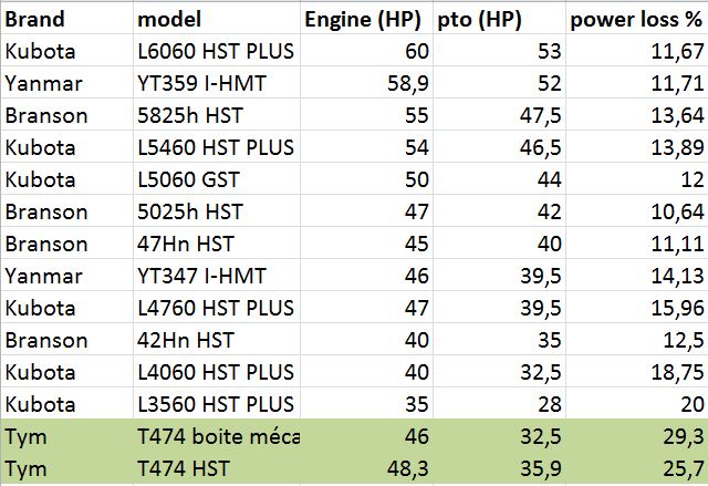

Good morning,
Yesterday I have made this excel sheet to have an idea of the power loss between engine and PTO.
I took the datas from official specifications. Some of these tractors are from european market and others from US market.
I hope I did no mistakes.
What do you think of this ?
Thanks for your help.
Phil

It's not clear on what "rating" you're using. There could be a substantial difference between Maximum Engine Horsepower and Engine Horsepower at rated PTO output speed. If PTO output speed of 540rpm is achieved at 1800rpm engine speed and peak engine horsepower is achieved at 2100rpm, of course there will be a loss on PTO power. I would bet the gap is reduced if the engine is run at peak output rpm. The problem is the PTO rpm may not be the standard 540rpm. :cool: (Ignoring the other speed "standards".)
There's more to it than just comparing numbers. Nice chart though. ;)

OP, you got it right. Tym's are known for this discrepancy. You're not the first one on this forum ho found this. But there is an error on the data sheet of Tym that even dealers are not aware of. One of the TBN useres was insisting and some higher Ups at Tym confirmed a lower loss to the PTO. I think this also applies to some Branson models.

Good morning,
Of course, you can imagine that I don't have a test bench at home to measure those numbers.
They come directly from the importers specification datasheets that everybody can download from their websites.
I guess there are in US some imposed industry standards when measuring the power of an engine or the power available at a PTO. (which one ? SAE, DIN, ISO etc.....?).
My mistake was certainly to mix, in the chart, european models and US models as the industrial measuring standards may differ from one side of the atlantic to another BUT : european Branson F47 is US Branson 4815 and european TYM T475 is US TYM T474 etc...
It stays IMHO that the power loss computed FROM THE IMPORTERS DATA for TYM is huge.......
Really a Tym official would be welcome if he could clarify this point.

I have fresh data from a TYM technical document for TYM T393, the former european version of TYM T394 but without DPF.
Anyway, the numbers are interesting :
T393 gear : engine 38,3 HP PTO 30,1 HP power loss (38,3-30,1)/38,3=21,4 %
T393 hst : engine 38,3 HP PTO 28,6 HP power loss (38,3-28,6)/38,3=25,3 %
I don't say this, TYM wrote it !
So our bavarian friend from Manitoba was 100 % right !
Phil

Phil, keep in mind that the European Branson F47 uses a 3 cylinder Turbo engine, while the 4815 in the US uses a 4 cylinder engine, no turbo.
Regarding the pump, since we're speaking about PTO HP, on TYM and Branson, they use the power steering gear pump to engage the clutch pack. This applies to most brands actually.

Interesting - the Op Manual for my 2009 Kubota M6040 ( Hydraulic shuttle, I.E - geared ) says - - 62 engine hp, 57 PTO hp.

I'm with K5. We can't really focus too much on any of these numbers. Most are just theory and not are actually tested.
For instance, TractorData specs for the Branson 3725:
3725R - Engine HP: 37HP - PTO HP: 33HP
3725H - Engine HP: 37HP - PTO HP: 32HP
I'm sure this is not accurate at all.
If the tractors were properly tested, I'm sure we would see a significant decrease on PTO HP over all brands.
