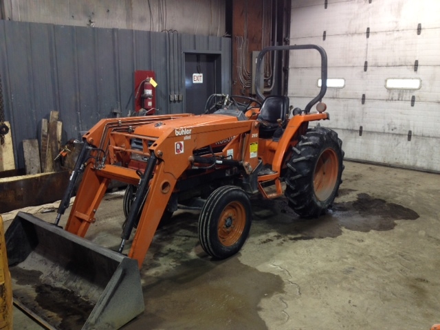

I just recently purchased a Kubota L3300 used tractor that is about 33 HP and has simple 2wd. I'd like to use it to plow about 2 acres of land.
What tires have ye, on the L3300? Narrow, barred, R1 ag tires? Fat R4 industrial tires? Turf tires?
I believe they are ag tires but here's a picture of the tractor so you can see for yourself
   / Power Required to Pull a Two-Bottom Moldboard Plow #30
Ahhhhhh…..picture.
Yes, I would say ags. Certainly best for traction when plowing. Are the rears filled with air or liquid?
