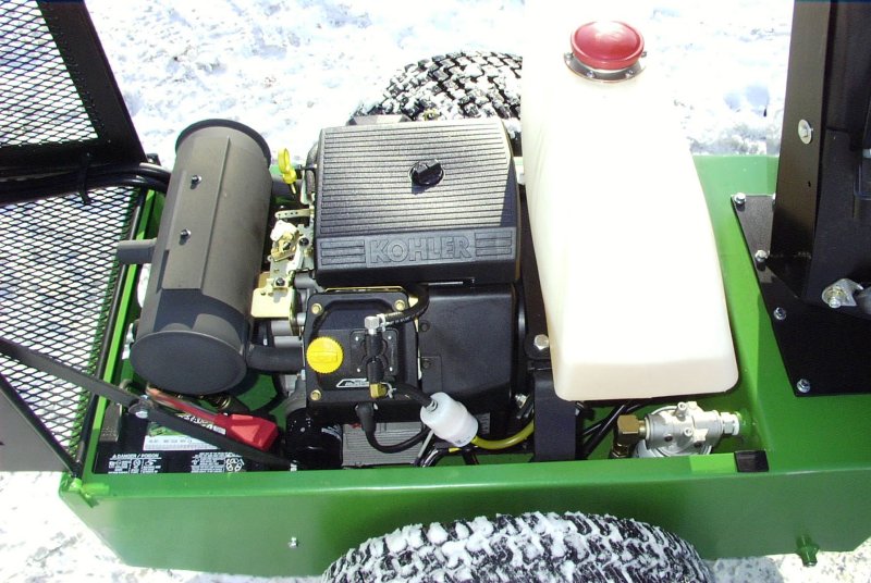

Here's a picture of my PT425 engine compartment on the right side of the unit. To the right of the picture is the hydraulic filter. You can see it is tucked down in there very far. To the left of that is the plastic fuel filter. The silver ribbed plate to the left of the fuel filter is the engine oil cooler, which is something else that has to be removed and cleaned as part af a regular maintenance program. To the left of the engine oild cooler is the engine oild filter. It is black with white writing. And, finally, to the left of that is the battery. Hope this helps.

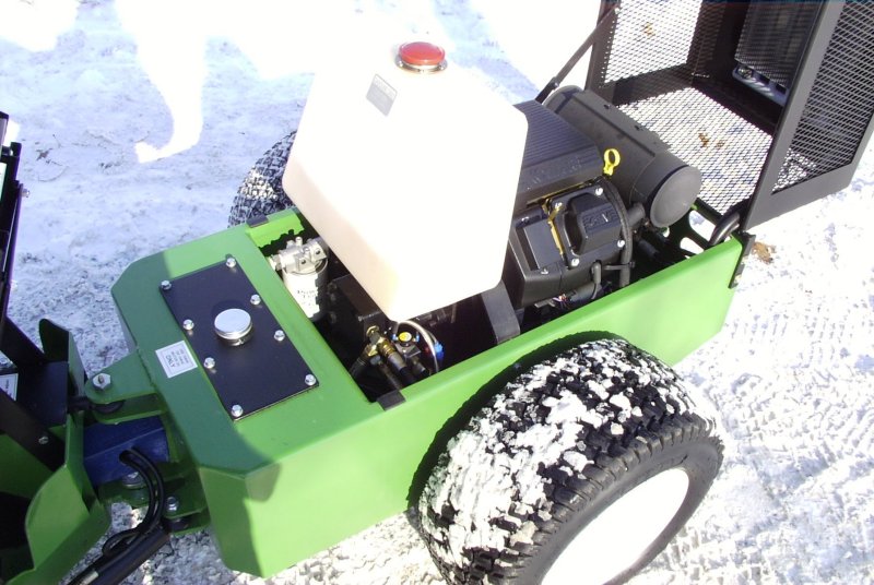

Here's another pic of the engine compartment from the front left of the unit. You can see the hydraulic filter tucked in under the front of the gas tank.
Hey, looks like I'm getting low on fuel. Better top off the tank /w3tcompact/icons/laugh.gif

You did'nt get rid of that wimpy plastic fuel filter yet? I had absolutely no problems changeing the filters or the oil on my PT425. I thought it was easy, the way the filter is located you do not spill any oil. I like the drain hose and valve for the motor oil. I clean my oil cooler with simple green and a garden hose on a regular basis, actualy I clean the whole engine compartment that way. I drive old cars and hate working on greasy motors so I keep them clean. I think the hydralic oil filter placement seems out of place because everything else on the machine is so well placed (like someone who drove a tractor actualy designed it). I thought it looked hard and out of place intill I changed them.
PTRich

I know, I know. I'll put in a fuel shut off valve when I change the filter. And I too like the drain hose for changing the oil. I have noticed that quite a bit of debris accumulated under the engine when I was brush hogging. I was able to suck most of it out with a shop vac. It is still kind of tight down there to get my arm in to clean the bottom of the engine compartment. I was thinking of using a degreaser with a small spray bottle, the rinsing the same way. How do you get in there to clean it?
