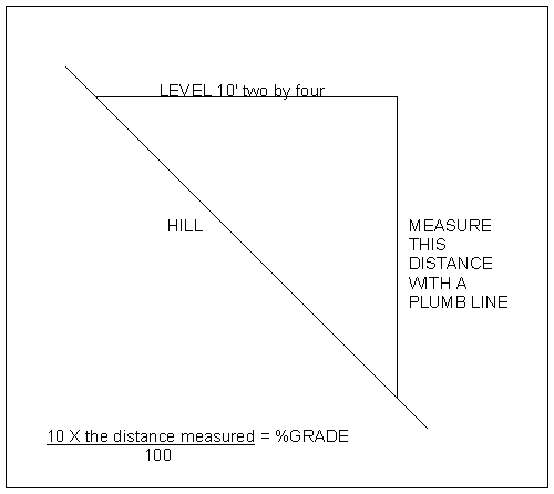

<font color=blue>I also noticed that the front half of the tractor seems to be sliding sideways (dowhill) as i move across the hill. I'm not sure why. </font color=blue>
That is an interesting comment. I've noticed that on sideslopes where I lose traction due to snow or wet grass, the machine tends to want to crab across the hill, with the front wheels pointed slightly up hill and the rears silghtly downhill. The more I want to correct it by steering uphill, since the unit articulates in the middle, actually agravates the situation.
Just how steep is this slope? Here's a handy diagram to help figure it out.
