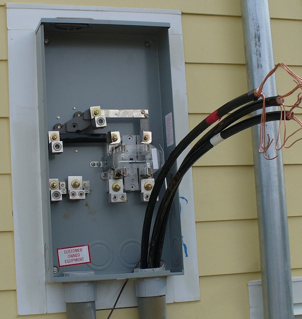

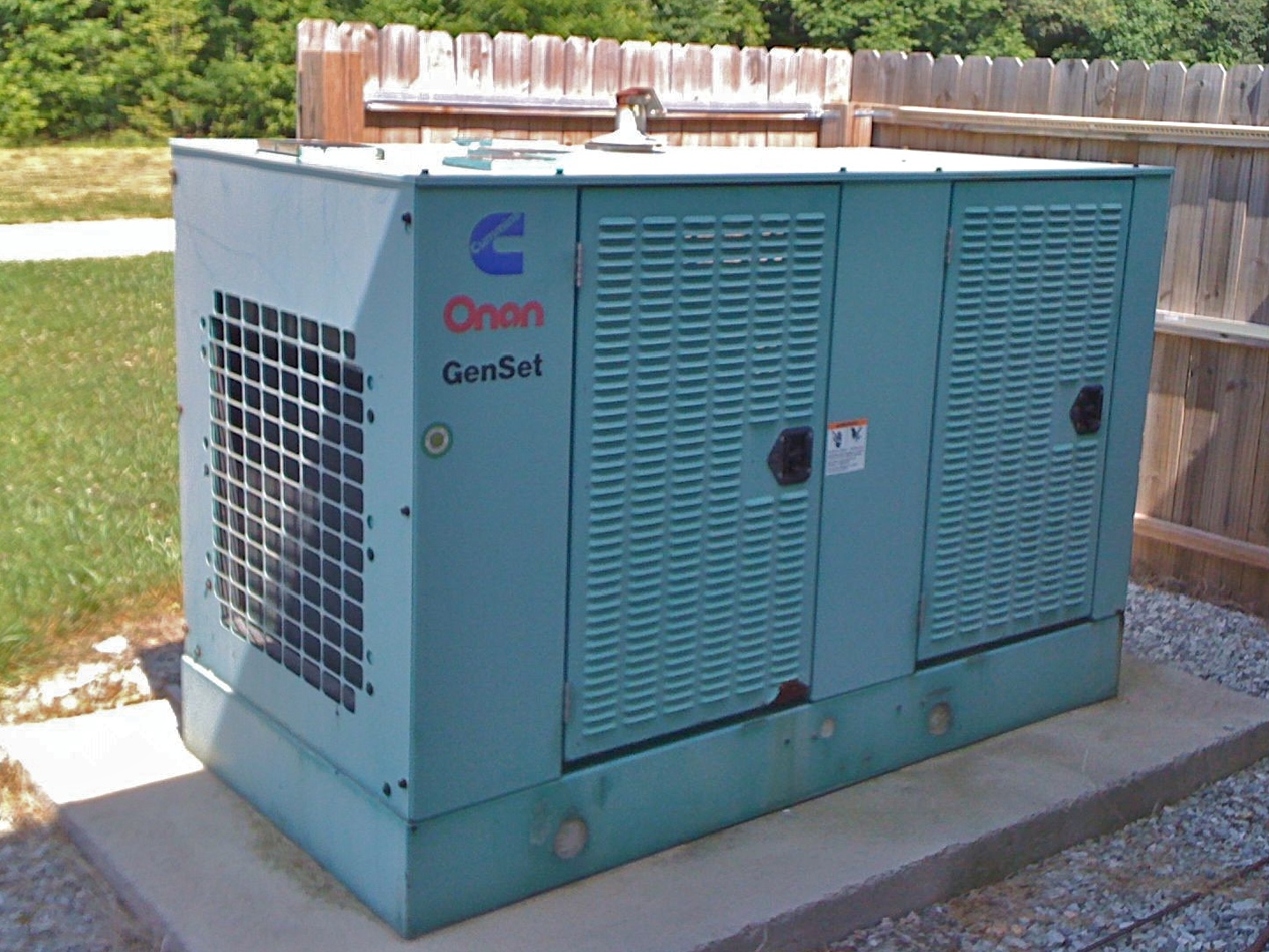

For single phase residential service, the "high voltage" shows up at the transformer on two wires. I have buried service. The 7.5KV has two conductors that come from the "wires on the poles." It's a coaxial sort of cable, with the outside wire being close to ground potential- the insulation to the center conductor is far thicker than the insulation on the outside. Different distribution schemes are in use, but, the high voltage side of the transformer (the primary) is a two wire connection.
After going through the step down transformer that takes the 7500 volts and makes 240 volts (on the secondary coil), there are three terminals. At the transformer pad, the center tap (or center terminal of the three) has a connection to a ground rod at the transformer. Three wires come into the house, you can see the three wires that go from the meter base into the house in the 1st picture.

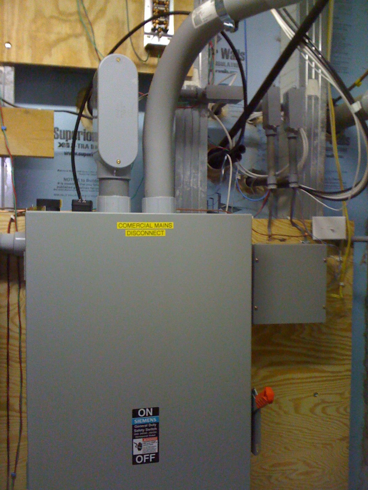

These three wires make their way into the basement (under the garage, the conduit they are in is in the ground) and go into a 400A disconnect. The three wires come into the top via the 90 degree fitting. The disconnect switch also has a wire that goes to the grounding system for the house- ground rods and copper wires in the earth. See 2nd picture.
Inside the disconnect switch the center tap wire (which I am purposely not calling ground or neutral) turns into two wires- ground and neutral. So at this point and only at this point both wires are connected to the ground that goes into the disconnect switch from the earth ground. From here on out, all the electrical in the house is a four wire system.

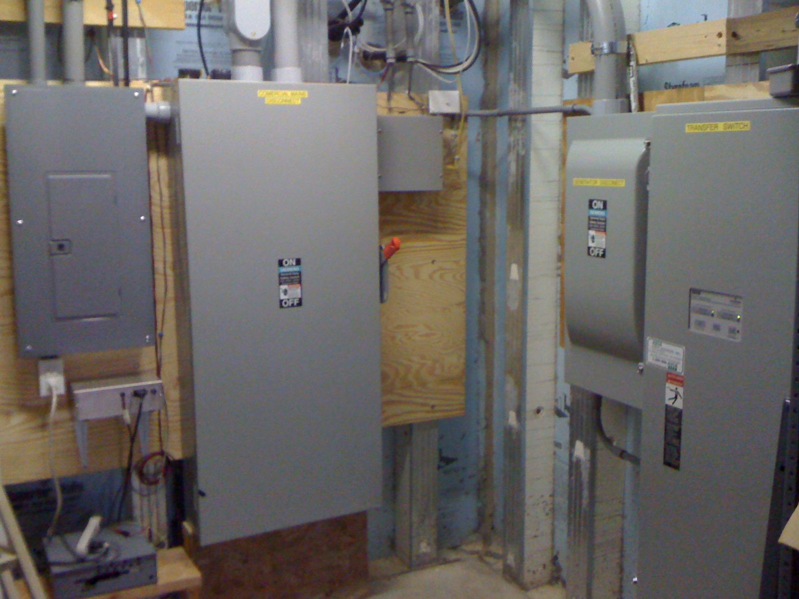

The 3rd shot shows the mains disconnect. To the right of that is a breaker panel that is before the generator transfer switch. It has some big loads on it like the resistive electric backup for the heat pumps, and the 100A service to the outbuilding (tractor garage). It also has the block heater for the generator.
On the right, you can see a 200A disconnect for the generator. In the same way that you need disconnects on outside heat pump compressors so that you have a disconnect right there at the work area, I have to have a disconnect for the power from the generator. At the far right is the 400A transfer switch. It is fed from the commercial mains disconnect and the generator disconnect, and it's output runs off the the main breaker panels for the house.
Throughout all the wiring after the big disconnect switch, ground and neutral are kept separate and are never switched. All manners of switches, disconnects, and breakers just work on the one (120V) or both (240v) of the two hot wires that came from the secondary of the transformer pad.
There is a shot of the generator (45KW - I don't suffer lack of power lightly). There is code for how far away it has to be from a window or opening in a house, and this is far enough way. It is also on the opposite side of the house from the master bedroom for noise reasons.
So there's a setup of a fully automatic system with whole house backup. Yeah, it's some bucks but the goal is that everything happens automatically and does not have to be done by someone who knows what breakers to throw and how to plug in a suicide cord into a dryer vent etc, etc. Note that a more common configuration for residential is a 200 amp service, disconnect, and transfer switch. All this is very expensive to retrofit, the ability to do it during construction is a big win.
When the transfer switch is thrown, or the disconnect is cut off, the two hot wires are not connected to the transformer at the pad. The center tap for the secondary winding goes to ground and neutral in the house. And it has the connection to ground at the pad. So everything and everyone is save because you can't have a 1 wire circuit, it takes two to tango. And if the one wire neutral circuit opens, well, it really wasn't a circuit that could pass power in the first place. The windings on each side of the transformer are isolated- the goal of a transformer is step-down and isolation. So having one wire (the center tap) connected to a winding means you can't pass any energy. Don't flame on exotic "What ifs" like someone wired the hot terminal of the generator to the neutral during a power fail by mistake and the ground failed because a chipmonk at the wire... I'm dealing with systems that were properly installed and normal faults like opens and shorts.
Open neutrals into a house when the two other lines are connect is a big problem, that's more or less been discussed. I have MOVs (kinda like whole house protectors) in the breaker panels. Inside the house any 120V device that's not a lightbulb is on a protected strip with a fuse or breaker in it. That's my open neutral plan.
Pete

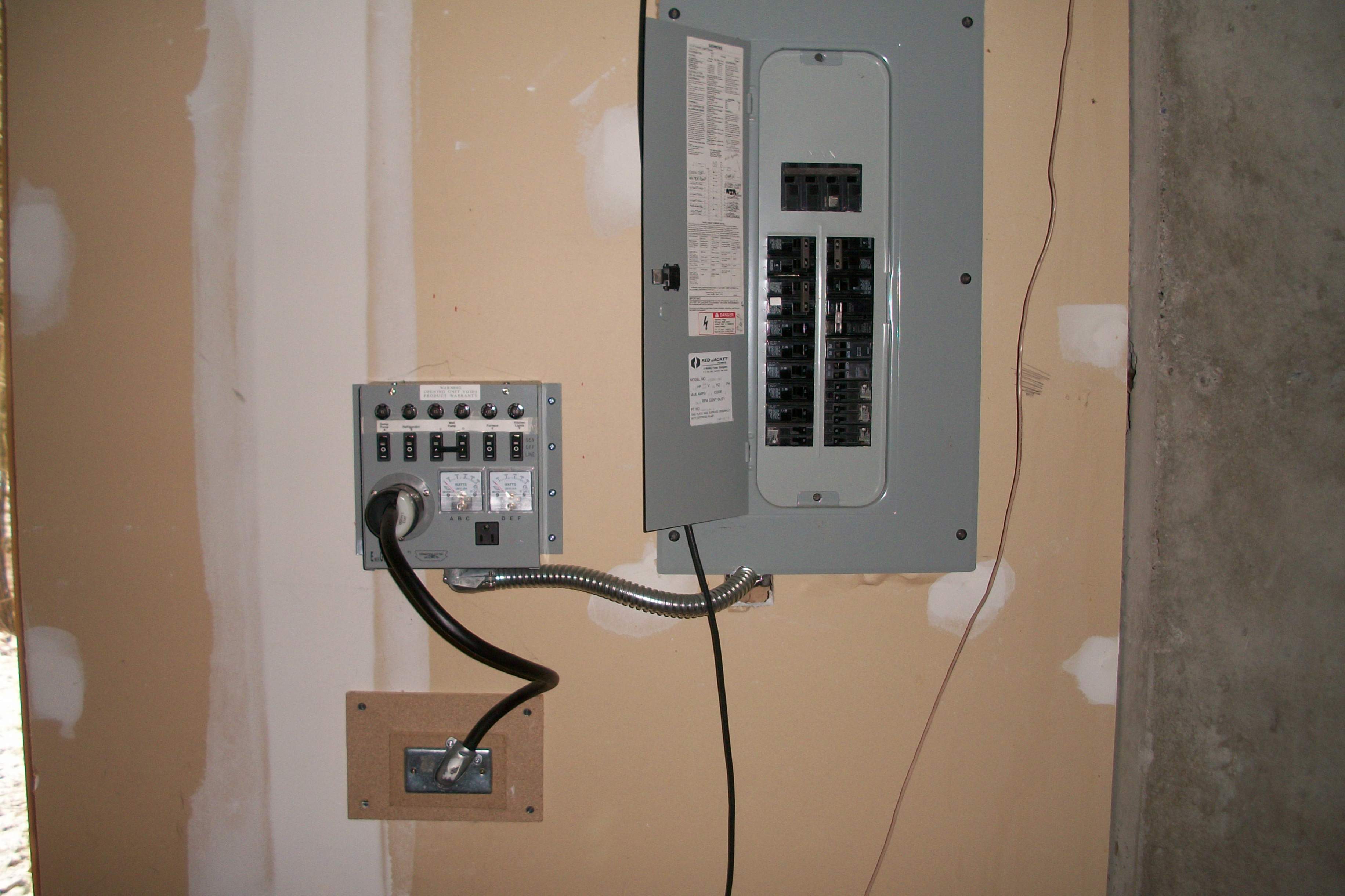

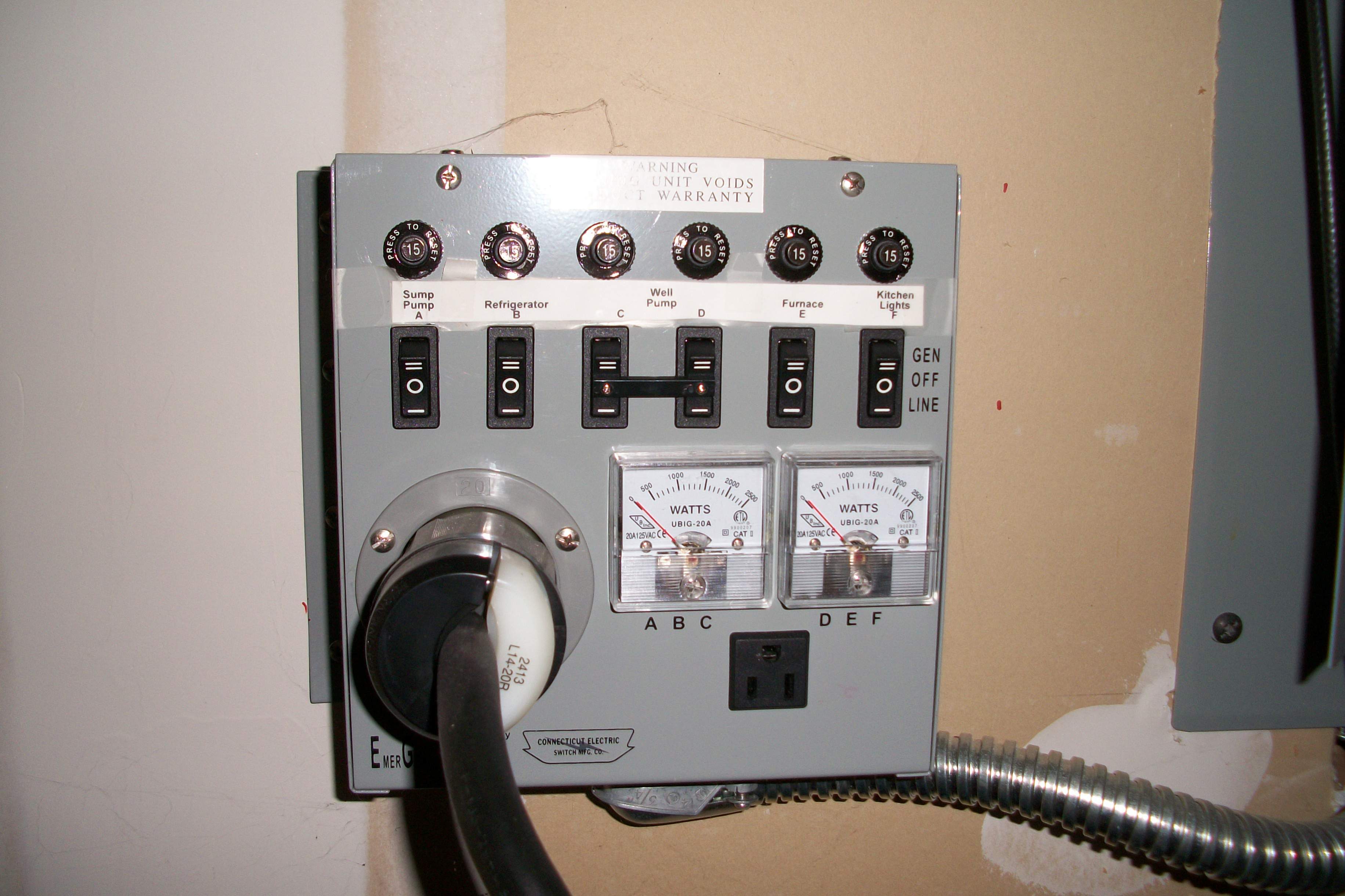

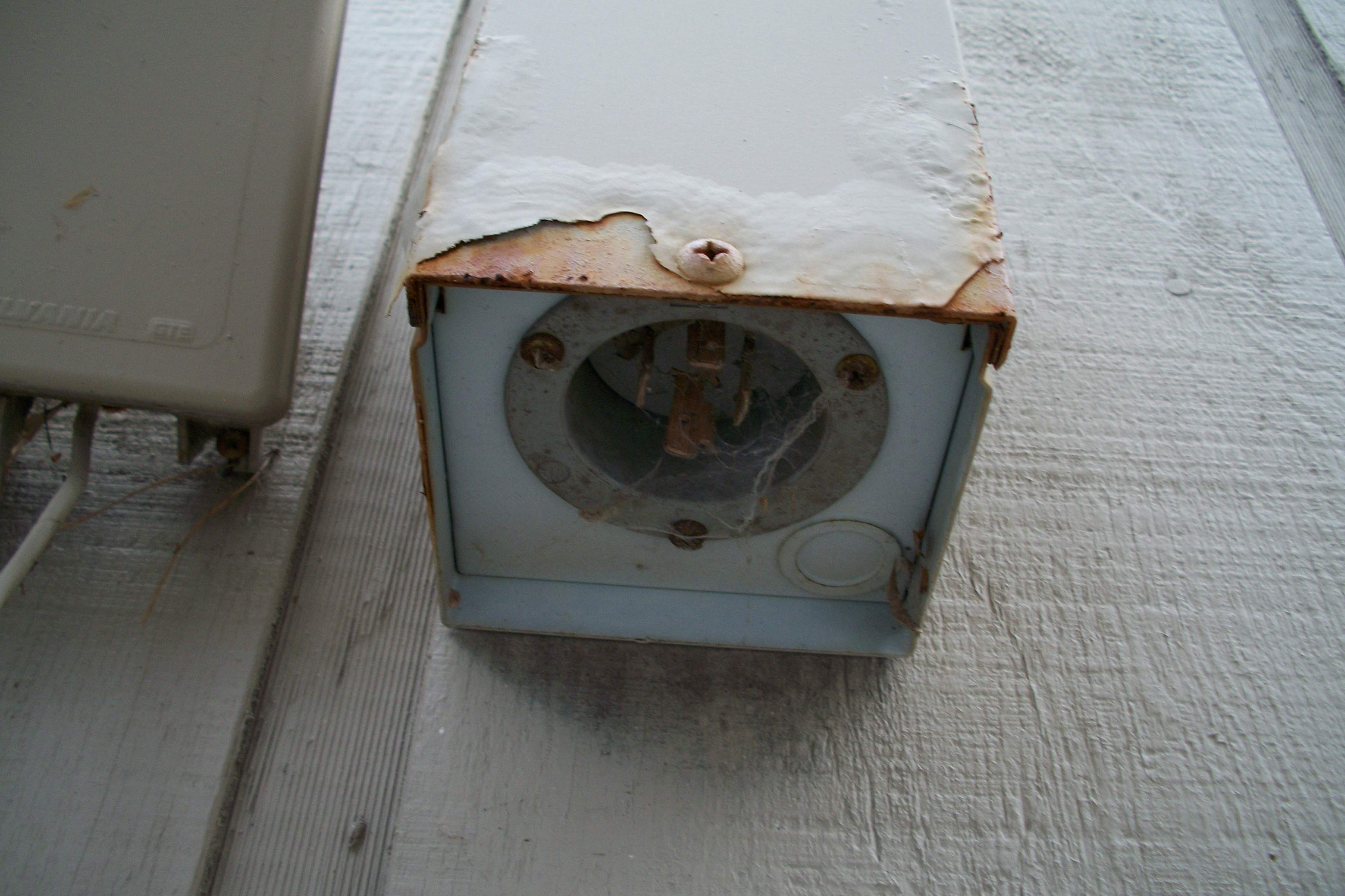

I purchase this unit from Home Depot 10 years ago for about $160. It came with video on how to install. I added a permanent extension cable through the outside wall of house. This eliminated the extension cord to generator having to be run through door when needed.
The generator (8000watts), switching box and extension cord came to less then $1100 and it was a DIY project.
It doesn't power whole house and it is not something the wife feels comfortable hooking up. We use it about once every 2 years. It would be nice to have whole house unit with automatic switching but for $1100 it works.
