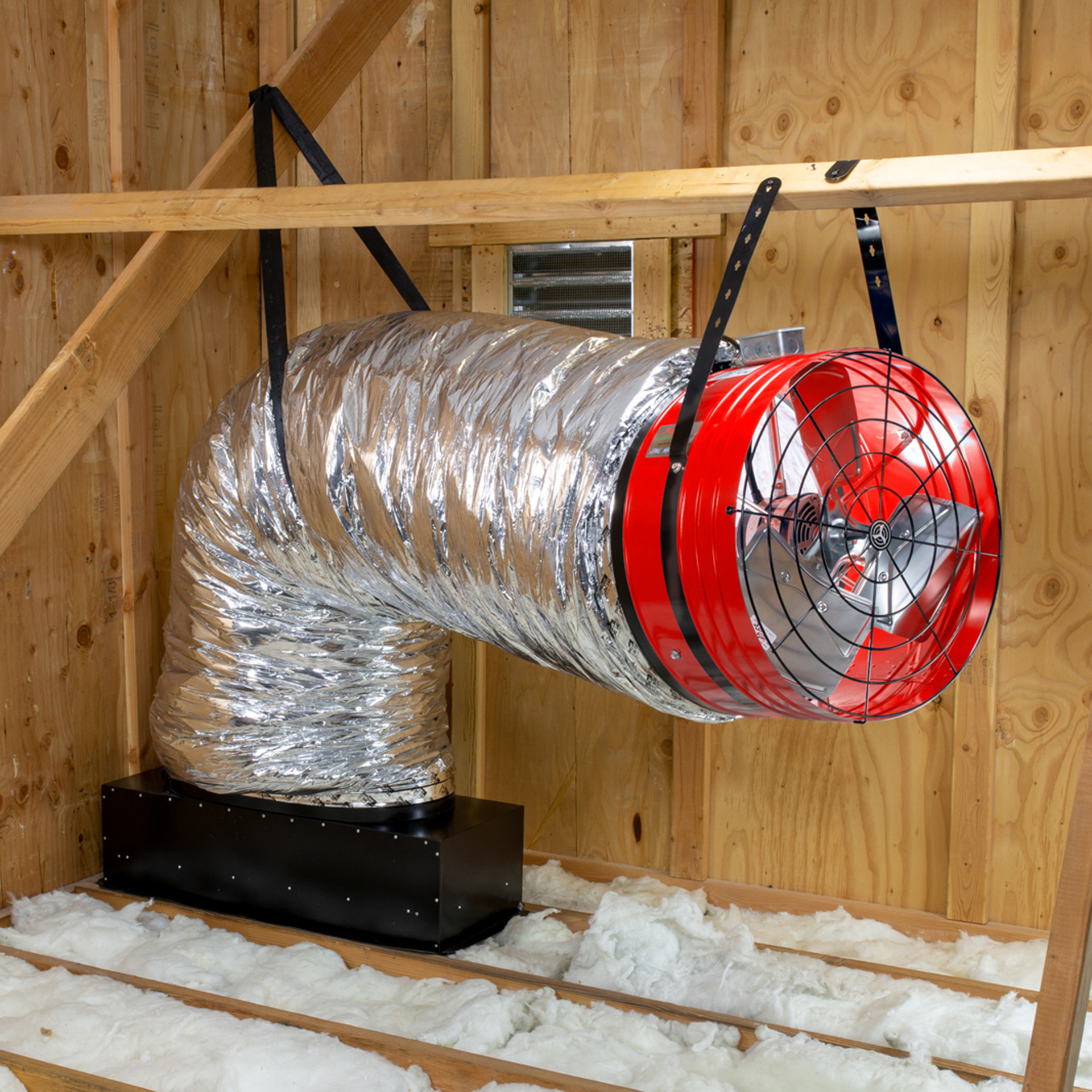

At the risk of derailing the thread - what sort of fan do you have? Our house has an effective fan, but it's in the hall right next to our bedroom and even with it on low (I have a dimmer-like switch which is appropriate for motor drives) it sounds like a hurricane. I'm definitely replacing it this spring, but wondering what to replace it with!
We have the noisy one as well - bought at a big box store. It is installed in our hallway ceiling. They make others - more expensive - baffle type and those are supposed to be quiet. Even though ours is noisy we find that we only need to run it for 10-15 minutes to push the stale hot air out of the house and out of the attic and bring in the cooler outside air. Also, I have heard of a system where the fan is in the peak wall of the attic with duct work to a vent in the ceiling. Supposed to be quiet but I am thinking that system would not push the hot air out of the attic - unless I am misunderstanding the set up.
   / Power Wall Pricing #72
Perhaps you are thinking of the "Quiet Cool" brand of attic fans that are suspended to lessen noise?
They work by removing the warm air from the living spaces and dump it into the attic, where you need a gable or eave vent. Using a suspended fan assembly and a flexible duct reduces the noise.
All the best,
Peter
Peter, that looks what was described to me as a better, and less noisy option. I did not understand that the fan was mounted that way so that hot attic air would also be evacuated. I was assuming the fan was in the attic gable wall and was a closed system between the house and the outside. I like this a lot and should lessen any noise substantially. I assume you would still have louvers on springs that would only open when the fan kicked on, but that noise would be minimal and only for a second or two on starting and stopping. I have a friend who has a tricky attic and house configuration that would not accommodate the kind of fan I have but this might work for him. I will pass it on. Thanks.
My daughter installed one of these in her house and she says it's a lot quieter than ours, but they don't sleep right next to the wall vent (hers is mounted in a mostly finished attic which has some unfilled attic space to vent still). I'm contemplating getting one - or possibly two smaller ones and mounting one at the other end of the house to keep each one doing less for hopefully less noise (though a bit higher cost)
