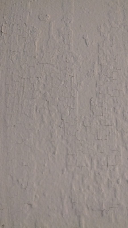

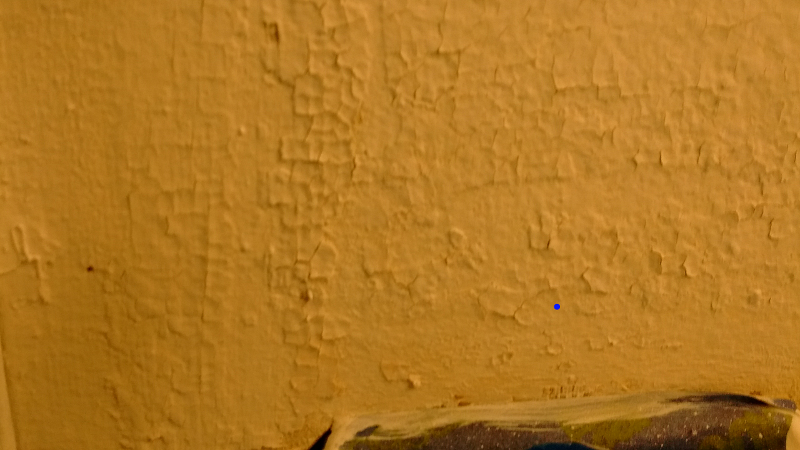

I'm working one now. Wallpapered and refloored a small bathroom over 30 years ago. Didn't take into account that 4 teenagers (2 unborn at that time) would routinely shower until the water turns cold. Resulting humidity levels caused a small corner of wallpaper near the ceiling to peel back from the wall. With children moved out bathroom went unused. To make her mother happy, daughter pulled all the wallpaper off the walls, while we were gone for a month.
No wallpaper stripper, just brute force and a spackling blade. Where the drywall wasn't stripped of it's surface the 30 yr old wallpaper glue was left in a waffled surface about 1/8 inch thick. She then painted over it twice with a thick paint.
Resulting painted surface:
The resulting surface, where it was not gauged down through the drywall paper and deeper was difficult to remove. I finally found if I put CitriStrip on it and let it soak in for 12 hours I could get down to drywall after about 3 applications.
