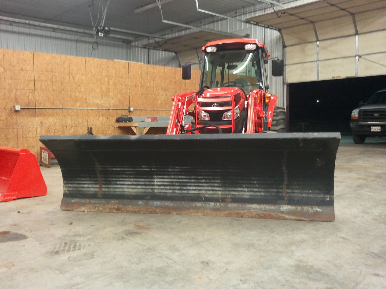

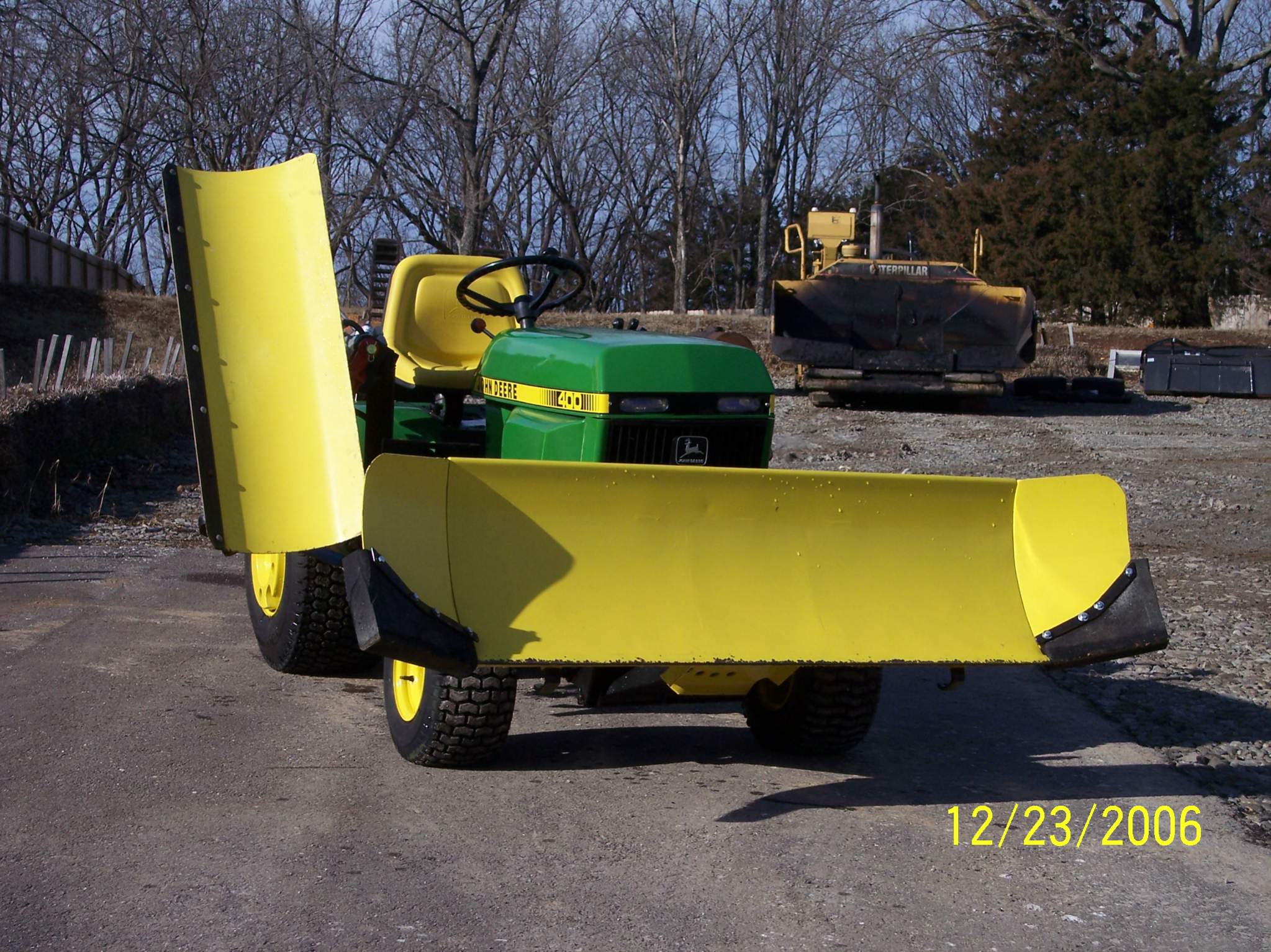

Ok, I know that there is no perfect tool for every application. And generally the more things you try to make a tool fit, the worse is gets at doing any one job well. For example a crescent wrench doesn't fit anything.
I know my containment plow moves more snow and cleans up trails better. I know that my angle blade opens up long driveways, lanes etc. Both do a decent job back dragging from garage doors.
I have had fixed wings on many plows before, and loved them. They do get in the way from time to time as well. So, I was wandering, who of you out there have a Blizzard Power Plow, or MachinAbility power side wing, or some other hydraulic powered winged snow plow? What are your thoughts on reliability, efficiency, cost, etc.? How does your tractor handle them? Are they super heavy?
Oh and I need pix too. We all love pix.

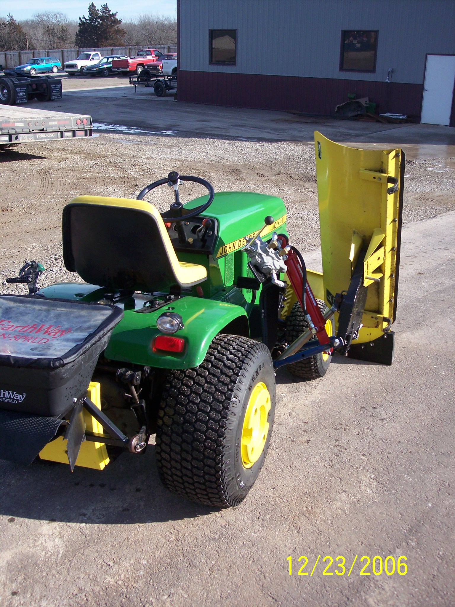

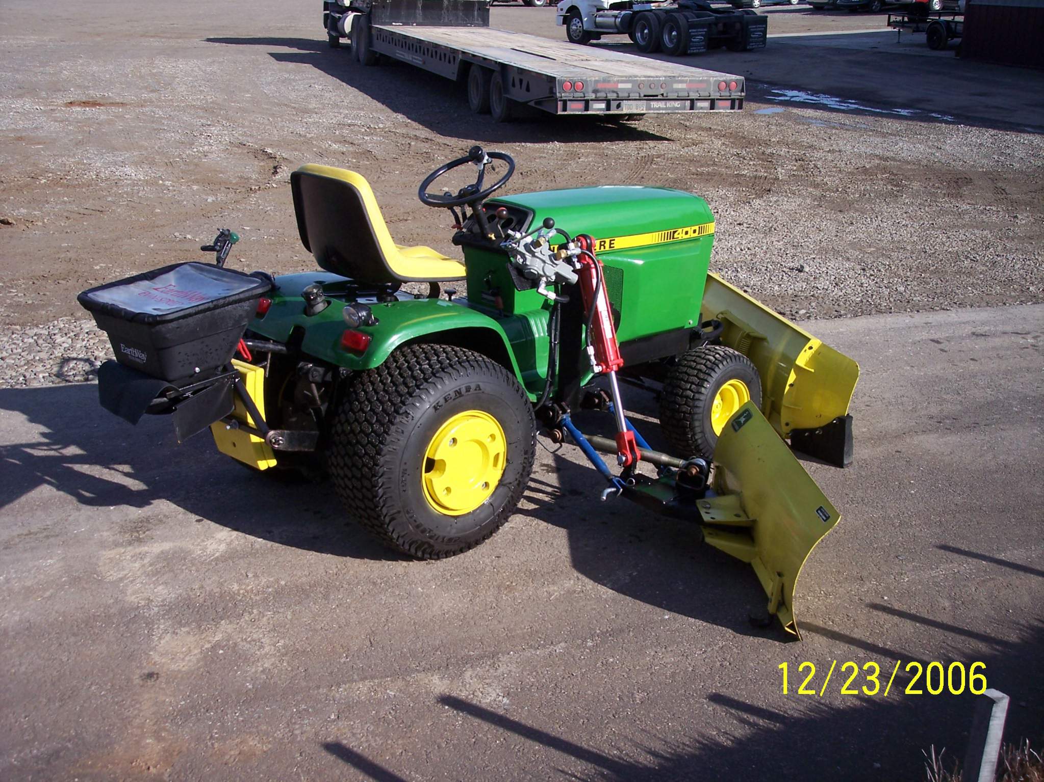

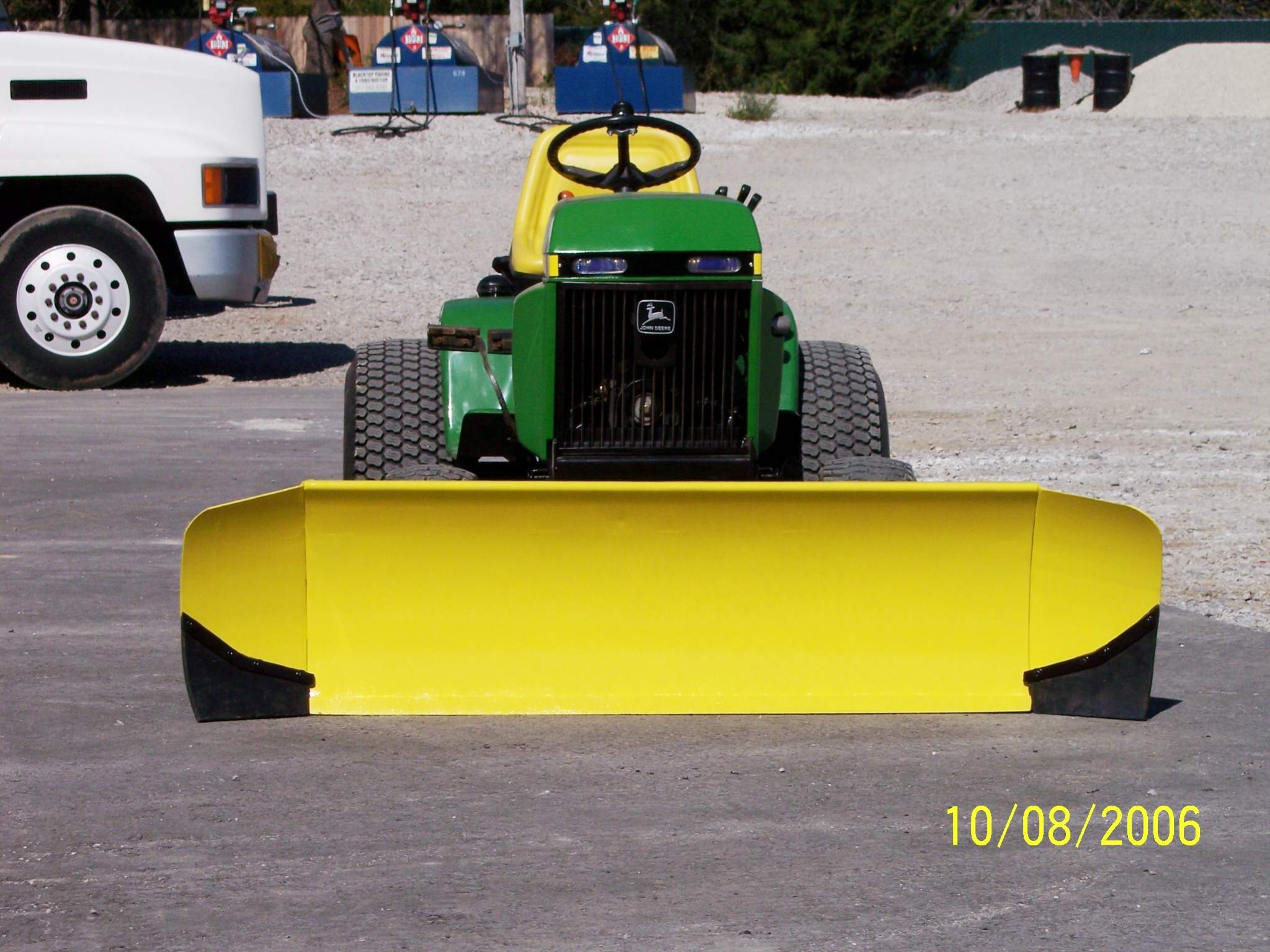

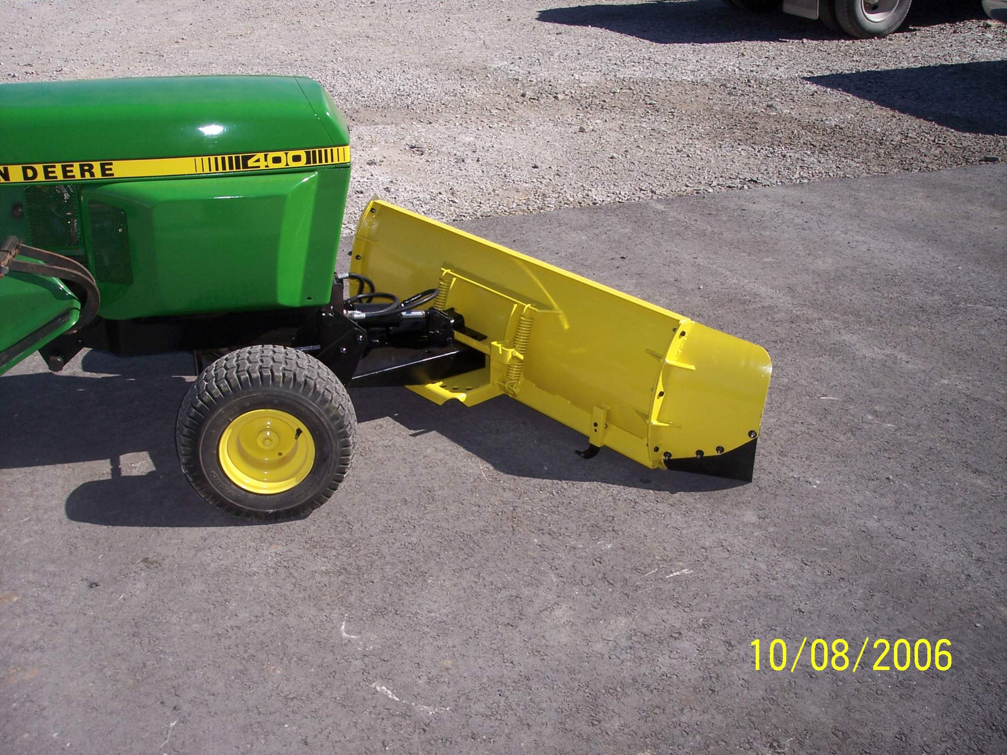

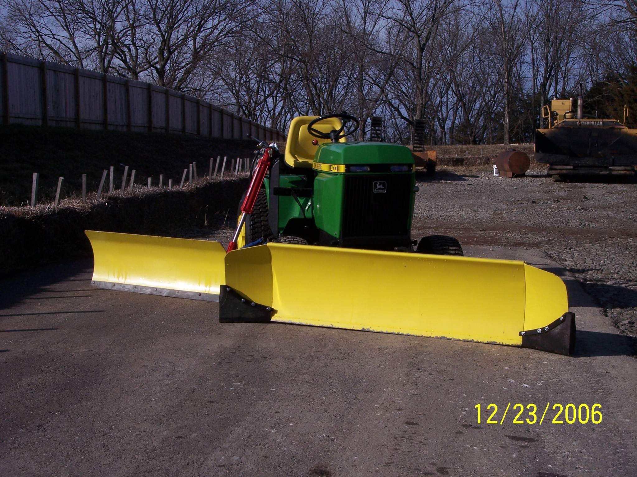

Here's my very first set of wings that I fab'd up.

Nice looking wing setup.
Light fluffy snow looks like it will darn good,but the heavy wet???

I agree totally. I had thought about that as well. But, you can't get very close to a building to back drag because the wings stick forward too far. Otherwise I would just make another set of fixed wings.
Depending on the accumulation, I do just fine. The 14" light fluffy snow was even too much to use the box plow on. I had such a mountain in 20 ft. that I would run out of traction. So I had to stick to the angle blade. But 6" or less regardless of wet or fluffy, I can push the length of a football field pretty easy.
