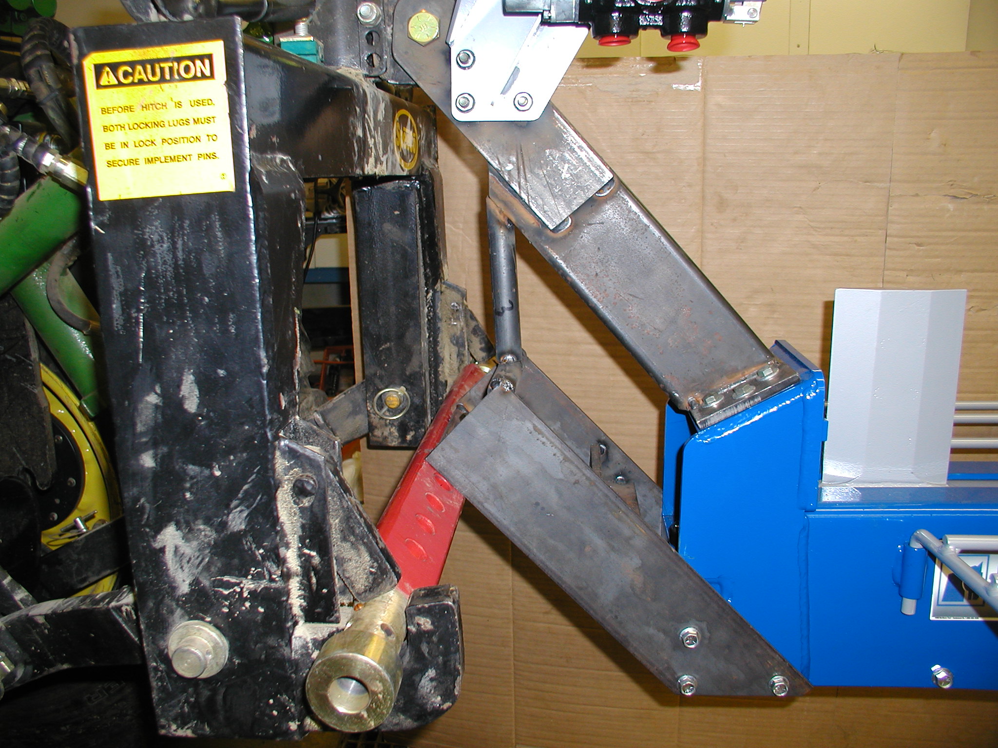

I started looking at the included 3-point frame stuff and doing some measurements and stuff. I wanted it to be quick hitch compatible, and to use it at two heights above the ground: zero (to allow rolling big logs onto it with the help of a small shallow ramp), and about 30 inches (measuring the height of the working surface of the splitter). The included 3-pt frame was not quick hitch compatible due to the upper mount details, and did not allow lowering it to the ground, in fact it would be about a foot off the ground with my tractor, and then it would raise to almost four feet max. So I began fabricating my own 3-point frame for it, to lower it a foot, and to extend it back away from the tractor a foot, and quick hitch-able of course. Pretty much finished that Sat night. Started thinking about operator position then, and realized that the postion they provided for the valve mounting was going to force me to bend way over to operate it when I am using it setting on the ground. And, it kind of bugged me that the recommended mounting position was way out the back, making it vulnerable to damage from possibly backing into something when its on the back of the tractor, and forcing 9 foot hose lengths from the tractor. So I decided to mount it to the side of the new upper link. This raises it about 15 inches, so its at a good compromise height for both the zero and 30 inch working positions. Also, this makes the hose routing much simpler and shorter. I am going to be able to use the two hoses they provided, and get two more made to complete the hookup (they don't provide the two tractor hoses). I should be able to get far enough tonight to prime the metal parts, then I will get some pics to post. I should be splitting by Friday. Pics soon, operating report next week.

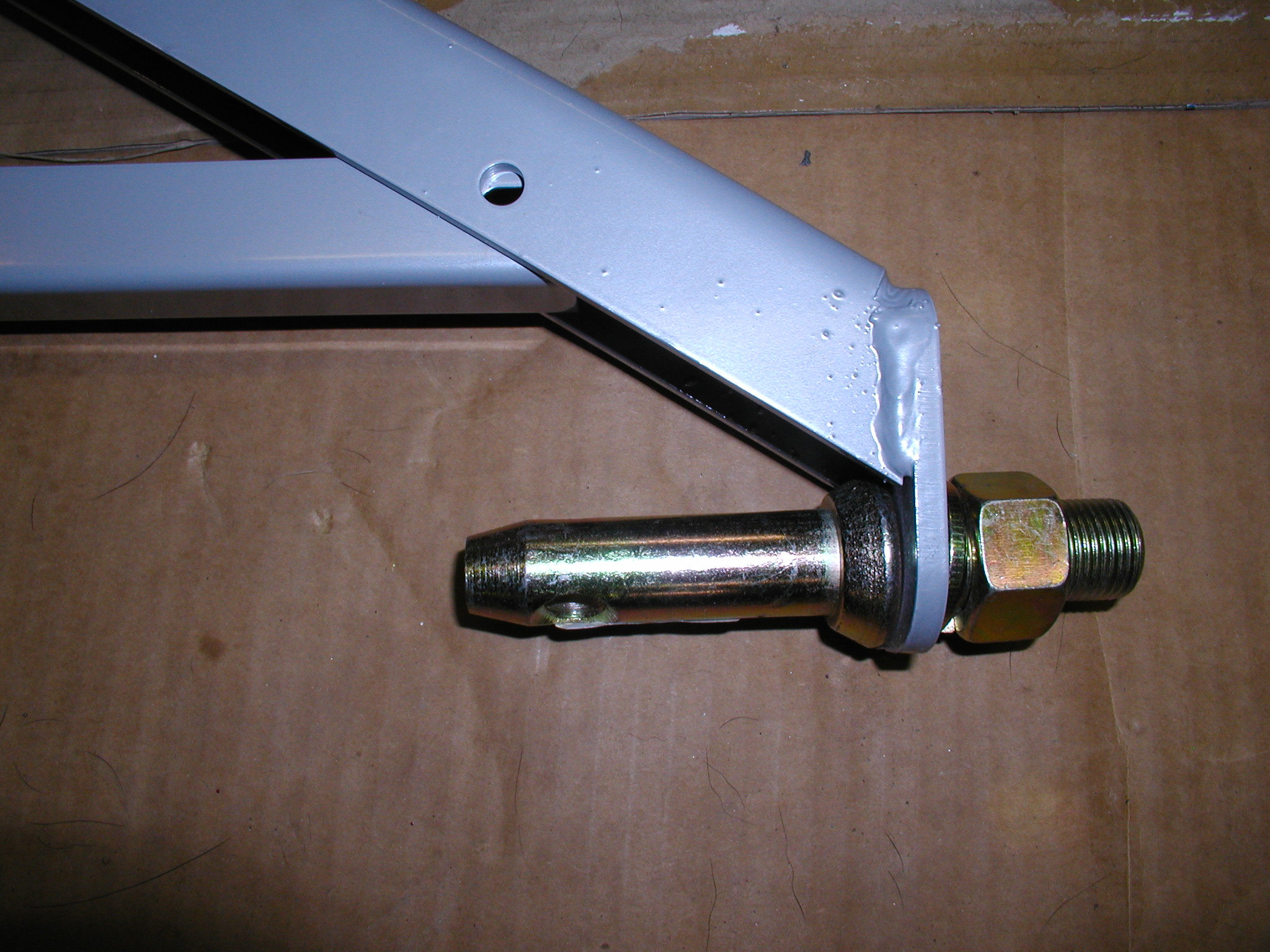

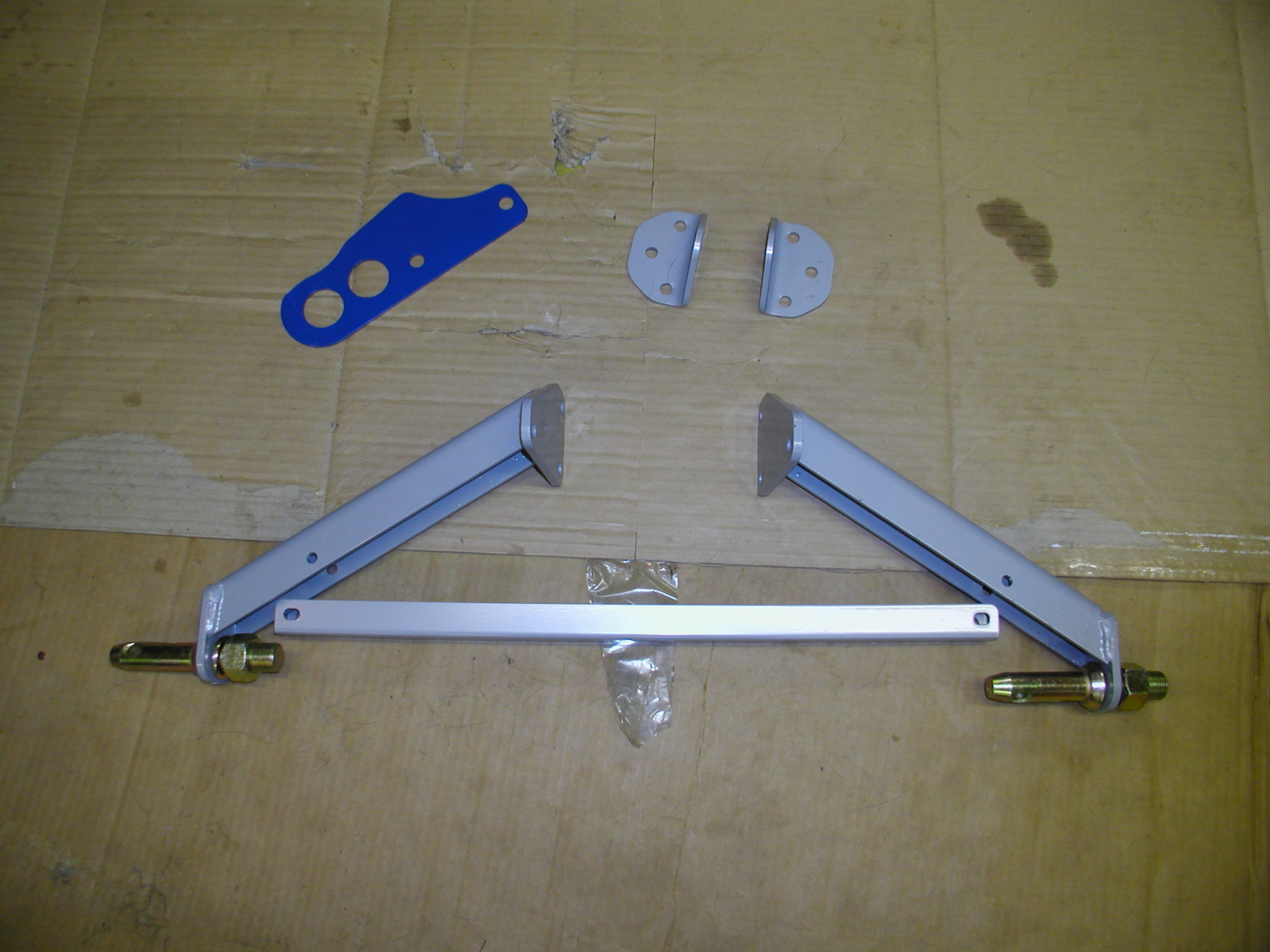

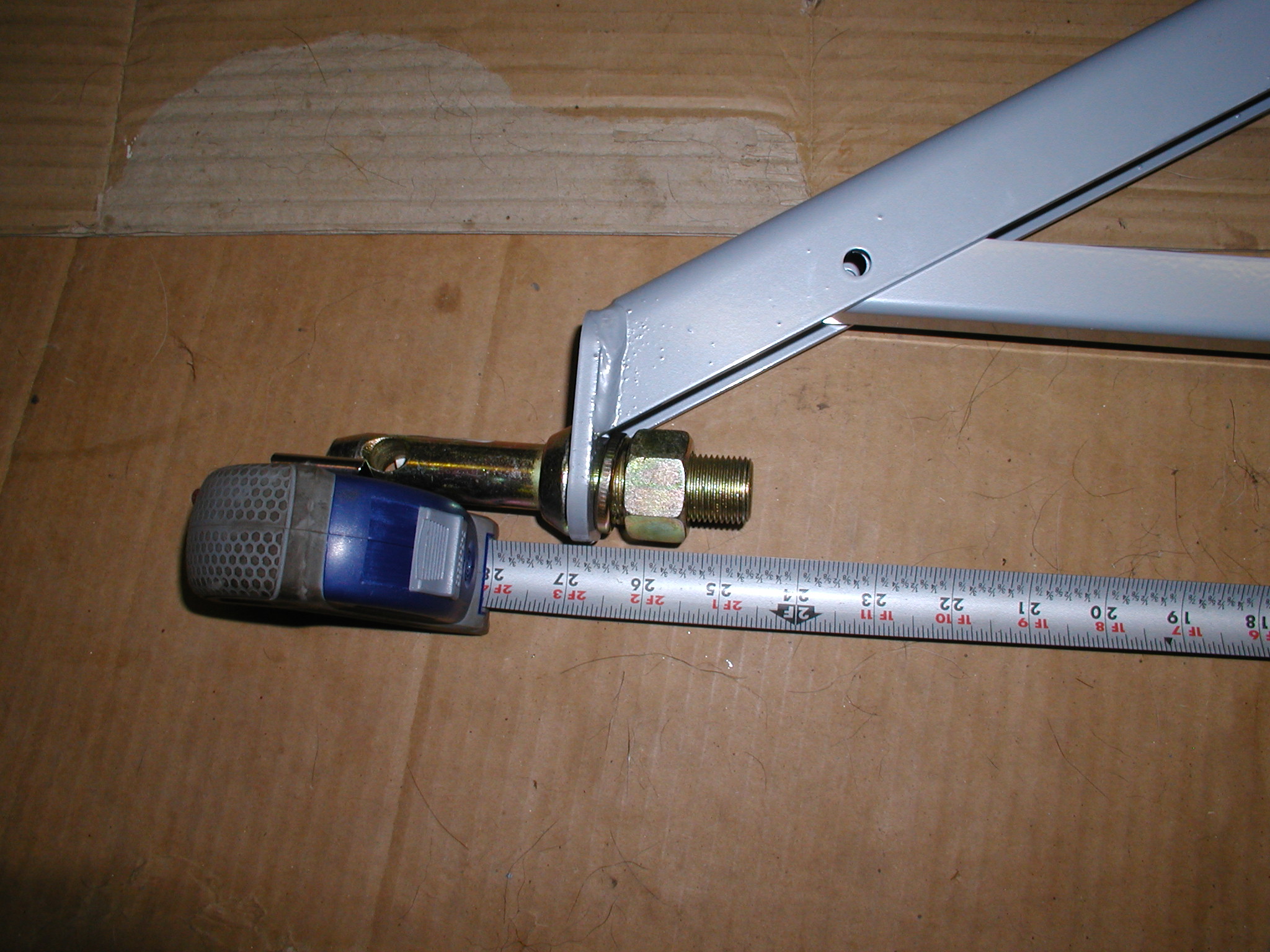

Finally, photo upload seems to work again. From these pics, I think you can see it would be difficult to attach to the 3-point if you flipped the pins to the inside of the brackets.
This is all the stuff I didn't need to use.

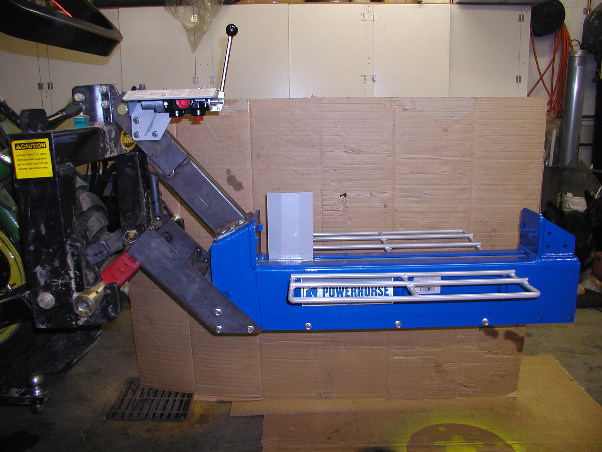

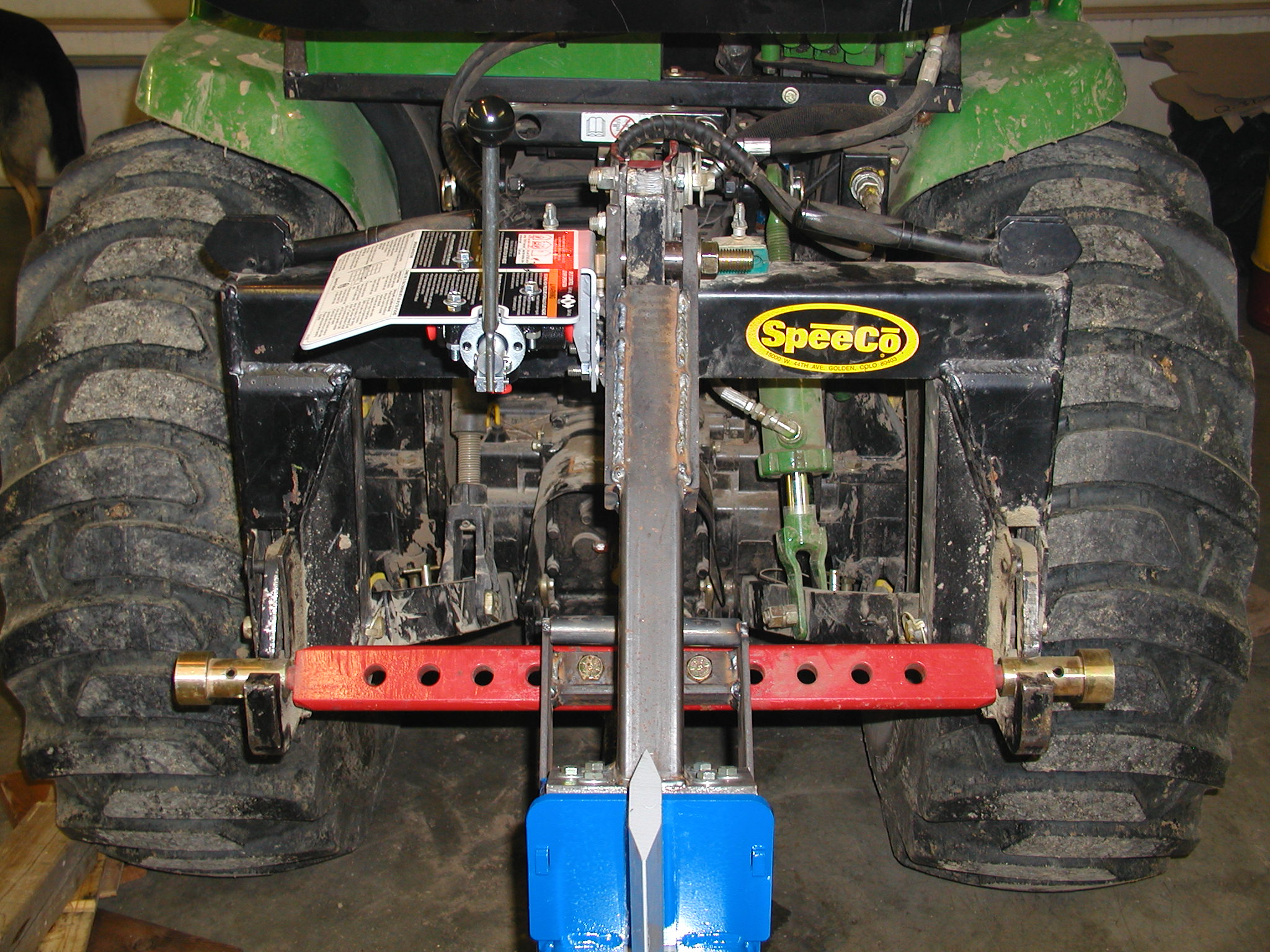

Here is the tack-welded bracket I fab'ed to mount the splitter lower by about a foot, back from the tractor about a foot, and allow quick-hitching. First pic shows splitter raised to top, producing a working surface about 29 inches off the ground.
