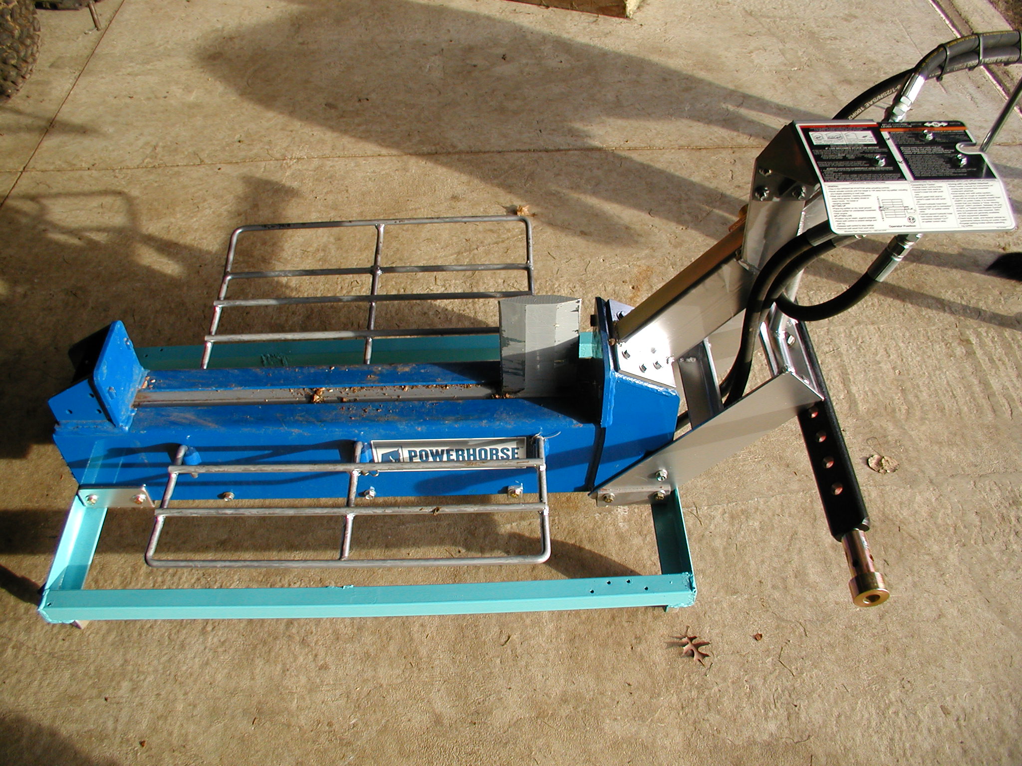

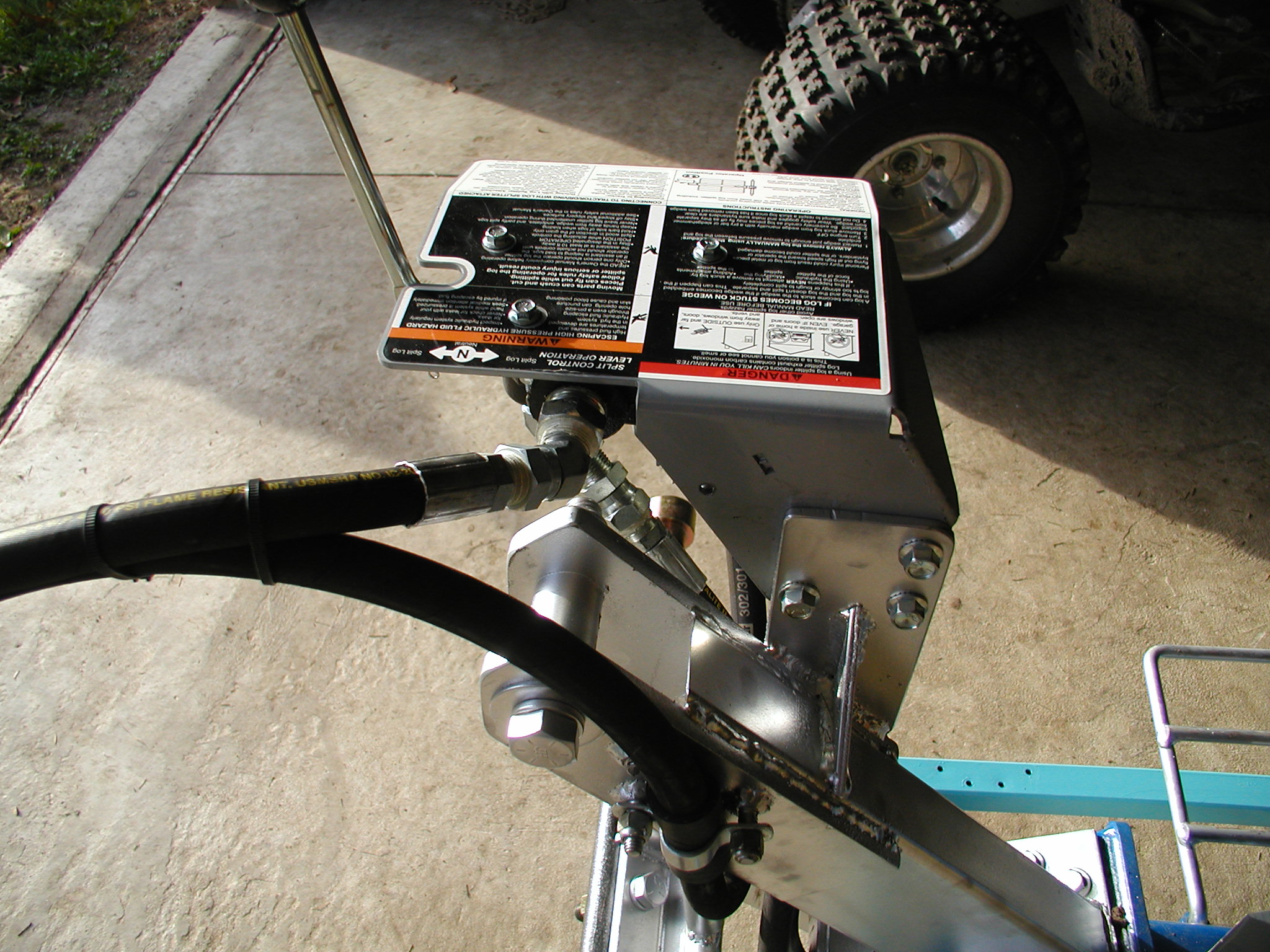

   / Powerhouse 3pt splitter #33
I found some more pics. First one shows new larger work table, control valve now moved to right side and facing forward toward tractor. Second pic shows another view of same thing, and its setting on its new skateboard for shed storage. Third pic shows closeup of valve mounting and a bit of the plumbing.
I think this is the ultimate configuration now. It does everything I set out to accomplish:
- variable work heights from ground to 30 inches high
- convenient control position now on rt side of tractor near 3-pt control lever
- powerfull enough for whatever
- fast enough even with tractor hydraulics, helped greatly by the bi-directional action
- work tables reduce bending over

   / Powerhouse 3pt splitter #34
jimgerken...great job (and idea) moving the control valve to the right side
I have this unit and have bent the metal 'blocker' to the control valve
