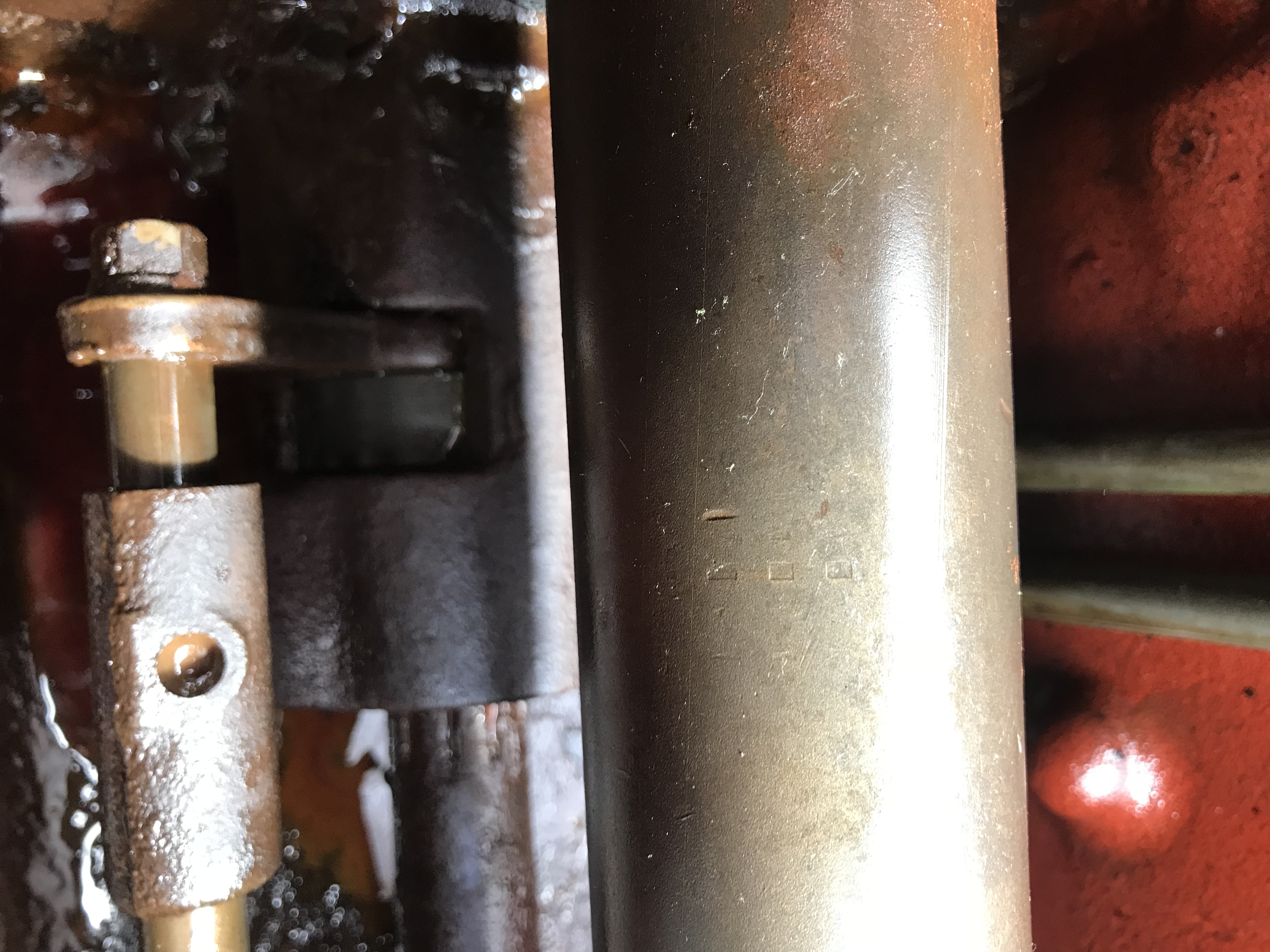

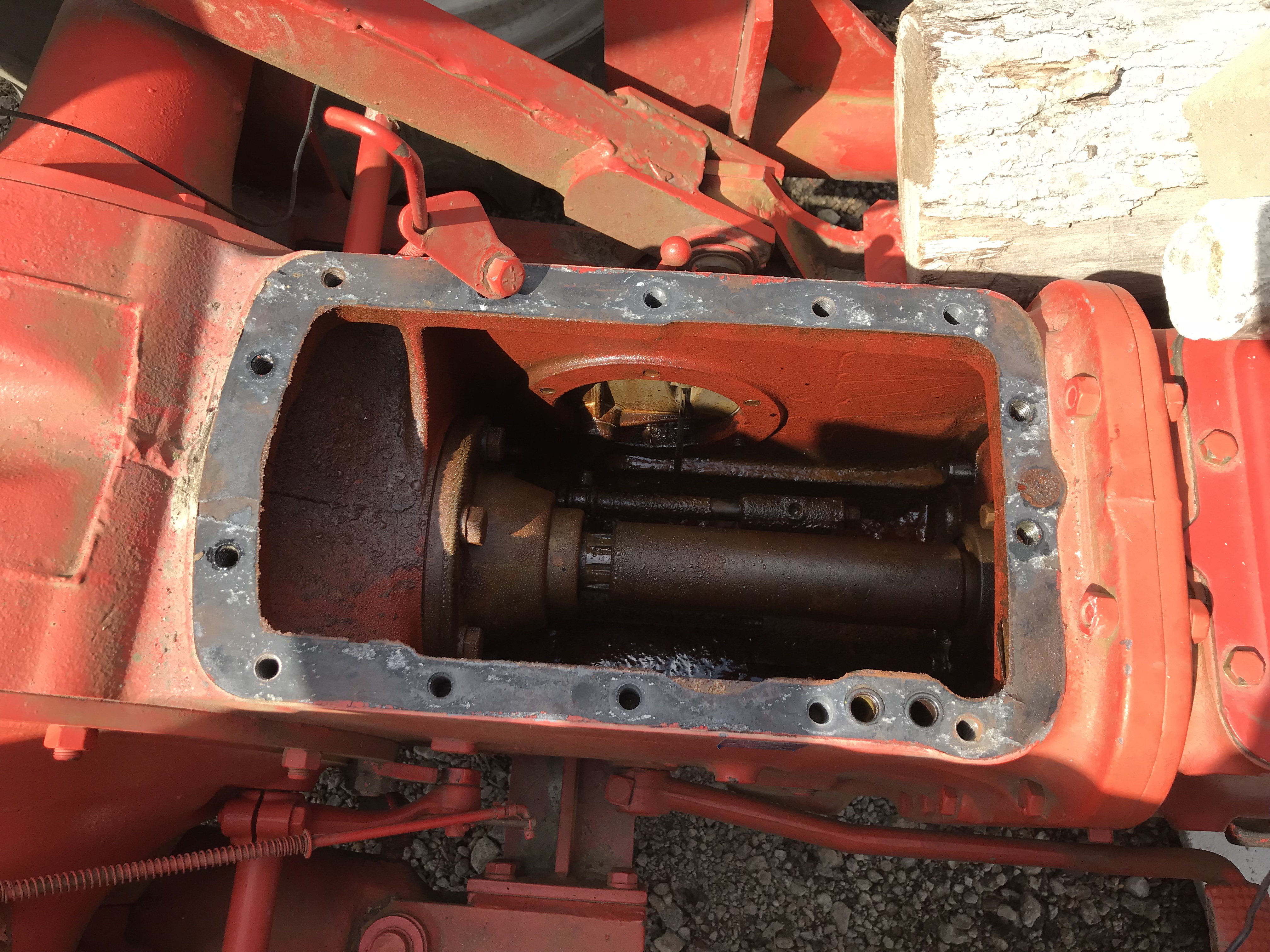

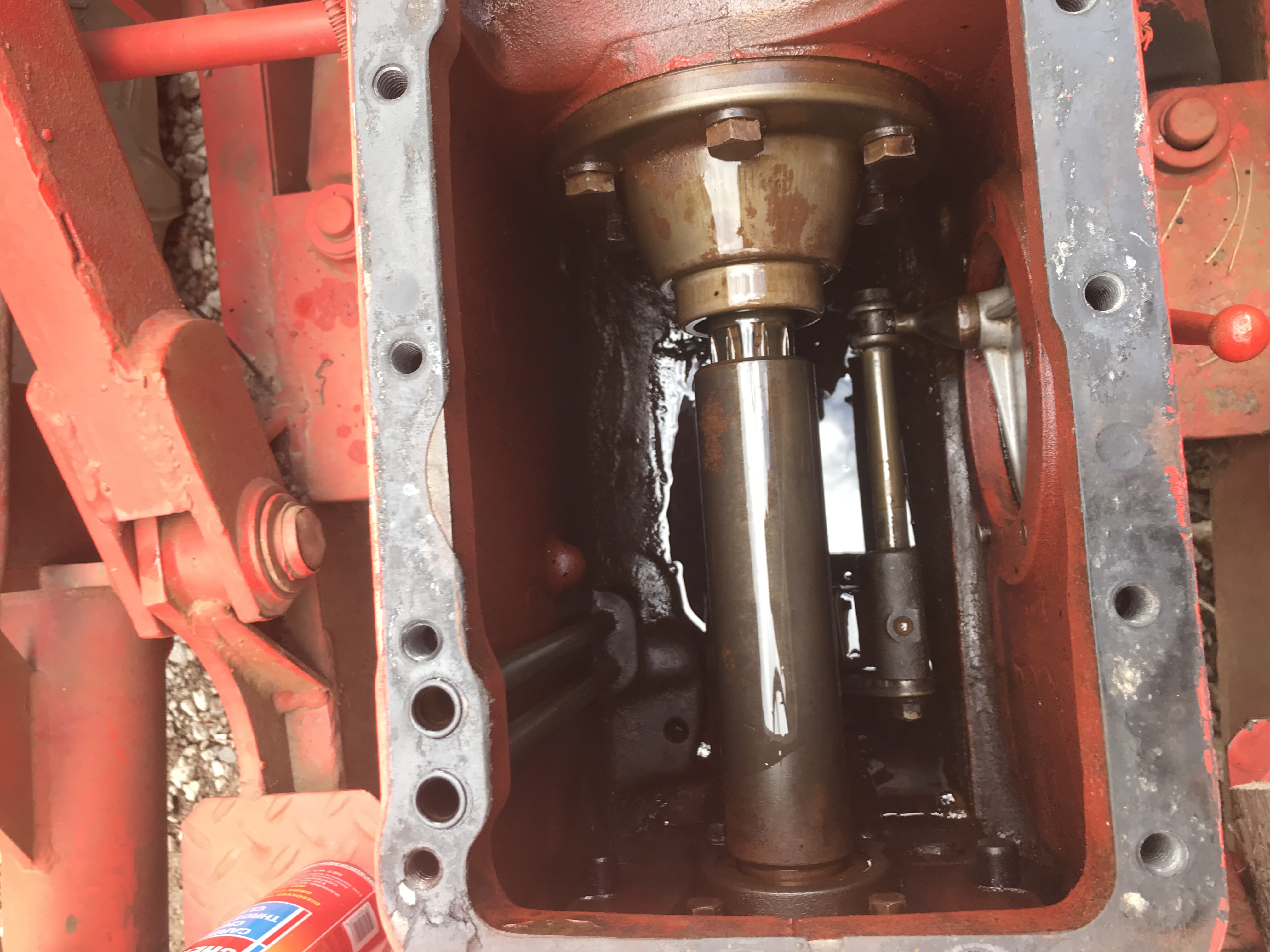

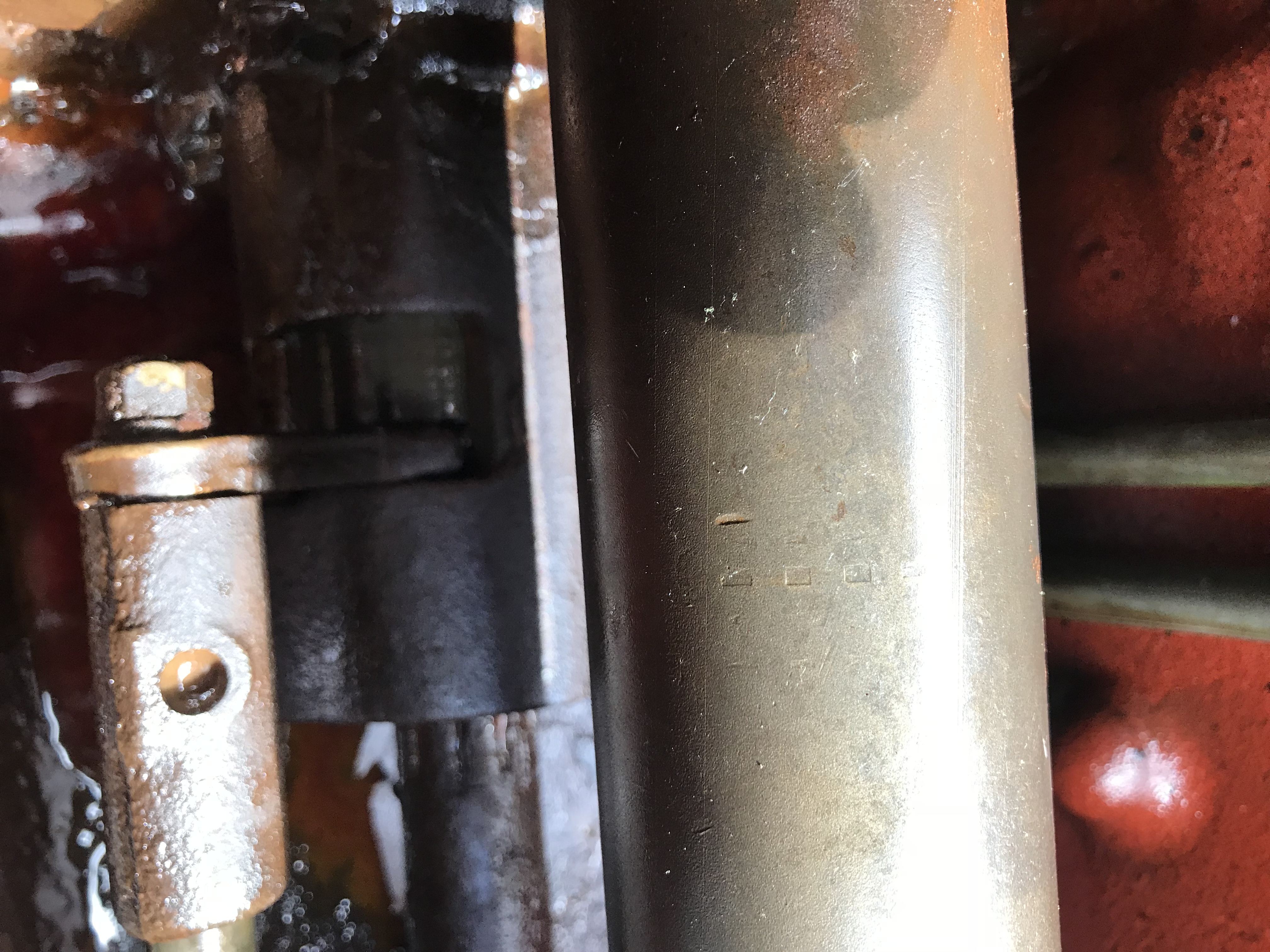

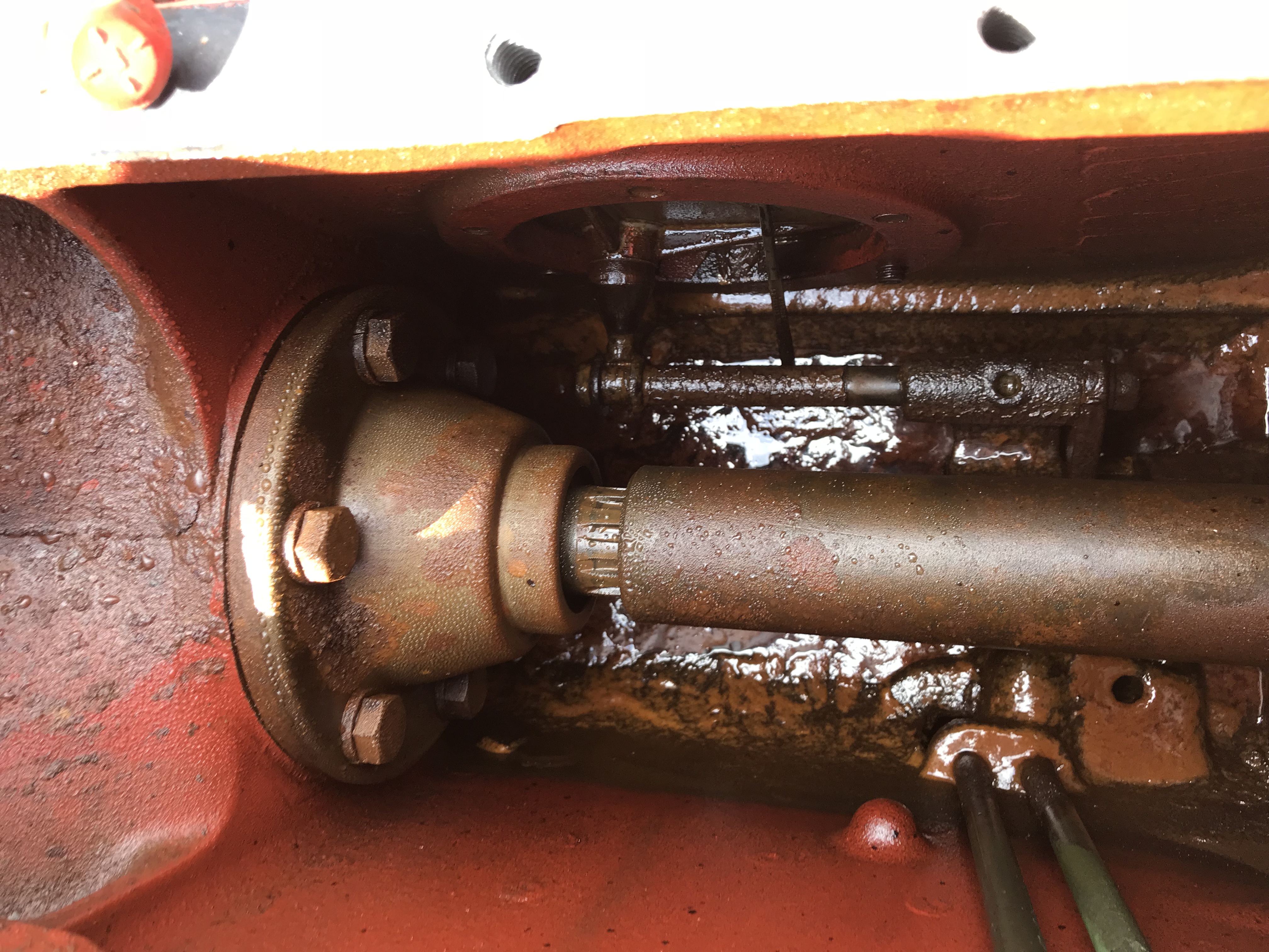

I took the cover off to see what was in there. 2 shafts one for rear end and one for pto pump that the backhoe is running off of I take it. I cleaned it up a bit. There are 2 holes and these holes lead to where my leak is where that cover plate is. The family farm and tsc didn’t have the rings I needed so I’ll go to the new holland dealer. My cover plate is bent and I don’t know if it’s supposed to be so I want to bring that into them too. There was a lot of condensation so I plan on filling the compartment agin once I replace orings

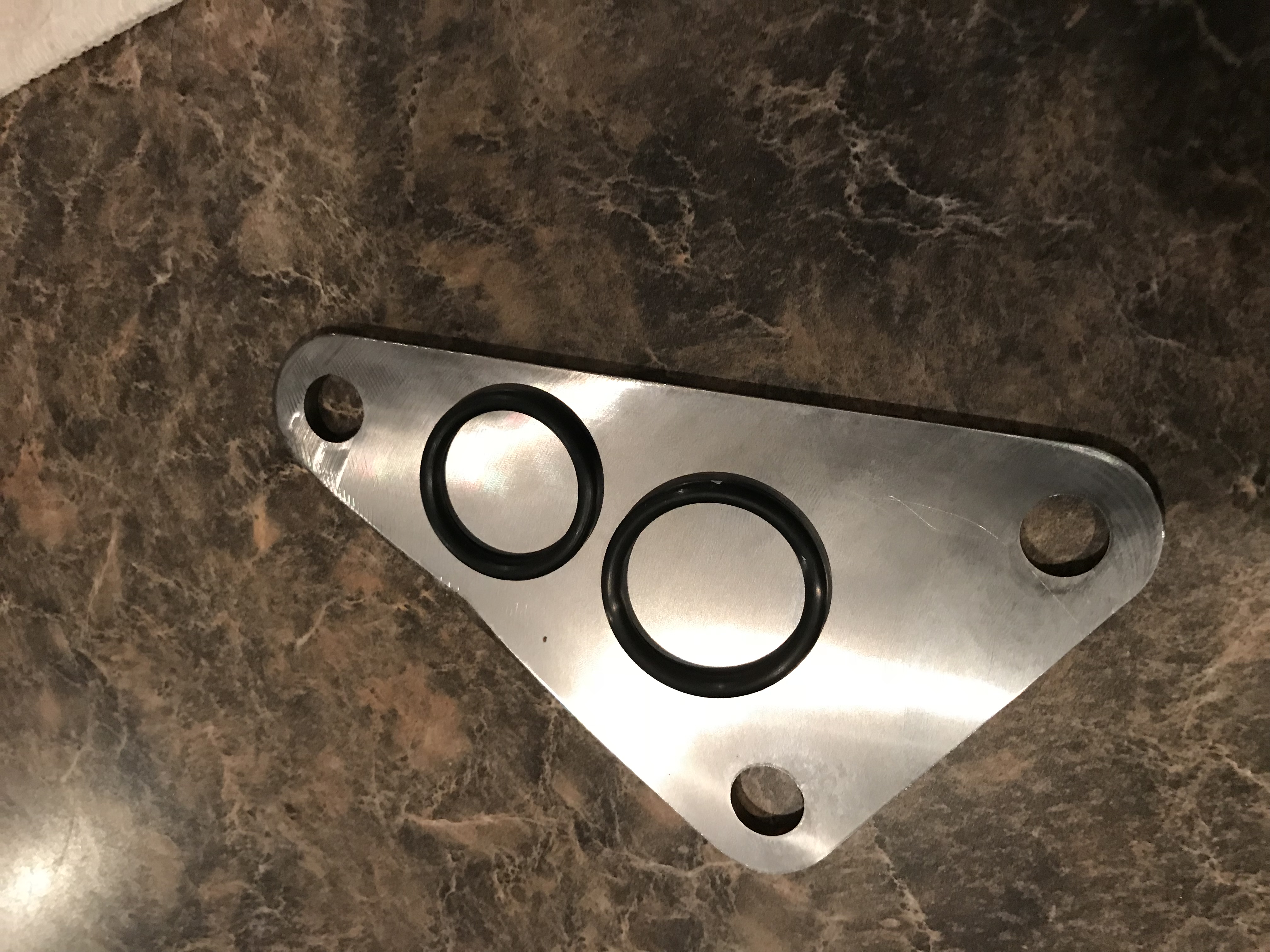

#35
Got the o-rings $1.67 and flattened and cleaned up the cover plate.
   / Powermaster 821 leaking #36
Any leaks?
Good idea to add gear oil to the gear train compartment - The PTO shifter will appreciate the lube.
   / Powermaster 821 leaking #37
for sure. even on the machines with hyds delete, oil in the sump is good. and if a pto is present, it is needed for seal life between compartments.
