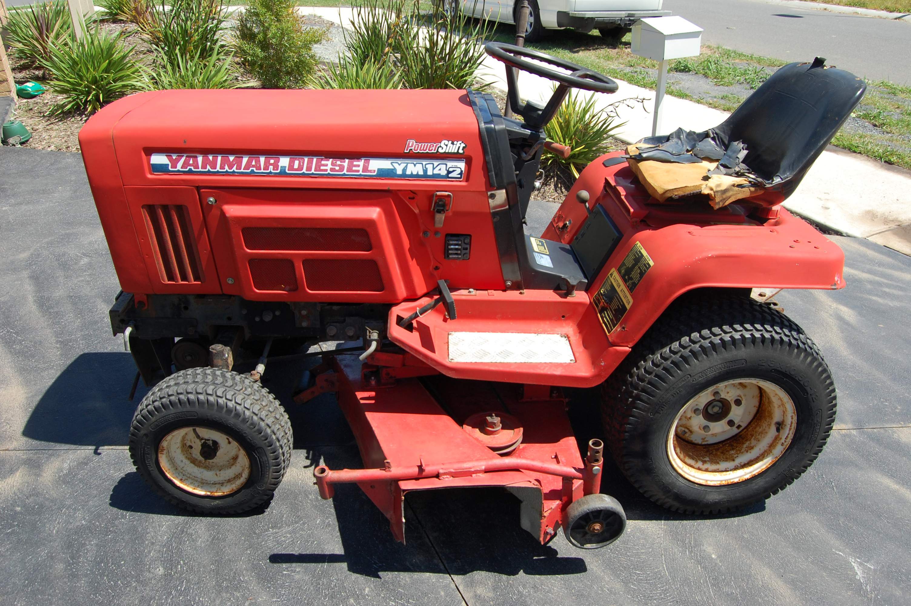

I have a YM122 (like the YM146, but 1cyl) that I'm working to resurrect. It is running very well but the Powershift system seems off. From what I read I should be able to select a range between my legs, then use the column shift to go between R, N, 1 and 2 without using the clutch. When I try that the gears grind - so I don't try it :) If I use the clutch it shifts fine and has lots of power. I changed the transmission fluid (using the JD spec fluid). Where do I start? Is the mechanism that controls the shifts located inside the transmission? I haven't found anything on the linkage.

Sure, what would you like pictures of? Here is the shifter/sticker:
Here is the front of the transmission:
Here is the back of the transmission:
And here is the whole unit:

On the column shift it does have 2-1-N-R, but according to the parts manual both the Powershift and the gear-shift have the same shift pattern up there.
I found three things of note in the parts manual:
1) The YM14 shows POWERSHIFT stickers and the YM12 does not.
2) The Powershift transmission has a plug on the right side case near the back on the top. Appears to angle back about 45*
3) The Powershift transmission has a shift cable, and the gear-shift transmission has a solid shift linkage.
I know I don't have the Powershift stickers, but tomorrow when I have time I'll look for the plug as well as look at the shift linkage.

I'm satisfied that this isn't a powershift. It has a mechanical linkage and it doesn't have the fill plug on the top corner of the transmission case.
